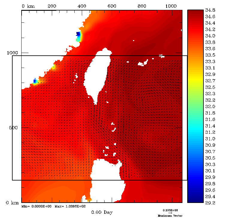

Dear ROMS users,

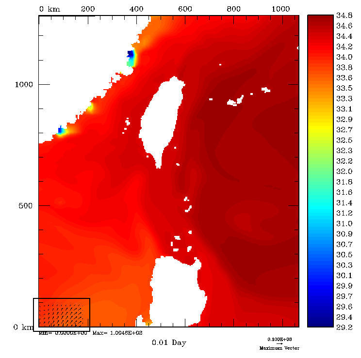

I got some weird results while using the visualization tools described in WikiROMS. The attached figures were salinity with velocity vectors as overlay field and were plotted through ROMS plotting package ccnt. In the 1st figure, the overlaid velocity vectors were only seen within the black box and, in my expectations, they should fill the whole domain as the salinity field did. An even worse situation occurred that the overlaid field shrunk to a smaller area located in the left-bottom corner as shown in the 2nd figure (all the resulted plots, except the 1st one, got the same small overlaid area as the 2nd figure). How to modify the ccnt.in to get the correct results ? Any comments and suggestions would be appreciated. Parameters used in ccnt.in and the standard outputs are shown as follows.

I think you should set the 4 "0.0" to the real longitude or latitude, this may work.
0.0 0.0 : bottom and top map latitudes (south values are negative).
0.0 0.0 : left and right map longitudes (west values are negative).
