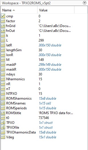

>> TPXO2ROMS_v5pt1
Not enough input arguments.
Error in TPXO2ROMS_v5pt1 (line 61)
ROMStitle=['ROMS TPXO data for ' datestr(t0,0)];
>> clear all
>> TPXO2ROMS_v5pt1_script
Reading TPXO data
Index exceeds the number of array elements (0).
Error in TPXO2ROMS_v5pt1>readTPXOdata (line 421)
TPXO.h.depth=ncread(TPXOfile.grid,'hz',[h.I(1) h.J(1)],[length(h.I) length(h.J)]); %bathymetry at z nodes
Error in TPXO2ROMS_v5pt1 (line 78)
TPXO=readTPXOdata(TPXOfile,lonR,latR);
Error in TPXO2ROMS_v5pt1_script (line 26)
TPXO2ROMS_v5pt1(t0,ROMSnames,fnGrid,fnOut,lengthSim)

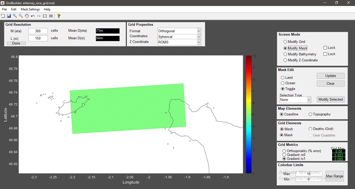

I am attaching my grid file in .mat format and .nc format both which I generated through GridBuilder tool as generously posted on Austides website
thanks a lot in advance.
-Neel

I believe that my TPXO9 files are the ones I got i.e. TPXO9-atlas-v4 netcdf isn't what the script was made to extract tidal forcing from. I believe the script was meant to work on TPXO9v1 netcdf. I tried your new script TPXO2ROMS_v5pt2.m script and TPXO2ROMS_v5pt1_script.m script with the following error
Error :
Thanks a lot again Mr. John Luick.
I hope of not running running into troubles again.
-Neel
Error :
I had got access to TPXO9-atlas-v4 netcdf. Therefore when I tried the new script as provided by you, it showed same error. Therefore, I have requested Dr. Erofeeva agin for TPXO9v1 netcdf files. Maybe that will work. I will keep you posted. Then I will try with TPXO9v1 netcdf files , the same script. Will let you know of errors.>> TPXO2ROMS_v5pt1_script
Reading TPXO data
Error in TPXO2ROMS_v5pt1_script (line 27)
-Neel

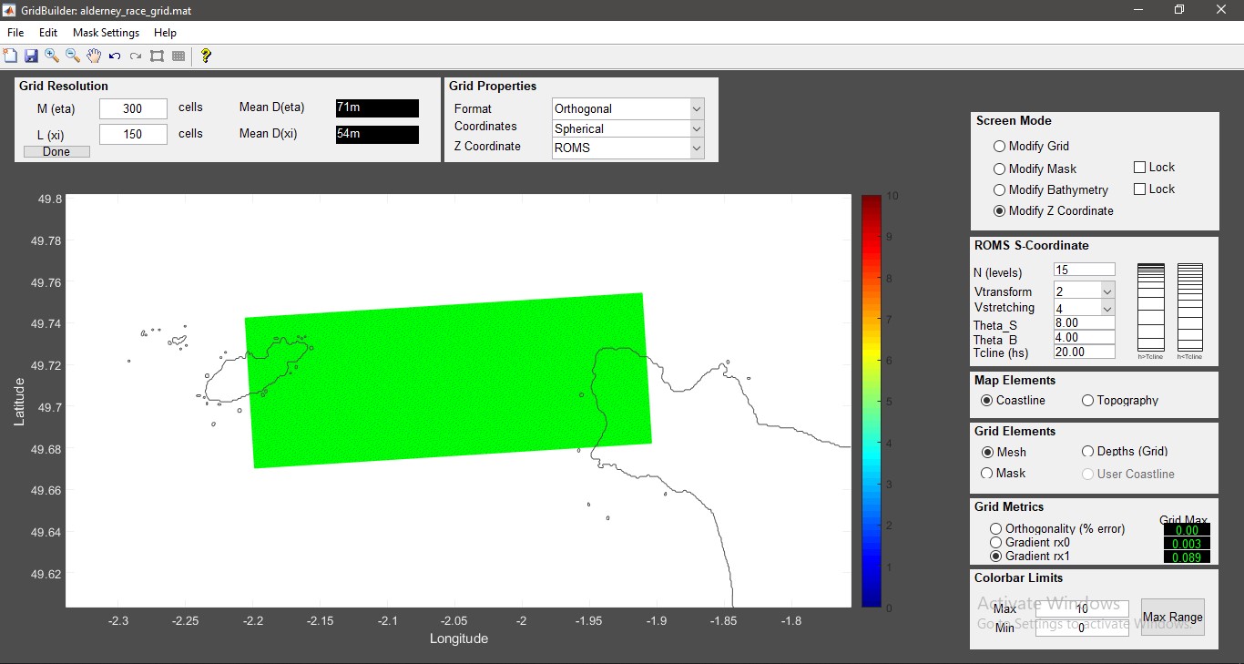

I have a ran into an error while running my grid file which I made using GridBuilder .exe tool version 0.99.5
First and foremost a very very hearty gratitude for all your help and efforts. The script sent by you gentle humans got the grid file which was sent for test by Mr. John Luick ' grd_Vizhinjam.nc' is up and running with outputs . I am attaching the script as a reference for future help seekers.
I'm not sure what's wrong with my own grid on which I want to work on is causing an error:
Thanks a lot in advance and extreme thanks for all the support you guys gave me all the time.
Regards
-Neel
Not sure what's the error in it . If you guys could help me out with the grid file as to what is causing this error and how to remove it, then it would be highly beneficial for me. Is it a problem with gridbuilder tool that the grid file has defects ?>> TPXO2ROMS_v5pt1_script

Re: TPXO to ROMS EXPRESS (tide extraction software)
Hi Neel
it is pretty obvious that you have chosen some parameter or set of parameters in GridBuilder which is causing the problem in TPXO2ROMS. The GridBuilder guru, Charles James, is on leave at the moment so probably won't be able to help you with that for a week or two. There is something strange about the fact that you have 300 cells in M, only 150 in L, the M axis is much shorter than the L axis, yet your cells are nearly square.
Meanwhile, I am attaching an Alderney grid that I created. TPXO2ROMS has no problem with it. I recommend you "Import" it into GridBuilder, edit the mask, export it, test it with TPXO2ROMS, modify a few parameters from the menu on the right hand side in strict accordance with the reference guide under "Help", then again test it with TPXO2ROMS, modify a few more parameters, repeat, etc. Don't change any of the defaults unless you have good reason to. This will get you going with some actual modelling.
All I did was set up the grid (choose boundaries) and set the minimum depth to +2 metres (my normal practice). I didn't touch the "Modify Z coordinate" or other things. I saw no point in putting the grid at an angle (as you did). (Actually I never have a grid at an angle unless absolutely necessary, which is almost never. KISS principle.) Oh yes, another thing I did which I consider to be of paramount importance, unless you want to go insane, is set the pivot corner to lower left hand (just drag the blue diamond down from whatever corner it is, to LLH).
In brief summary, I recommend you abandon the grid you created, and start over, without trying to get cute with the orthogonality and other options.
Good luck
John
Good luck
John

Here is my input lines in the TPXO2ROMS_v5pt2_script.m file:
After the I changed the code to the one you suggested I didnot get any specific output pertaining to the line disp([deblank(TPXO.harmonicNames(k,1:4)),' ',ROMSnames{nR}]) %New 11Feb2021. Instead I receive the error message as follows when I run the script:
Part of the code looks like this :
And all the values as seen from the workspace window looks like the attachment image.
What might be going wrong in that case ? I believe the script is working for you. I haven't really made any changes to it except for the time initialization which I needed according to my other files.
Kind regards
-Neel

> In TPXO2ROMS_v5pt2 (line 109)
In TPXO2ROMS_v5pt2_script (line 338)
Warning: Input should be a string, character array, or cell array of character arrays.
Index in position 1 is invalid. Array indices must be positive integers or logical values.
Error in TPXO2ROMS_v5pt2 (line 115)
ROMSharmonics(nR,:)=TPXOharmonicData(nT,:);
Error in TPXO2ROMS_v5pt2_script (line 338)
TPXO2ROMS_v5pt2(t0,ROMSnames,fnGrid,fnOut,lengthSim)
Nharmonics=length(ROMSnames);
NTPXO=length(TPXO.harmonicNames);
ROMSperiods=zeros(1,Nharmonics);
ROMSharmonics=zeros(Nharmonics,8);
Vdeg=zeros(Nharmonics,1);
for nR=1:Nharmonics
nT=0;
for k=1:NTPXO
cmp=strcmp(deblank(TPXO.harmonicNames(k,1:4)),ROMSnames{nR});
if cmp
nT=k;
end
end
Kind regards
-Neel
Hi Neel!
It seems like the string comparison never finds a match. So I guess there is something wrong with the reading of the constituents from the file. In line 486 of TPXO2ROMS_v5pt2.m you can see that the harmonicNames are read from the variable "con" in the elevation file. Can you check if the file h_tpxo9.v4a.nc has the variable "con" in it?
Hi Neel,
Change that section of code to:
for nR=1:Nharmonics
disp(['nR = ', num2str(nR)])
nT=0;
for k=1:NTPXO
s1=deblank(TPXO.harmonicNames(k,1:4));
s2=ROMSnames{nR};
disp([s1,' ',s2])
cmp=strcmp(s1,s2);
if cmp
nT=k;
disp(['k = ',num2str(k)])
end
end
%ROMSharmonics.(ROMSnames{n})=TPXOharmonicData(nT,:);
ROMSperiods(nR)=360./TPXOharmonicData(nT,end);
Vdeg(nR)=Vphase(t0,ROMSharmonics(nR,:));
%Vdeg.(ROMSnames{n})=Vphase(t0,ROMSharmonics.(ROMSnames{n}));
end
It is the same but with a couple of new disp statements.
I suggest you also put a debug stop after that section to stop it from going further.

- neelbasak08
- Posts: 99
- Joined: Wed Dec 09, 2020 3:58 pm
- Location: Thapar Institute of Engineering and Technology, Patiala, PN, India
Dear Mr. John, I did what you had suggested me to do and received the following while running in debug mode :
And after this the script execution ended. This is the same error which I had earlier posted.>> TPXO2ROMS_v5pt2_script
2n2 MM
> In TPXO2ROMS_v5pt2 (line 110)
s1 MM
Error in TPXO2ROMS_v5pt2 (line 119)

Thanks Cate for your advice. I checked my h_tpxo9.v4a.nc file in matlab using ncdisp command and it seems fine. Here's a portion of the output :c.drinkorn wrote: Thu Feb 11, 2021 9:20 am Hi Neel!
To John Luick: The function uses nc_varget here which is not a native Matlab function. Is there a reason why?
Cate
It had a bunch of other variables as well but I didn't post it here.file='h_tpxo9.v4a.nc'
Cate is right (thank you, Cate!). The line at or near 486 in TPXO2ROMS_v5pt2.m, which currently reads
harmonicNames=upper(nc_varget(TPXOfile.elev,'con'));
must be changed to two lines:
harmonicNames=upper(ncread(TPXOfile.elev,'con'));
harmonicNames=permute(harmonicNames,[2,1]);
I will put a new v5pt3 online asap with this change.

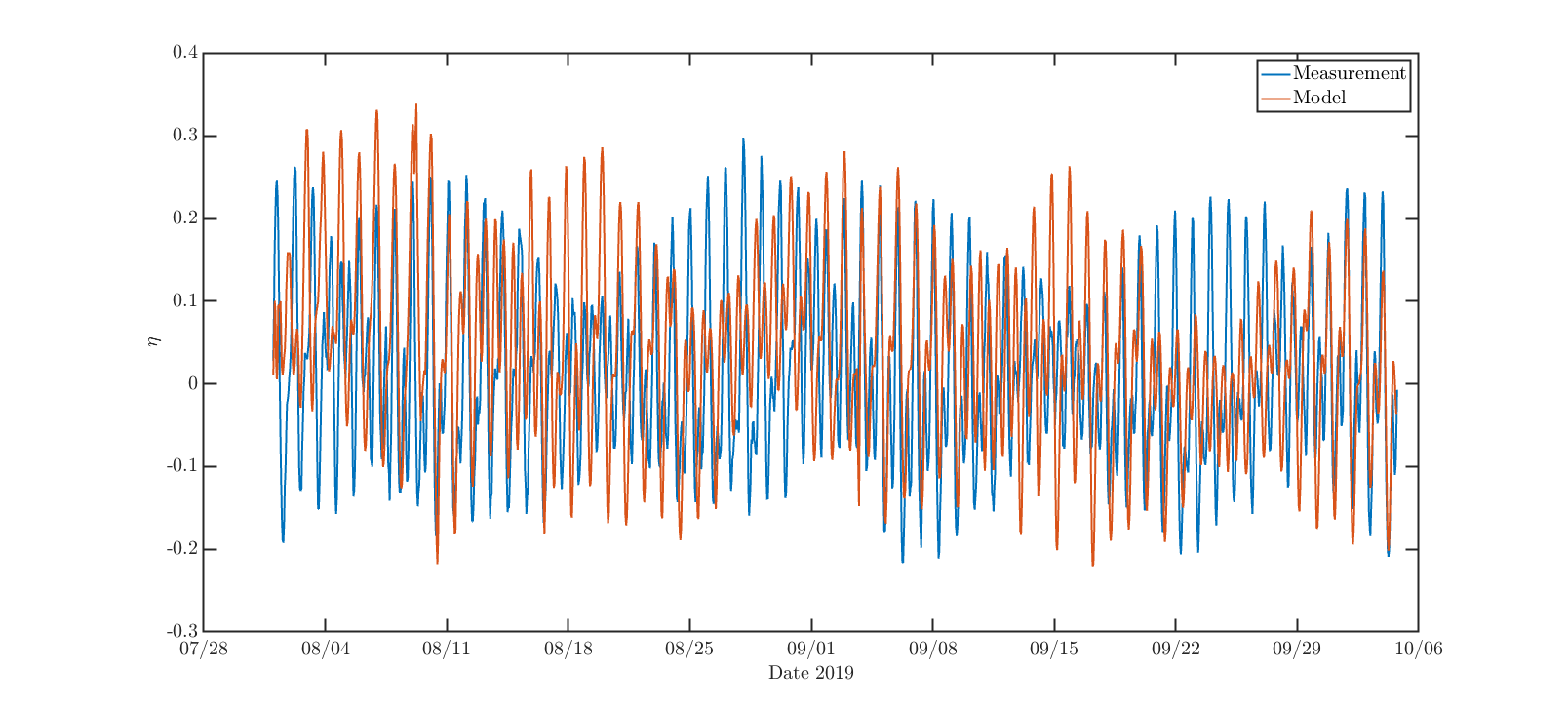

When I compare the TPXO extraction to constituents output from UTide (as applied on the Limon tide gage), there's agreement in the tidal amplitude, but differences in the phase lag for the most important constituents. When I apply UTide in this manner, the hourly time series start on 1 Aug 2019 and lasts for 365 days. Applying UTide to the ROMS output (hourly from 01 Aug 2019 until 4 Oct 2019) shows reasonable agreement in the amplitude for 2 of the top 4 constituents, but notably doesn't find P1 as a relevant constituent and badly misses the phasing of the M2 and O1 tides in the opposite direction of TPXO. I'm implementing tides in ROMS using all of the following options:

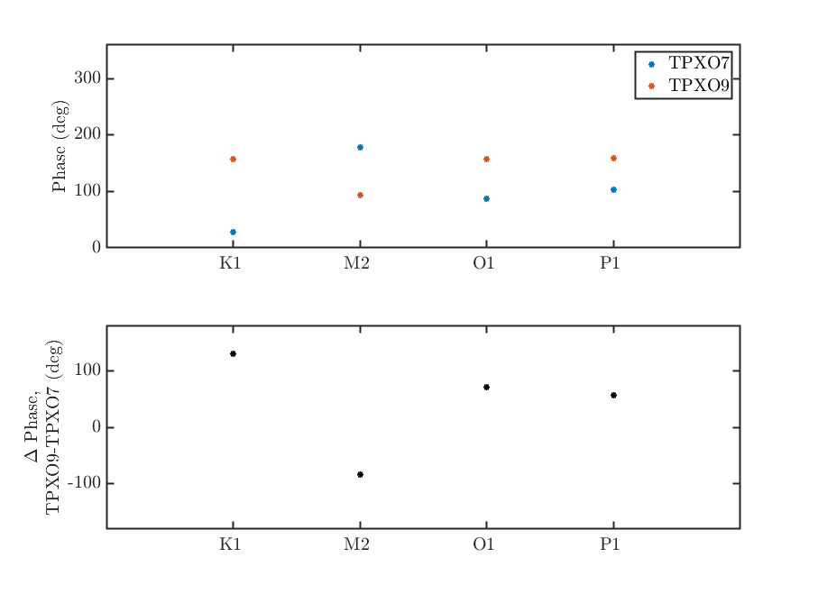

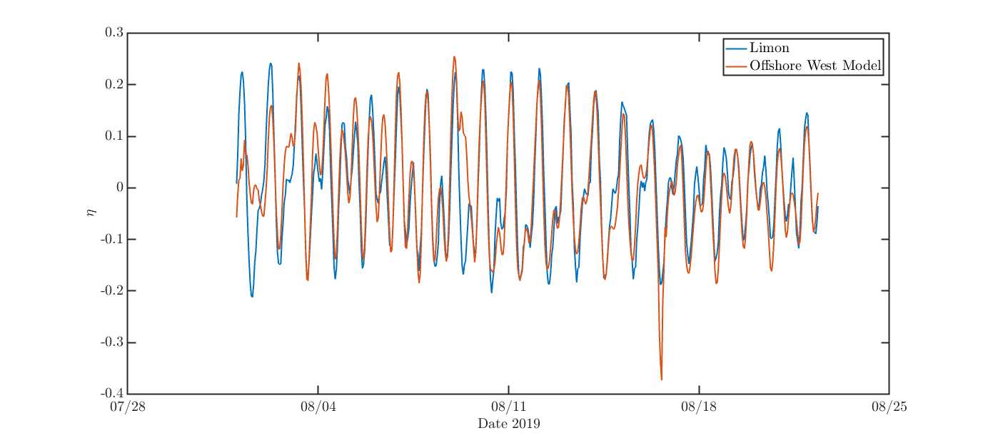

Hi John, John, and Kevin,
Thanks for your help. I have done what John Wilkin suggesting; setting DSTART and TIDE_START to 0 while making TIME_REF my desired start time (01 Aug 2019). The result using TPXO9 is below:

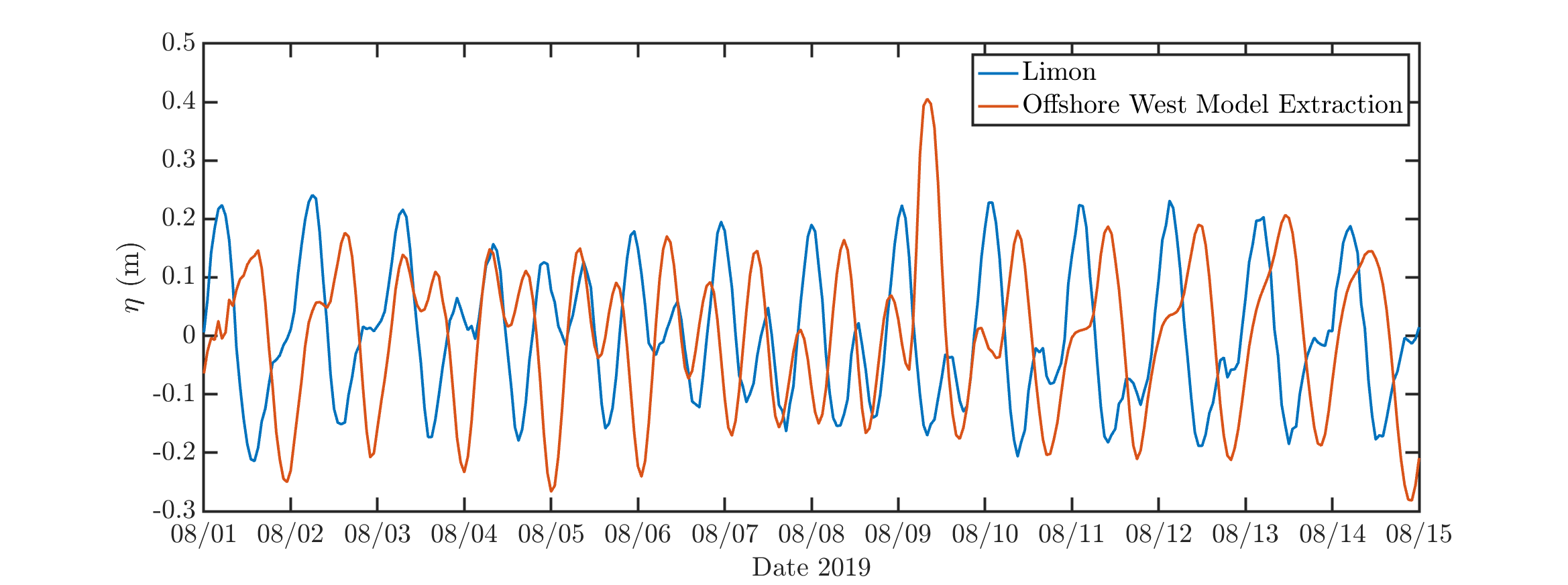

I extracted a location on the west side of the model domain, outside of the bay (82.5W, 9.7N). There's a significant phase discrepancy and a weird peak in the model. Aside from the peak, the tidal range looks ok.
I have had more luck using TPXO7, see below. A rogue minima, but looks better otherwise.
I'm attaching the Limon UHSLC data as a netcdf file to this post. John Luick, it would be great to have the code you mentioned--reconstructing the time series outside of ROMS seems like a logical next step.
Sam Kastner
Sam Kastner
- limon_uhslc.nc
- (161.58 KiB) Downloaded 5842 times

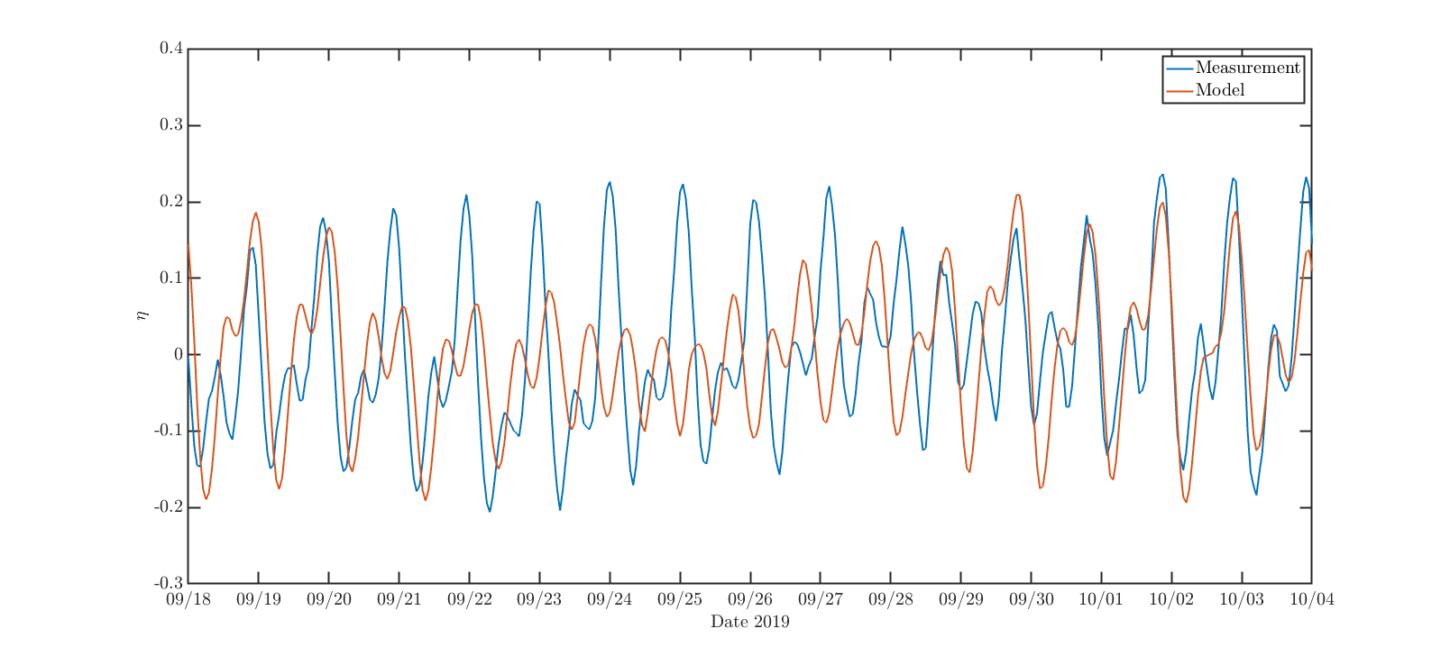

Just to be sure I understand what you are showing ...
The blue line is your data. The orange line is ROMS, and you have two cases where the tide harmonic boundary forcing is computed for TPXO7 and TPXO9 with the same Matlab code. Is this right?
Do the two orange lines overlay with a simple phase shift?
We wouldn't expact anything too radical in the TPXO7 and TPXO9 data. If you compare the ROMS boundary tides file harmonics, do you see very similar amplitudes but radically different phases? If phases are different, are they ALL different, or just some harmonics.

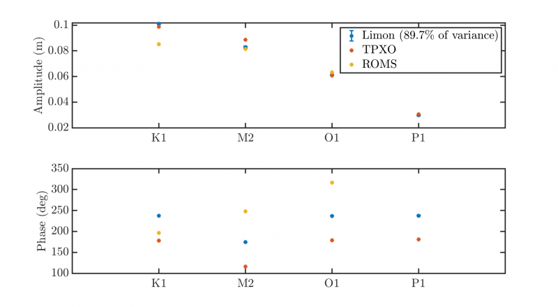

Yes, almost, except I'm using Eli Hunter's code for TPXO7 and John Luick's for TPXO9. Is this possibly the source of the mismatch--do the two codes handle time inputs differently? I've given them both the same date: August 1, 2019.
The lines do not overlap with a simple phase shift. I'm attaching a plot of the domain-wide mean phase for the top 4 tidal constituents (which comprise ~90% of variance in UTide analysis of the Limon gauge). There are significant differences between them. TPXO7 is shown in blue, TPXO9 in red, and the difference between them is shown in black on the bottom plot. Here's a similar plot to the top panel above, but showing amplitudes. These are more similar. I really appreciate the help.

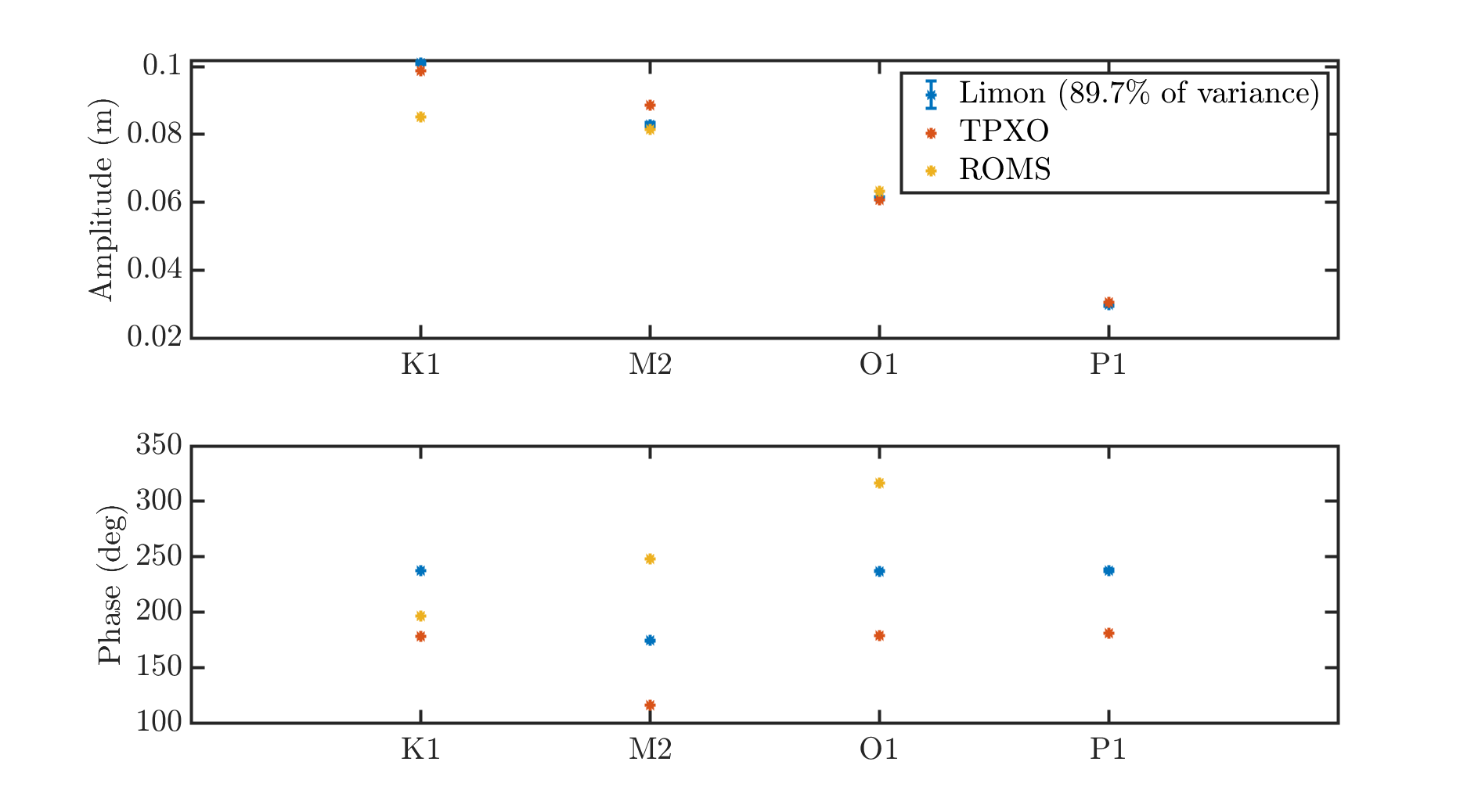

Oops, I wrote the below before noticing that you had already posted the plots of TPXO7 and TPXO9 harmonics. Well, maybe it will still be useful.

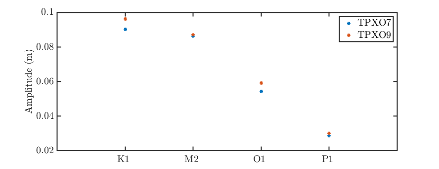

Sam, usually I find it more useful to compare harmonics rather than time series plots. I analysed the Limon water level data from UHSLC. Here are the main harmonics (name, amplitude, phase)...
Amplitude is in metres, and phase is in GMT to make it comparable to TPXO and ROMS phase.
Q1 0.012 224.351
O1 0.060 238.814
K1 0.102 239.774
N2 0.022 132.763
M2 0.085 178.156
S2 0.015 327.118
Extract the harmonics from the TPXO7 and TPXO9 data from a gridpoint near Limon, and see how they compare with the above.
The next step would be to analyse the ROMS output water levels from near Limon (good to have at least 30 or 40 days of hourly or more frequent model data, but even a week will do if it doesn't include the first day or two of model run, especially if it is a tides only run).
I decided not to post the Matlab functions because they could lead to confusion. I'm happy to help with the tide analysis if you post the data.
John L
Q1 0.012 224.351
O1 0.060 238.814
K1 0.102 239.774
N2 0.022 132.763
M2 0.085 178.156
S2 0.015 327.118
John L

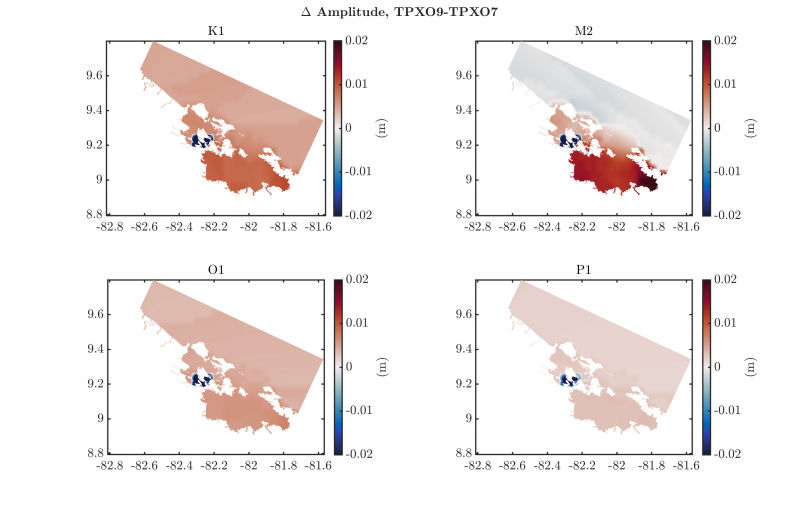

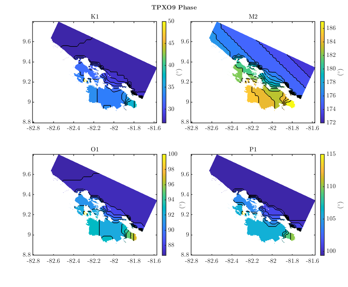

Since the domain-wide mean phase isn't very illuminating, I encourage you to plot a map of the phases, and differences, to check that the offset is more or less constant everyone. That would be a clear indication of a time base problem. Likewise, mapping the amplitudes should show very little spatial difference in TPXO7 and TPXO9, but mapping the difference will test whether there is some mix-up in the interpolation step.
Can you run both TPXO7 and TPXO9 with John Luick's code, or different versions of the code? Again, the results should be very similar.

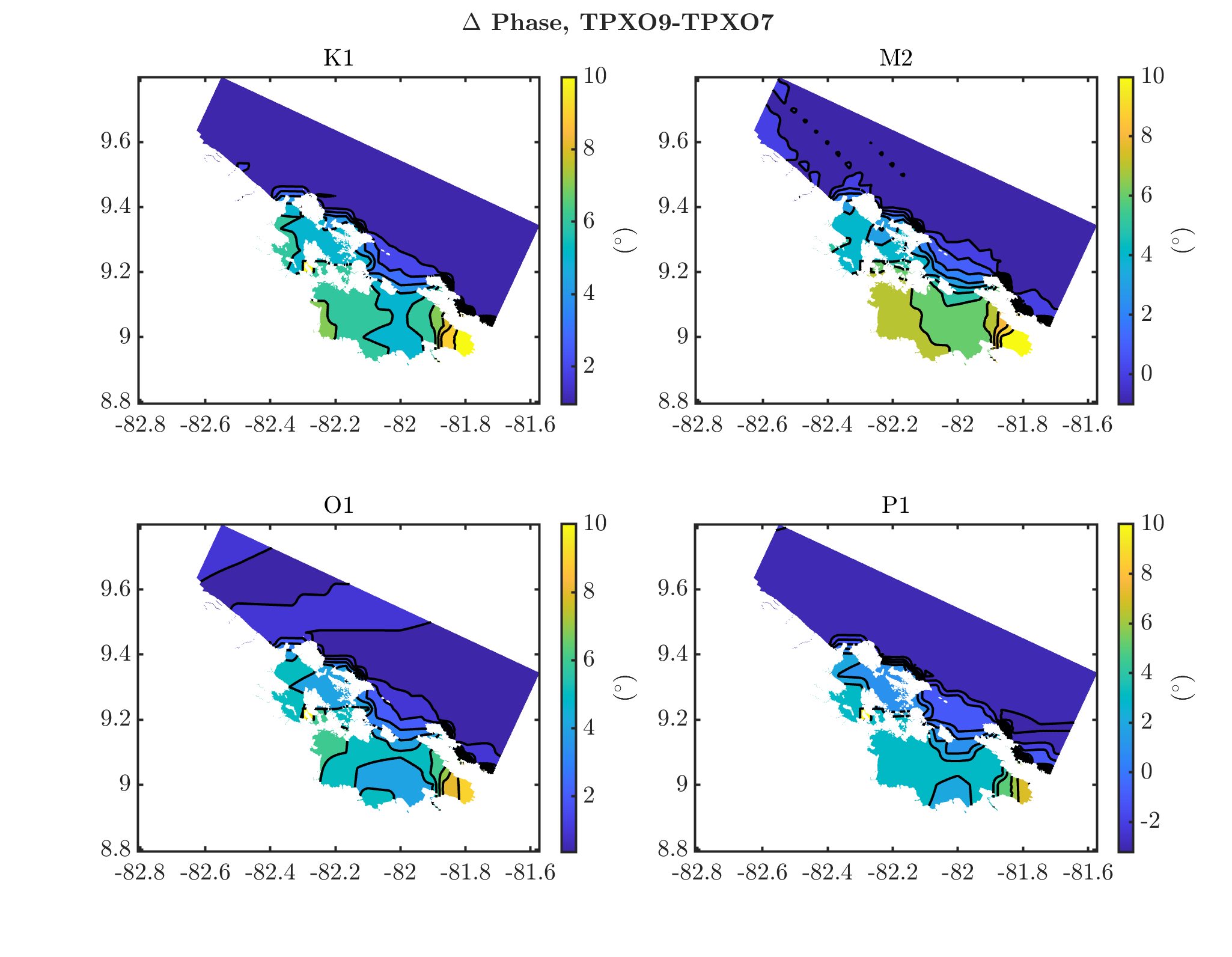

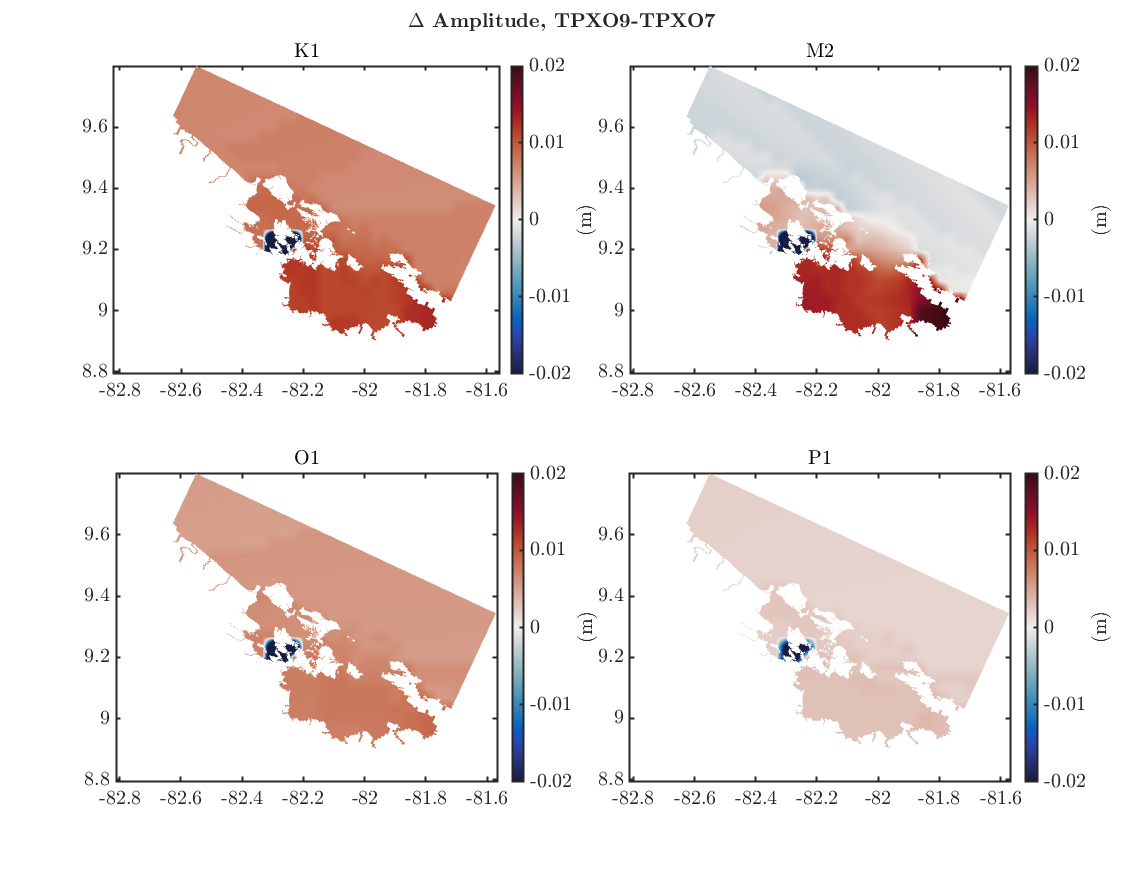

Thanks for helping me troubleshoot this. To respond in turn:
The harmonics I get from 33 days of ROMS output w/TPXO9 (evaluated using t_tide, starting the analysis on 4 Aug 2019, after the tidal ramp up period):
Same units (amp in m, phase in GMT):
Q1: 0.0137 235.98
O1: 0.0679 349.88
K1: 0.1028 6.37
N2: 0.0283 295.76
M2: 0.0815 88.70
S2: 0.0209 251.69
The harmonics I get from 90 days of ROMS output w/TPXO7 (same evaluation, this file was created with the Hunter code):
Q1: 0.0112 196.90
O1: 0.0553 210.11
K1: 0.0757 243.13
N2: 0.0242 90.20
M2: 0.0832 148.32
S2: 0.0220 316.33
The domain doesn't include Limon, but these are from a point ~60 km away from Limon that is also significantly away from the domain's western boundary.
As to the domain wide maps of amplitude and phase difference between TPXO9 and TPXO7 for the top constituents, here they are.
Phase: Amplitude: It seems like a more-or-less constant phase offset (at least relative to the difference between the models), with the M2 amplitude offset being somewhat spatially variable. There's also a weird interpolation issue in Bahía Almirante, but that won't matter, as it's not along the edge, correct? Or am I misunderstanding how ROMS implements tides?
I haven't run both TPXO7 and TPXO9 with the same code yet, they take different versions of the atlas, and I don't have the netcdf files for 7 or the all-encompassing binary file for 9.
Q1: 0.0137 235.98
O1: 0.0679 349.88
K1: 0.1028 6.37
N2: 0.0283 295.76
M2: 0.0815 88.70
S2: 0.0209 251.69
Q1: 0.0112 196.90
O1: 0.0553 210.11
K1: 0.0757 243.13
N2: 0.0242 90.20
M2: 0.0832 148.32
S2: 0.0220 316.33

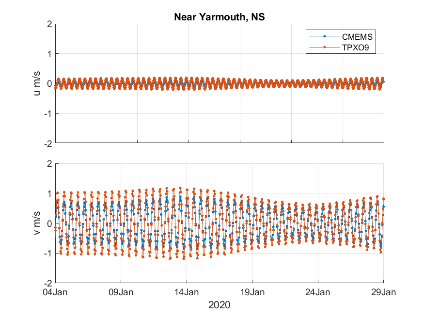

Again, I think John W is on the right track there. I do have a couple of peripheral suggestions. First, the ranges on your y axes on the phase plots are way too big, and adding phase contours at (say) five degree intervals is usually helpful as you can use them tell the direction of propagation. You should choose a range that shows five or ten contour lines. The software can pick the range (based on the mean, max, min of phase in the region).
I don't know how useful it will be to you, but I have attached a Matlab script I wrote one time to compare a time series from TPXO (OTPS) predictions with that of the CMEMS ocean model (https://marine.copernicus.eu/sites/defa ... -MODEL.pdf). I had planned to add ROMS and ADCP data to the plot, but never got to it. I used Bay of Fundy because it has strong tides. I personally only use ROMS as a last resort (sorry ROMS guys!), like for grid resolution less than five km. Much quicker (and probably more accurate) to skip the middle man (ie the nested boundary), and just download CMEMS, then if you need to scope in, you can use CMEMS as the boundary condition (one version even contains tides). Here is a line of code I used to download the Bay of Fundy data from CMEMS:
python -m motuclient --user jluick --pwd <placeholder> --motu http://nrt.cmems-du.eu/motu-web/Motu --service-id GLOBAL_ANALYSIS_FORECAST_PHY_001_024-TDS --product-id global-analysis-forecast-phy-001-024-hourly-merged-uv --date-min "2021-1-1 00:30:00" --date-max "2021-2-1 23:30:00" --depth-min 0.49 --depth-max 0.51 --longitude-min -67.5 --longitude-max -63.3 --latitude-min 44 --latitude-max 46 --variable utide --variable vtide --out-dir . --out-name ../DATA/Bay_of_Fundy_test.nc
Obviously you have to paste it into a Visual Studio terminal window or Anaconda or whatever. And change <placeholder> to your CMEMS password!
You could use that method as a quick check on your ROMS results. (You can use u0 and v0 instead of utide and vtide if you want tide-free data, but then you may prefer to go to one of their reanalysis datasets for nontidal, nonrecent, data).
tidalcurrents_CMEMS_TPXO_ROMS_ADCP.m

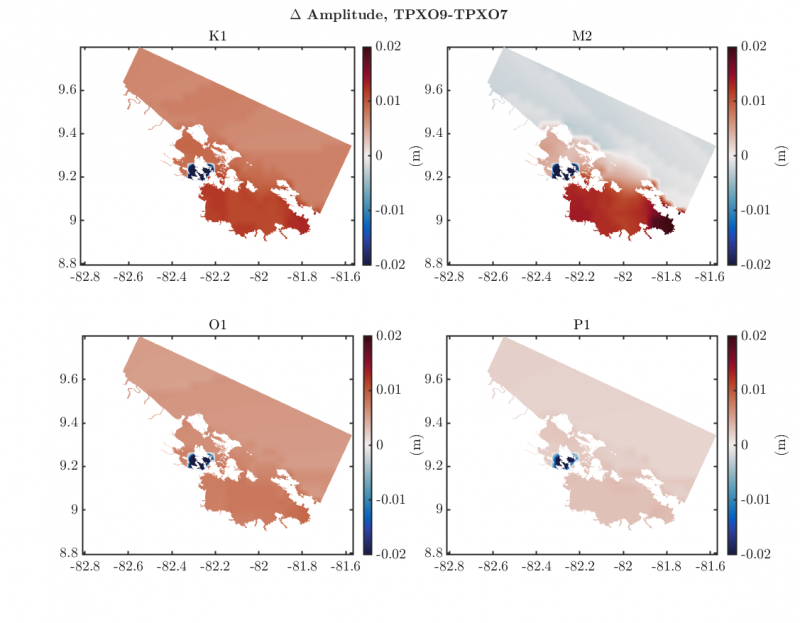

Hi John and John,
Thank you again for the advice. I've gone back and carefully checked the differences between Eli Hunter's TPXO7 code and John Luick's TPXO9 code, and the two do handle time slightly differently. If I understand correctly, John Luick's code, TPXO9v4_ROMS.m, uses the "t0" input given to it to make an equilibrium phase calculation (Vphase function call, line 104), and then uses the midpoint of the evaluation period (t0+ndays/2) to make a nodal correction calculation (TPXOnodalfactors call, line 108). Hunter's TPXO7 code, otpx2frc_v5.m, uses its input "base_date" to make the equilibrium phase calculation (t_vuf function call, line 115, though this isn't quite as well documented), while "pred_date" is used to make the nodal correction (t_vuf function call, line 116). So, to compare the files generated by the two codes 1:1, base_date should be the same as t0, while pred_date should be set to t0+ndays/2.
In the process of making sure I understood this, I think I stumbled upon an error in TPXO9vs_ROMS.m, John Luick. On lines 127-128, 132-133, and 137-138, shouldn't the indexing variable "n" instead be "k"? Assuming this is true, I have remade the plots from my previous post; namely, colorplots of the difference in phase and amplitude between the forcing file generated from John Luick's code used on TPXO9 and Hunter's code used on TPXO7. See below.
Amplitude: Phase (note that the color axes are not the same on all subplots): And here's just the phase of the TPXO9 file generated using John Luick's code (again, watch the color axes): This seems far more reasonable to me! I am going to start a ROMS run using the TPXO9 file generated with the above corrections; I'll update with how that goes for the sake of completeness.
Thank you once again for the help.
