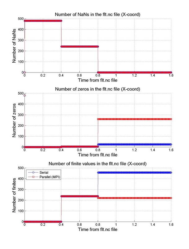

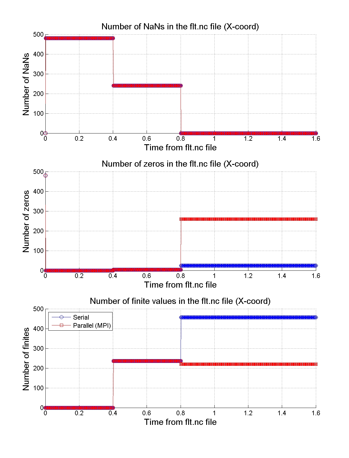

I first ran the test case in serial mode and the results were OK. When I run it in parallel however, upon doing a restart, the particles prior to the restart have the expected X,Y, etc. values but the new particles (injected upon/after the restart) all have X=0, Y=0 - i.e. they are all zeros! The results are illustrated in the attached plot where I have tracked the value of the X-coordinate in the ocean_flt.nc file. It shows the total number of zero-valued X-coordinates, total number of NaN-valued (1x 10^34 valued) X-coordinates and also the number of X-coordinates with finite values (0 < X < 10000) say. The sum of these three numbers should always be 480 (as a function of time) because that it the total number of particles I inject in to the simulation.

This plot tracks the statistics for the X-Coordinate from ocean_flt.nc
