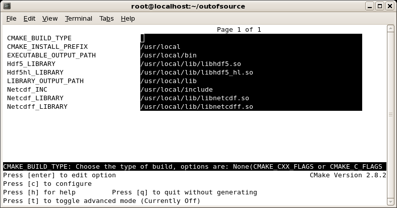

As a small follow up, it may not find numpy if a path in the configuration process of ccmake is not right. Attached is a screenshot of ccmake.

- What ccmake should show with the CentOS 5.5 Virtual Box image.
- pyroms_ccmake.png (45.39 KiB) Viewed 8994 times
