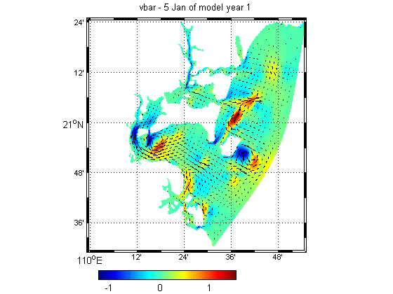

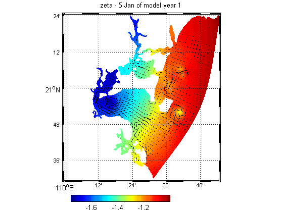

When i run a model, I don't know Why are so much circulation?
Who can help me?

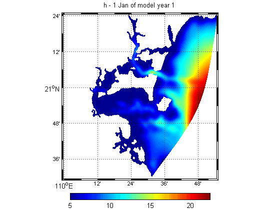

The topo:
The zeta:
The ubar:
The vbar:

#3 Unread post by kate »
So you have some kind of tidal forcing? Do you expect tidal resonances in your domain? I'm not sure what it is you are concerned about.
