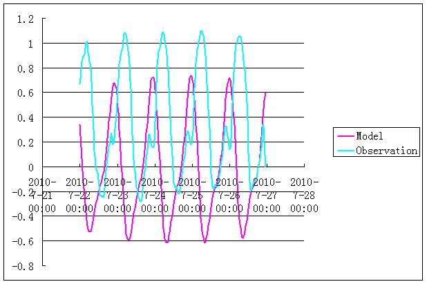

The following two figures are my study area and result.The red area is model area.
Why such a big gap between simulation and observation?

Regarding the Observation vs. Model results they seem to be of the same period and amplitude. It seems as if the Observation is not referring to mean surface level and that there is a shift in time. This is most likely related to the first problem, have a look at the links.
