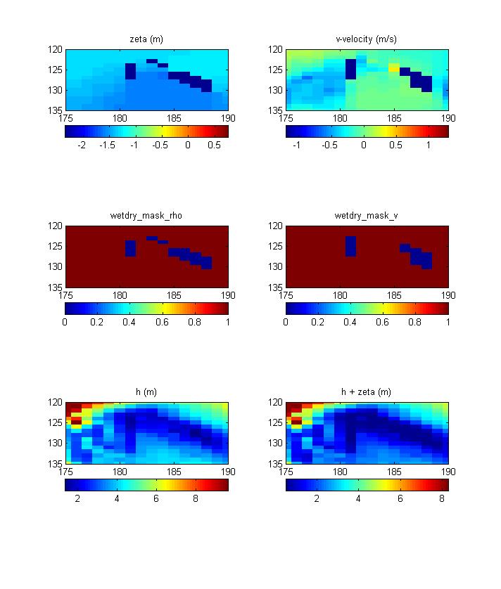

I'm trying to setup a tidal model with wetting-drying scheme. The minimum bathymetry in my grid is 0.1m, and the minimum depth for wetting and drying was set to 0.5m. Blowing-up occurs at the step 16979. Only tide forcing was added to the model.
DT == 60.0
NDTFAST == 10
Minimum barotropic Courant Number = 1.00127762E-02
Maximum barotropic Courant Number = 4.44498424E-01
Maximum Coriolis Courant Number = 4.82332138E-03
rx0 = 2.000000E-01 (Beckmann and Haidvogel)
rx1 = 1.800000E+00 (Haney)
I checked the restart file and found that the blowing-up was occurred by abnormal v velocity. (See Figure 2, in grid cell x = 185, y = 123),

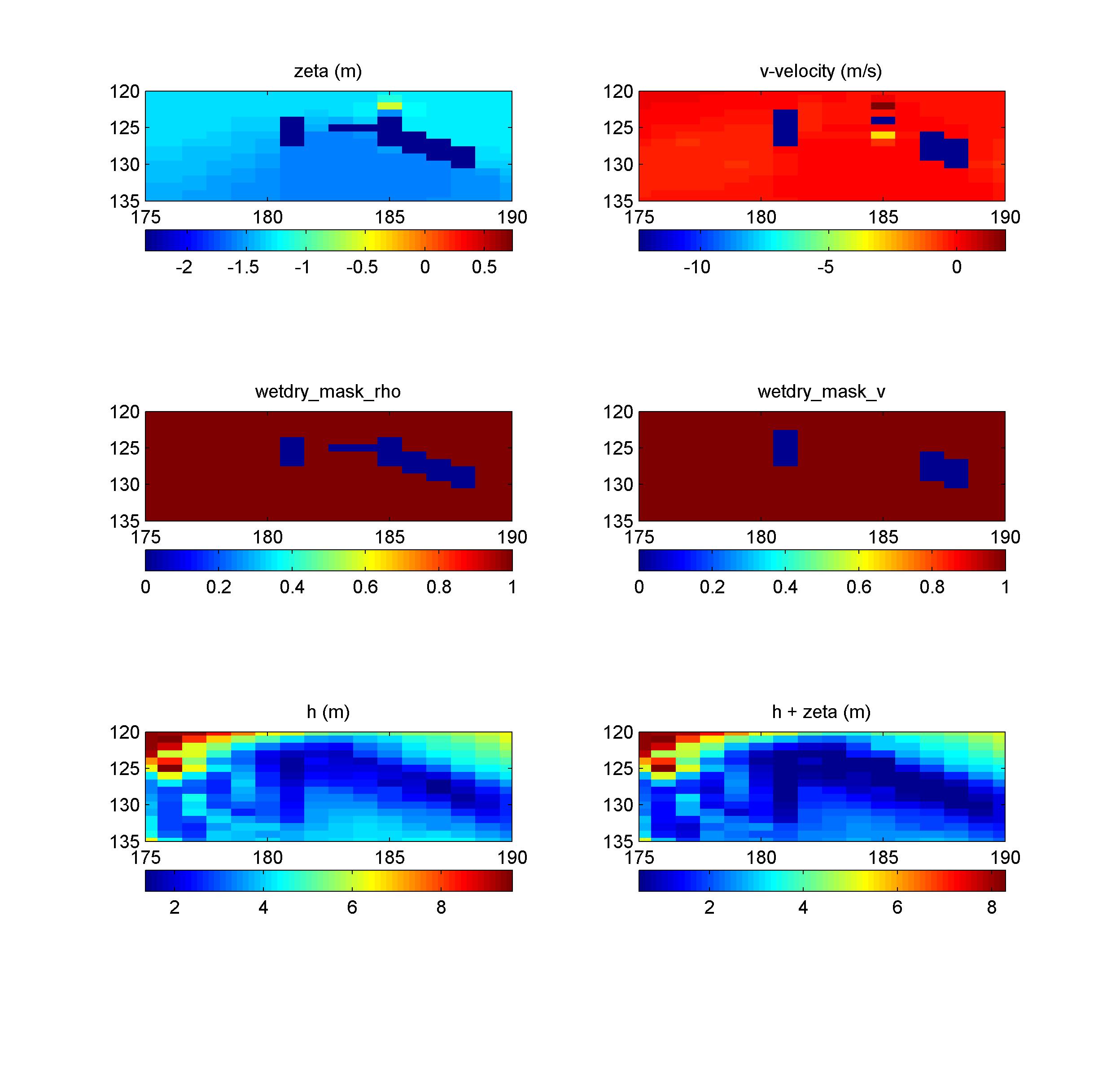

I also plotted the zeta and v one step before the blowing-up (Figure3).
(one step before)
(one step before)
I can’t identify what caused the abnormal v velocity.
Can anyone give some suggestions?
