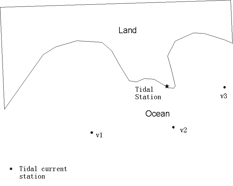

the figure is my studied area. There are one tidal level station and three tidal current station. i have made an force tide file from the station data and OPTS data.(the tidal lvel data last one month and tidal current last two days)
However, there also a lack of boundary file,when i use the cpp:*_M2FLATHER.
The question is how to make the boundary file?
I have tried to make a boundary file, the 'zeta' is a same value in a same time(because only one station).
Who can give me some suggestion about how to do a tidal model in the area.

You can find instructions on how to create a boundary file in the CDL definitions to make netcdf ROMS files. Check in your source directory:
/yourpath/src/Data/ROMS/CDL/bry_unlimit.cdl or
/yourpath/src/Data/ROMS/CDL/bry_limit.cdl
These are netcdf templates to follow. Then use your favorite tools to create them.
Regards
