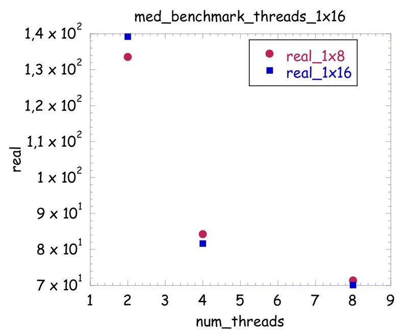

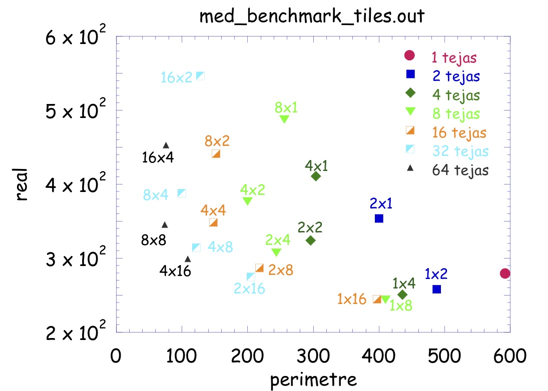

ROMS comes with it own benchmark. It is an idealized Southern Ocean application and it is activated with the BENCHMARK option. By default there is no I/O. There are 3 grid sizes: 512x64x30 (benchmark1.in), 1024x128x30 (benchmark2.in), and 2048x256x30 (benchmark3.in). Notice that all the horizontal grid sizes are powers of two, so we can have endless, balanced tile partitions.
You need to carry an ensemble of benchmarks to be statistically meaningful. They need to be carried at different times of the day. We need to avoid I/O always to get realistic timings. You for instance can turn on I/O in the BENCHMARK application to see what I am talking about.
My experience with shared-memory and distributed-memory is that for small grids the timings is about the same and I haven't observed any statistical trends. You will be surprised sometimes that actually the distributed-memory is faster. As the grid gets larger and no longer fit in cache, the distributed-memory configuration is actually faster. This is because of the page faulting in shared-memory state global arrays after the cache size is exceeded. In distributed-memory, the state global arrays are not global but of the size of the partition plus ghost-points. The efficiency of an application has an optimal tile partition for a particular grid size. Once that this is reached, the efficiency deteriorates due to excessive MPI communications. I have made this point countless times in this forum.

This is not the best way to run ROMS.Grid size: 1398 x 726 x 1
Tilling: is 3 x 2
Try to set tiling to 8 x 81 (yes, meaning eight by eighty one),
rerun it and report your finding back to this forum. We will
continue after that...

Re: Intel’s new i7 980x CPU gives disappointing speedup
I made it up just as a first guess. Generally for these kind of problems one wants to chose the size of tile to reach the best possible compromise to satisfy all of the following:QUESTION: where does the 8x81 tiling come from, memory configurations?
(1) the size must be sufficiently small to fit into processor cache [typically this means the outermost-level cache, L3 if the processor has it, or L2];
(2) "perimeter-vs-area" consideration: as tiling is introduced there is a bit of redundant computations takes place along the subdivision lines (literally certain provisional variables [e.g., fluxes, etc...] are computed twice -- when processing a boundary row of a tile, and then the adjacent boundary row of the neighboring tile]. Consequently, if your tiles are too narrow, say only a few points wide, the cost of extra computing along the sides may be not negligible;
(3) length of innermost loop [the i-loop in ROMS] must be large to ensure good processor performance of pipelined execution.
Obviously it is hard to compromise and satisfy all three, but the situation is simplified a bit by realizing that the optimum geometry [size and shape] of tiles does not actually depend on your problem -- horizontal grid dimensions -- but is actually a function of CPU and computer hardware you use. Thus, when going to a larger problem, it makes sense to increase the number of tiles rather than their size.
Some of these ideas are expressed in http://marine.rutgers.edu/po/Workshops/ ... petkin.pdf ...and do not be afraid that it is too old: sometimes a fresh news is just nothing but well forgotten news. What you observe on your i7 machine is the kind of behavior described on page 9 of that poster.
To get a more precise feeling about the optimal tiling for your machine and problem you have to run and compare more possibilities: not necessarily as many as in that plot, but a dozen would be useful to orient yourself.
Is is the only option? Perhaps not. Advanced Host Controller Interface (AHCI) is Intel's term for a new standard for SATA interface, which may or may not be supported by hard drives and operating systems. It is basically to enable SCSI-like behavior of SATA disk, like native queuing, or simply put, a revision/expansion of SATA commands on hardware level. If you buy a modern disk, it is fully supported, and so does modern Linux. Old (in this context 5-year old) drives do not. That is why it is not enabled by default.[Configure SATA] where the options are {[IDE],[RAID],[AHCI]}, by default the setting is IDE.
Question: Is this the one option that speeds up I/O?
As far as I can tell, AHCI --- non-AHCI makes difference only under heavy load, but barely noticeable on common use, i.e., running model which does computing 99% of the time.

I’ve tried some different tilling options and as I understand the tilling partition in ROMS almost anything goes as long as the total number (NtileI * NtileJ) is a multiple of the number of treads (in my case 12).
In the present grid:
Lm (#points in I-direction) = 1398 = 2 * 3 * 233, and
Mm (#points in J-direction) = 726 = 2 * 3 * 11 * 11
As I understand it NtileI and NtileJ should preferably be made up of the prime factors of Lm and Mm, as this would generate equally sized tiles. Fortunately for me the overhead of having unequally sized tiles is not that big.
Based on the testing that I have done, the best choice is NtileI=68 and NtileJ=33. This choice is 8 sec. (7%) faster than 8*81 for 1000 modeled time-steps.

Tonight I unfortunately only had time to test the first part of what you suggested. The rest will come later. To begin at the end I'm most grateful for the help and guidance you have already provided, and relative to where I began the simulations are running much faster now.
Answer to 1:
When re-compiling after editing the compiler flags (adding the '-no') I got a segmentation fault error. I doubled the stack size (by default the stack size is 8192 kb) and the model could run again. And yes there is a clear difference and quite a good speedup, see table below:
(first two rows give the tilling, the third row gives the execution-time in seconds using the default flags and the forth row gives the corresponding execution-times using the added '-no' flag)
NtileI 12 12 12 12 24 24 36 36 36
NtileJ 12 24 30 36 24 12 12 24 36
'def.' 81 73 71 71 71 78 79 77 80
'-no ' 96 60 62 64 74 66 72 70 74
The point is that you know exactly where you have started, but you do not know where are...and relative to where I began the simulations are running much faster now.
you heading in sense that you do not know when it is good enough to stop. And I feel that
it will take several iterations from where we are right now.
First, last time you reported execution time of of about 4 minutes (3:55 at best to be exact).
Now the best time is 60 seconds using 288 tiles (12x24). Are you running a different problem
now? Or different duration of the same problem.
Secondly, the contrast between -heap-arrays and -noheap-arrays you are observing
(roughly 70 --> 60 seconds) is about 15%, while I expected to see something close
to 25%. So it is kind of flatter, which makes me feel that your code has some sort
of "ballast" attached somewhere -- an expensive, computationally intense piece of code
which behaves perfectly "flat" (not sensitive to tiling, compiler flags, etc) and
which takes about 10..20 seconds (out of 60) and dilutes all the sensitivities.

Maybe this is the place to ask this question: Why do I get so different performance using similar machines?
I have two machines:
1.- HP xw8600, with 2 Intel Xeon Quad Core X5450@3 GHz, Ram 16 GB DDR-2@667 MHz and writing down to 2x15000 rmp raid 0 drives. Running Ubuntu 10.10 (maverick) 2.6.35-24 server.
WS> uname -a
Linux ieofisica 2.6.35-25-server #44-Ubuntu SMP Fri Jan 21 19:09:14 UTC 2011 x86_64 GNU/Linux
2.- Mac Pro (early 2009), with 2 Intel Xeon Quad Core X5500@2,26 GHz, Ram 16 GB DDR-3@1066 MHz and writing down to 2x7000 rmp raid 0 drives. Running Mac OS 10.6.6
Mac> uname -a
Darwin Mac-Pro-de-Rosa-Balbin.local 10.6.0 Darwin Kernel Version 10.6.0: Wed Nov 10 18:11:58 PST 2010; root:xnu-1504.9.26~3/RELEASE_X86_64 x86_64
They are running exactly the same problem, same input files. At the end (Total HP time) / (Total Mac Pro time) = 1.76
I will try Shchepet checks but I am not sure I am doing any very basic mistake. I attach a brief of the output of both machines, the only lines where the differences are relevant. Thanks
HP.txt
- (3.55 KiB) Downloaded 2892 times
MacPro.txt
- (3.57 KiB) Downloaded 3054 times
Compiler flags are not optimal: -heap-arrays ---> -no-heap-arrays, but you have to adjust stacksize limit.Compiler flags : -heap-arrays -fp-model strict -openmp -fpp -ip -O3 -msse2 -free
Resolution, Grid 01: 0384x0176x030, Parallel Threads: 8, Tiling: 001x016

Tiling is not optimal, my guess, you may try 4x22 or 3x16, but overall this is worth
some experimentation.

I tried to optimize tiling for the macPro and attached med_benchmark_tiles is what I got. I also played with number of threads, attached med_benchmark_threads, and I did not include the number I got using 16 threads for the 1x16 case because it was so bad that I did not take it into account. As I was happy with the results for the MacPro I used the same settings for the HP. Maybe this is not correct.
