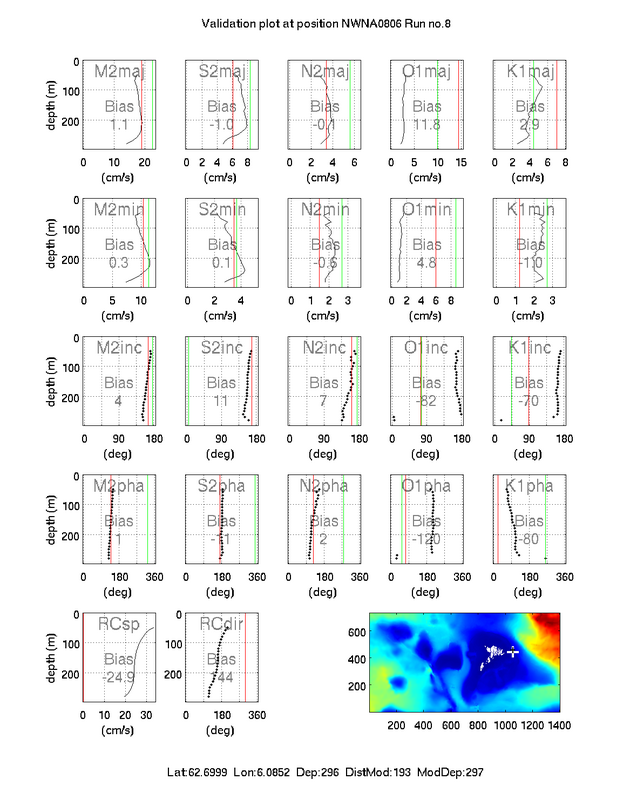

Hi all
I’m running ROMS in barotropic mode only forced by tides. The results are actually quite good for all validated constituents (surface and current) except for the current-ellipses of O1 in one area. In this area the modeled O1 current ellipses is up to five times too large (see Figure 1 below). The only other thing which seems suspicious is that the diurnal constituents seem to be somewhat out of sync with the forcing (see Figure 2 below). Beginning right inside the boundary, the modeled diurnal constituents (surface amplitude) are about one cm too large compared to the forcing and some boundary features are shifted somewhat. Similar behavior is not observed for the semi-diurnal constituents.

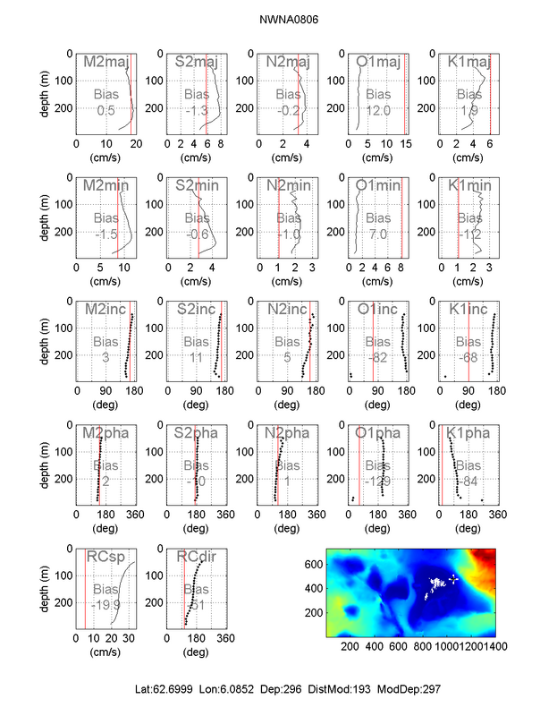

Caption Figure 1:<br />Red lines are ROMS results (derived using t_tide). Black lines/dots are measured ADCP profiles.The picture in the bottom indicates depth in the model and the '+' is the location on the validation point. The abbreviations are maj (major axis), min (minor axis), inc (inclination), pha (phase) RCsp (residual current speed) and RCdir (direction of residual current). In each plot the crude average bias between model and data profile is given.
Caption Figure 1:

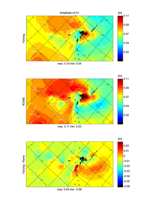

Caption Figure 2:<br />Uppermost plot is from the forcing O1 surface amplitude, the second plot is of the equivalent ROMS results. The bottom plot is the difference between the two. Colors indicate height in m. Black is land, black +’es are ADCP validation locations, dashed black lines are Lat and Long, and white lines/text give depth.
Caption Figure 2:

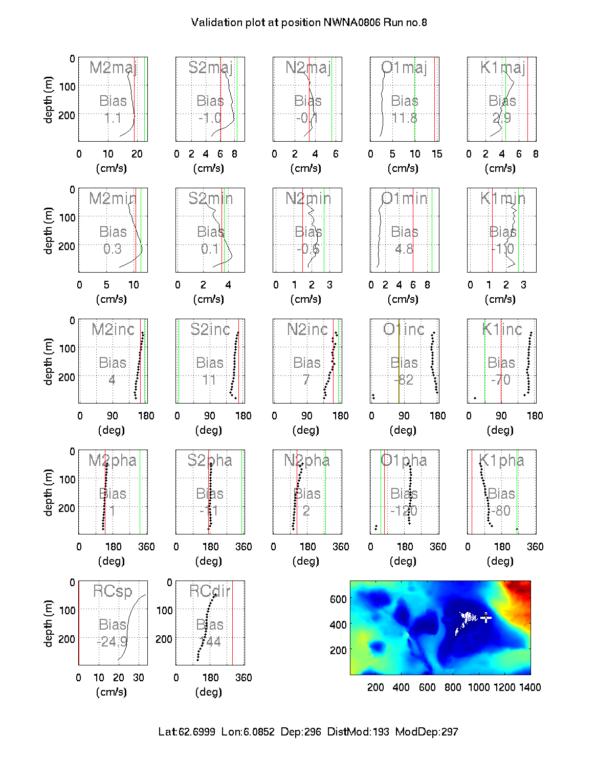

- As you can see below in Figure 3 the O1 overshoot is also present in OSU forcing data (green line is forcing, red is ROMS and black is data).
The solution must therefore be to find alternative forcing, at least for the daily constituents.
There is a difference (Fig 4 i.e. on the boundary) between forcing and ROMS, which I guess is caused by the fact that this run was forced by surface constituents only.

Figure 4: ROMS and OSU-forcing on the boundary (first interior model point). See Figure 1 and Figure 3 captions for more info
Figure 3: ROMS and OSU-forcing at the problematic site. Roms red, Forcing green and data black.See Figure 1 caption for more info.
