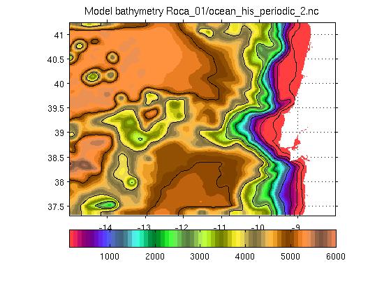

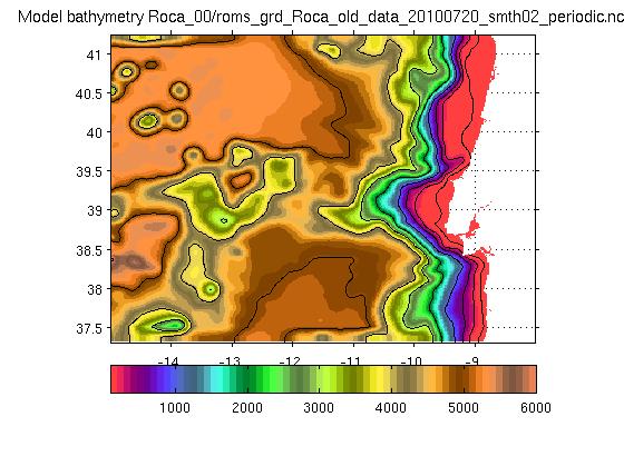

To better show my problem with NS_PERIODIC, I've 3 figures with h. "Grid_bathy.jpg" is the bathymetry from the grid file, "NS_periodic_his_bathy.jpg" is the bathymetry read from history file with NS_PERIODIC boundary conditions where the wrong h appears at Western and Eastern boundaries and finally "without_NS_periodic_his_bathy.jpg" is the bathymetry read from history file without NS_PERIODIC boundary conditions with no problem with the h at the boundaries
I know that NS_PERIODIC condition is not used by the majoroty of ROMS community, but is a possibility offered by ROMS...
Somehow when I consider NS_PERIODIC the history file changes the bathymetry and puts at the western boundary h=10m and at the eastern boundary the bathymetry of the western boundary!.

The three plots in the first post look the same to me. What is the difference you are seeing? Can you plot a difference field?

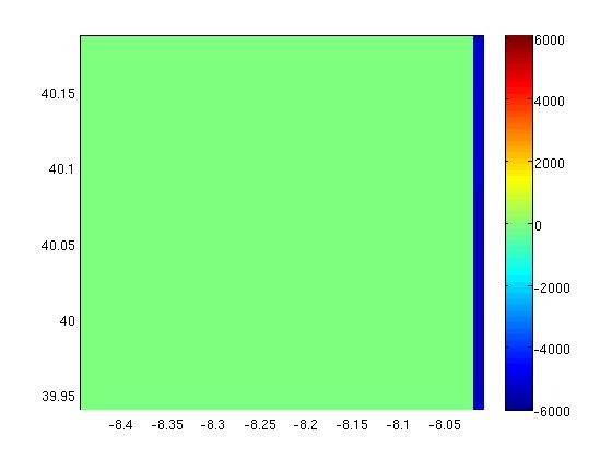

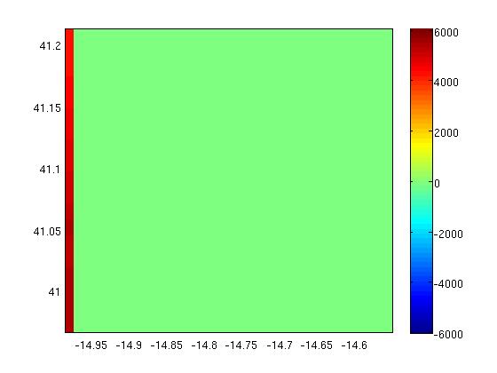

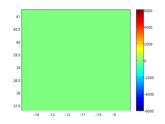

Is just the first and last columns, see att difference with W and E zooms
