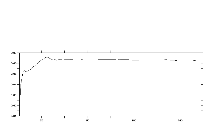

1. I had run in diagnostic mode (TS_FIXED) upto 150 days. When I plotted kinetic energy vs time averaged over basin it increased upto 20 days and then it is almost constant(file attached). Whether now can we call the model is stabilized?

- Kinetic Energy Vs Time at first level
- ke_basin.gif (3.13 KiB) Viewed 7177 times

With TS_FIXED, the model doesn't really get to do a whole lot. You could have gone straight to free T,S after the 20 days - or even at day zero. The point of TS_FIXED is to spin up velocities in balance with the T,S fields if you only have say a T,S climatology to initialize from. My experience with using Levitus climatology this way is that it contains enough small scales that you spin up peculiar u,v fields. Setting T,S free to evolve then lets things settle into a more reasonable flow. My point last time is that u,v respond so quickly to the density, that it doesn't much matter whether you spin them up first or not. Now we happily initialize from a global ocean model, so we start off with u,v in balance and don't even think about the TS_FIXED option.rao_sc wrote:Thanks Kate
