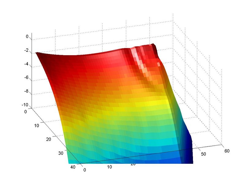

Re: wave growth in kelvin wave test case
hi, i get the same free surface drift - including a ripple reflected from the upper right corner, see pic below. so i guess this weird behaviour really is in the test case. anyway, i find it comforting to hear it's been noticed by other users as well..
