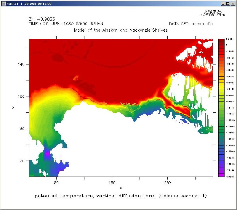

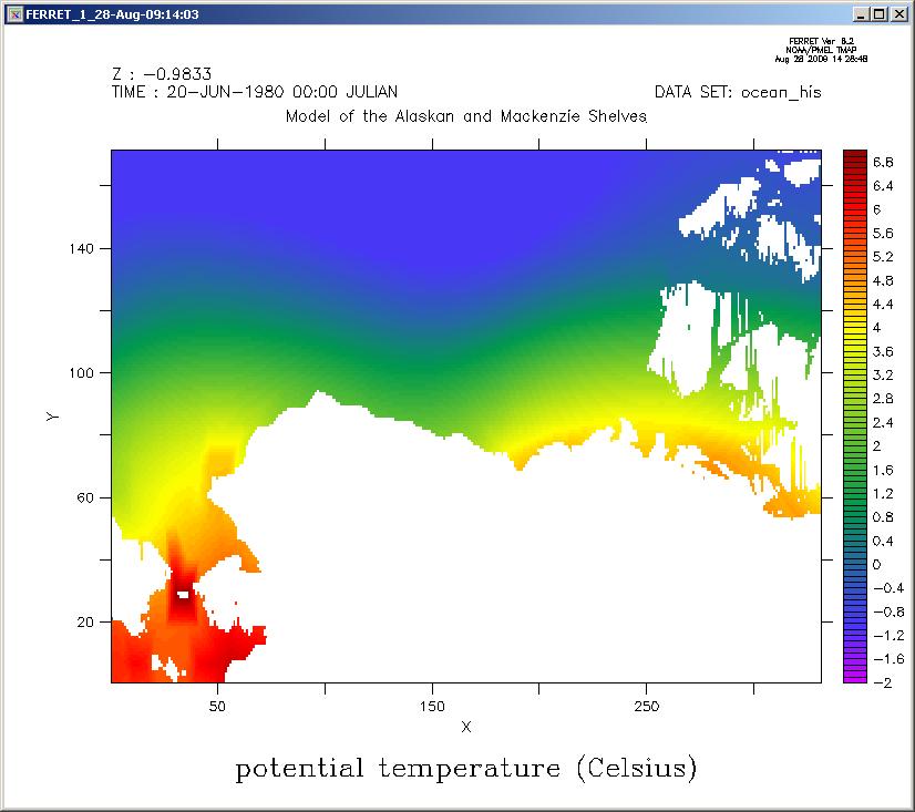

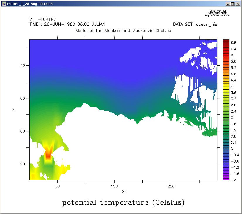

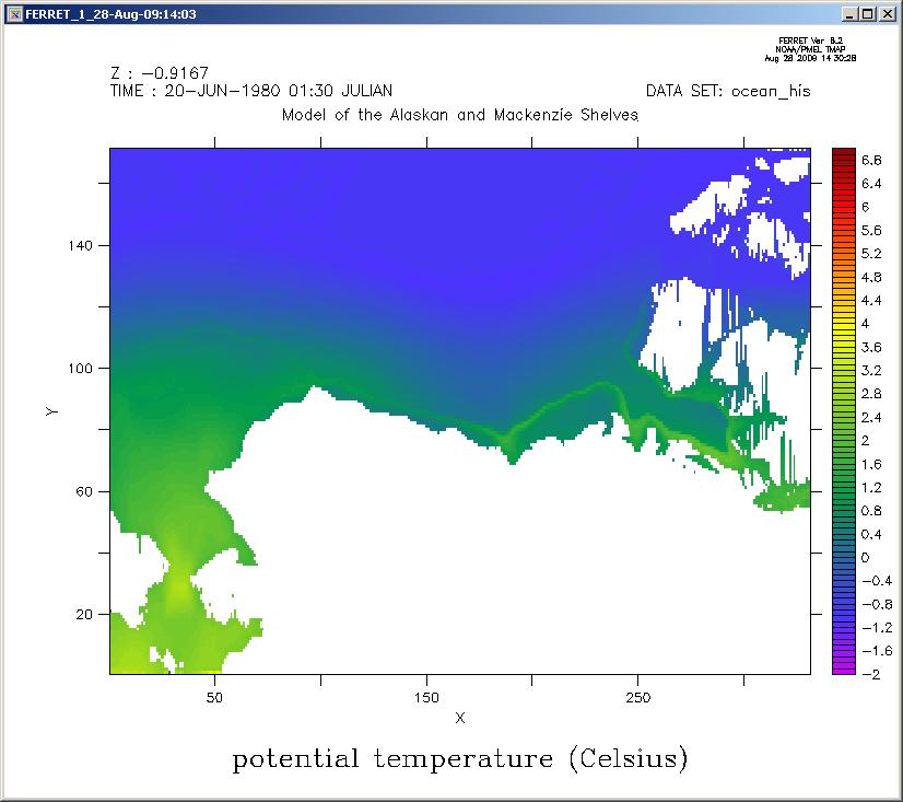

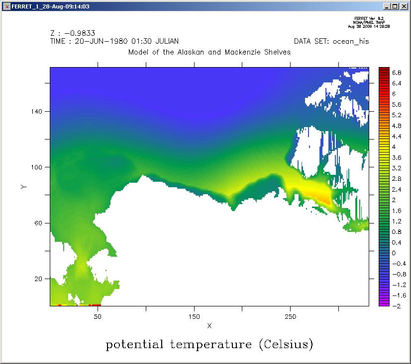

I am just getting started with ROMS, setting up an application in the Arctic for the Alaskan and Mackenzie Shelf region. I did a quick and dirty setup, just to see if I could get up and running. I have created the model grid and am able to run the model with some simple initialization and forcing, but I find that the ocean temperatures are behaving strangely. I set initial temperature conditions from Levitus values. Near the Bering Strait, the temperatures are around 6deg initially. After running the model for only an hour and a half, the temperatures drops to around 2 degrees for this area which is quite large. Where could all this heat be going and so quickly? (This run was done without sea ice.) Any thoughts are much appreciated. Thanks!
Initial Temperature - Surface (Level 1)
1.5 Hr. Temperature - Surface (Level 1)
Initial Temperature - Level 3
1.5 Hr. Temperature - Level 3

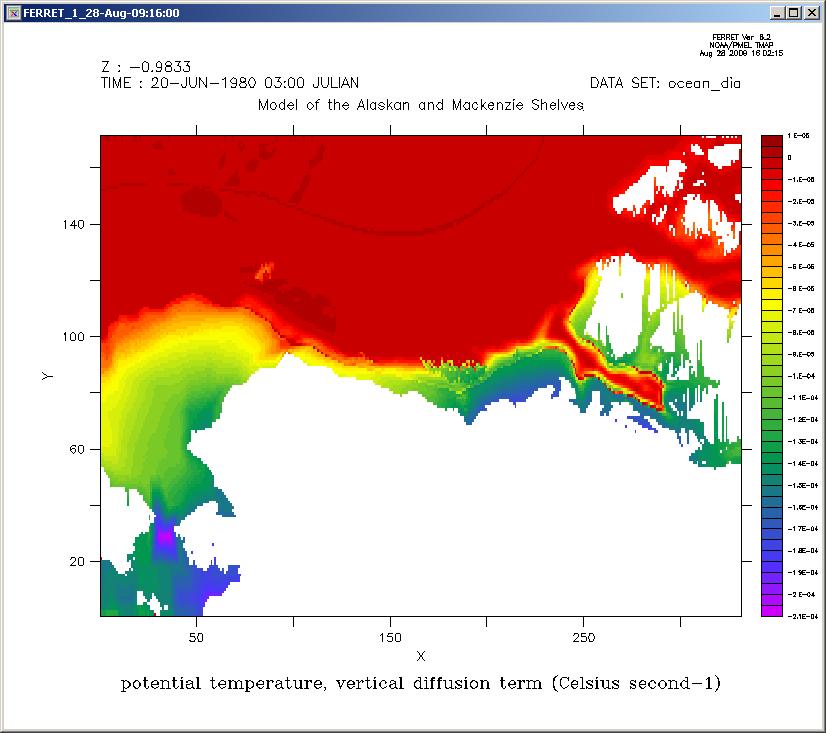

I also noticed the vertical temperature diffusion, could this be part of the problem? But cooling at 0.0002 degC/sec should only lead to less than a degree temperature change in an hour, not the 4-5 degrees seen in the model results.
