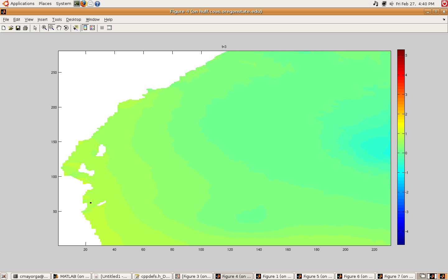

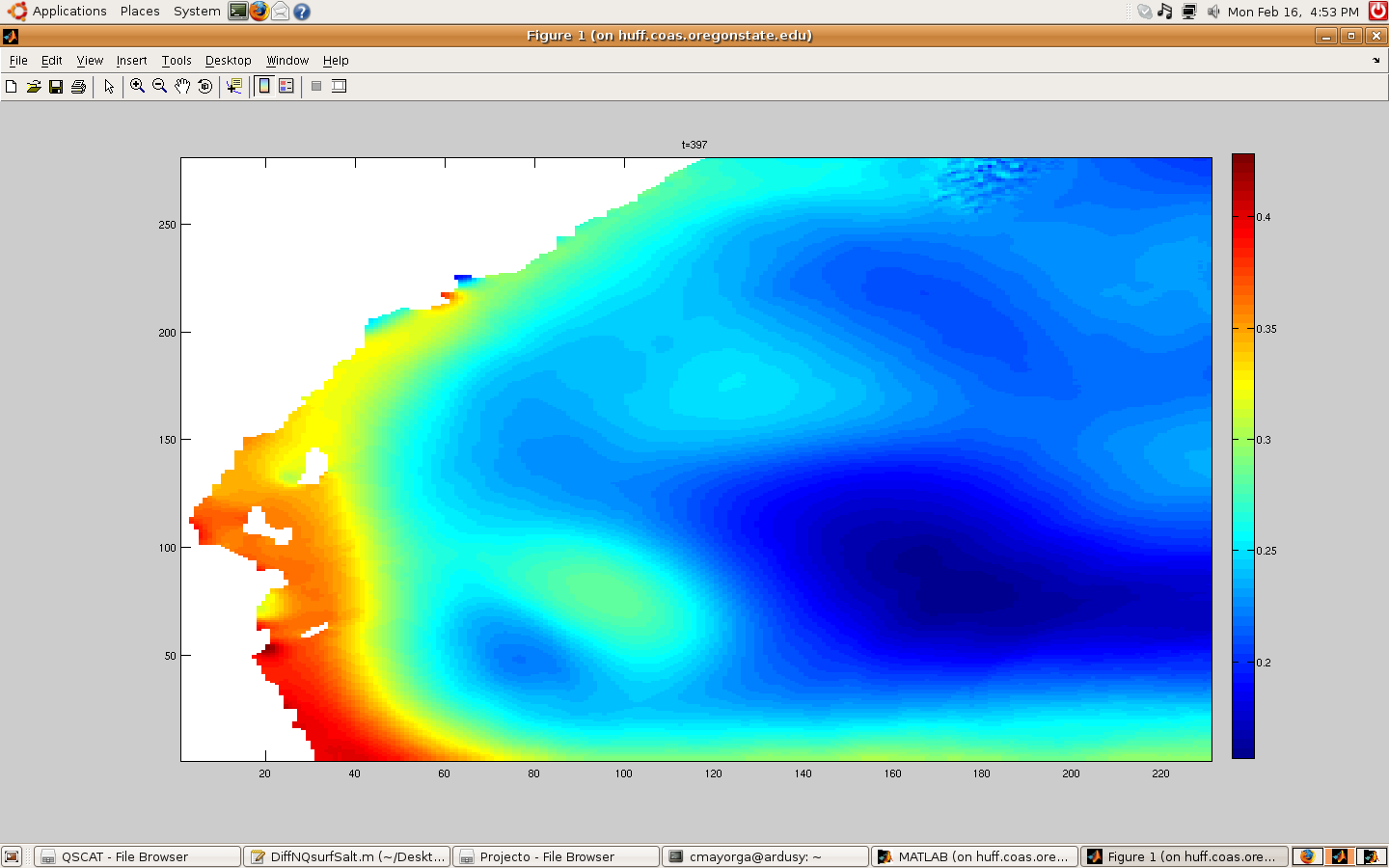

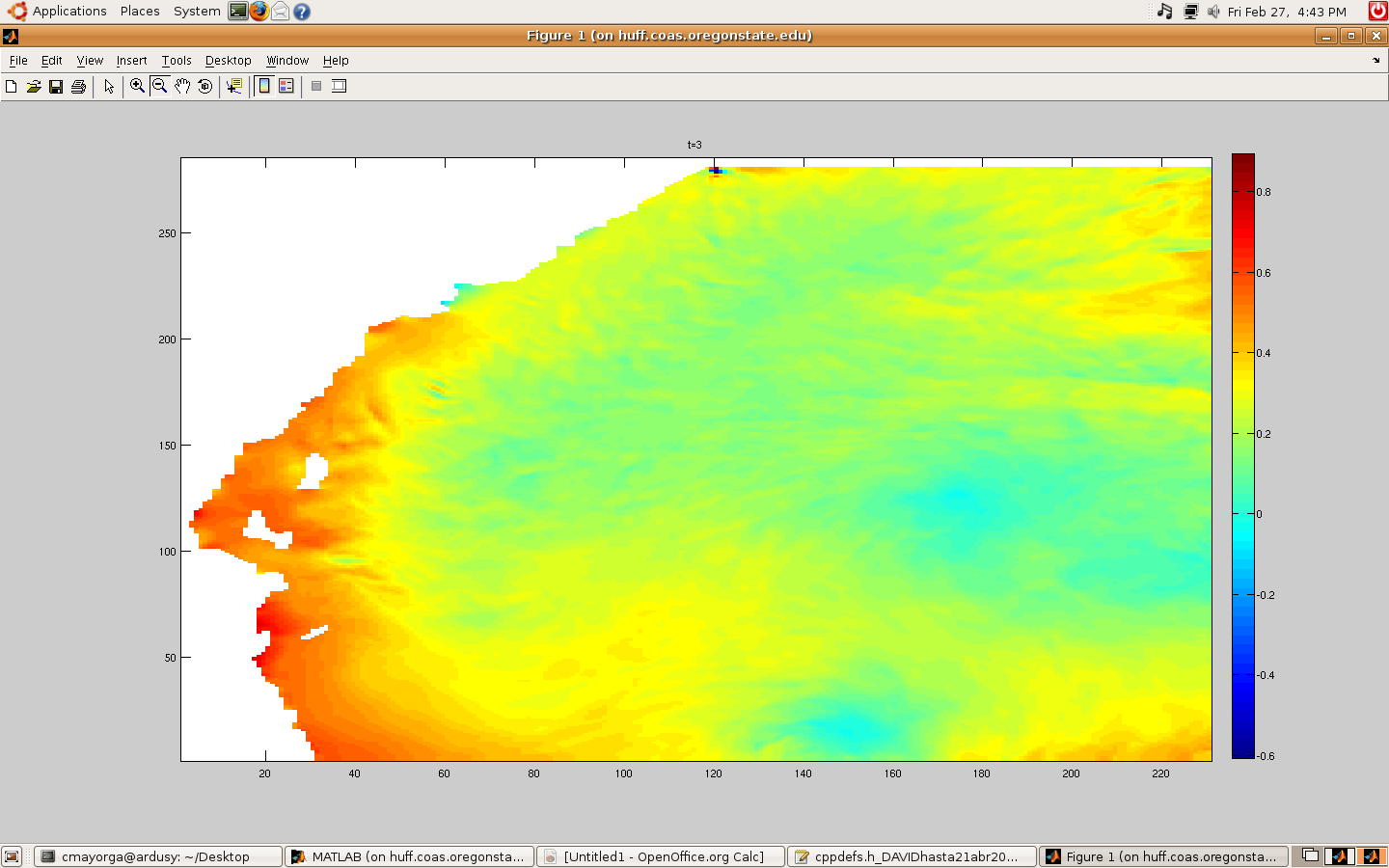

Hi everyone
I thought I had a problem similar to Kate's... however she already fix it and I can't!.
:roll:
My model is a realistic simulation of the east coast of Africa.
I test the grid with analytical profiles uniformly in the horizontal, and surface forcing and it worked well. The problem arose when I added realistic initial conditions, and boundary forcing. I have looked at all the input files fields and they look smooth...
The model blows up because one single cell, or a group of a few neighbor cells get very different SSH values (i.e. -6 and +5m).
I changed form TS_SVADVECTION to TS_C4ADVECTION as Hernan suggested, and that helped me to extend my run from less than 1 day to 138 days... but then it blows up similarly.
I am using monthly climatology surface forcing, I checked and all my short wave radiation values are positive. I haven't change the 2*pi factor.
I will appreciate any suggestion.
Many thanks in advance.
GaBy

Looking a bit before it blows up, I notice is a whole region of some scatter cells whose values stop changing as smoothly as the rest.

So it always blows up along an open boundary? Your boundary condition for the free surface is essentially a wall. Do you have values you can provide as boundary conditions to go along with the rest of your boundary fields?
With or without tides, my boundary conditions on each open edge are:
WEST_FSCHAPMAN Western edge, free-surface, Chapman condition.
WEST_M2FLATHER Western edge, 2D momentum, Flather condition.
WEST_M3NUDGING Western edge, 3D momentum, passive/active outflow/inflow.
WEST_M3RADIATION Western edge, 3D momentum, radiation condition.
WEST_TNUDGING Western edge, tracers, passive/active outflow/inflow.
WEST_TRADIATION Western edge, tracers, radiation condition.

Hi Kate
Thanks for your answer.
Since I change the advection scheme to TS_C4ADVECTION the blow up tend to be close to the coast.
My boundary conditions file includes monthly values for zeta. Is my understanding that ROMS interpolate between the values on the input files for each time steps it needs right...?
Anyway I am going to try the open boundary conditions you recommend.
