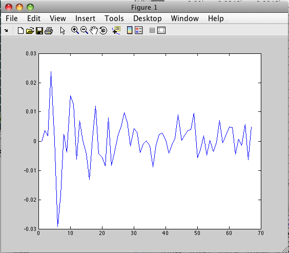

The model now runs with the tidal harmonics, but the results aren't great.The next figure show the elevation at the boundary in the first 11 hours of the simulation:
Picture 2.png (17.82 KiB) Viewed 2845 times

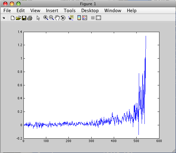

This one shows the velocity, in the same station, but for a 4 day period:
Picture 1.png (17.03 KiB) Viewed 2843 times
The model blow up after the 4th day, but I'm not sure why it does that.
I've check my harmonics netcdf file and it appears to be ok. I created it based on the CDL files available. I also noticed that the model converts the phase direction from degrees to rads and the period from seconds to hours in. I've changed that in varinfo.dat to suit my units.
Is there anything else I should have in mind that I've might had missed?
Do I need more than the mean sea level in my climatological forcing file to make it work?
Could this error be because I'm only imposing the tidal elevation and not adding the tidal velocity?
I would be very grateful if you could give me any advice on this please.
