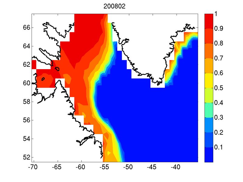

Re: running ice code ...
What is your area of interest? You mention the lateral boundary conditions. Ufuk is modeling the whole Caspian and can get away with wall boundaries. His problem is dominated by the thermodynamics - heat in and out at the vertical boundaries. Is that true of your situation as well?
Hi Kate,
My area of interest is the Labrador Sea. I attached a figure to be more accurate. I have four open boundaries. I am not sure whether the vertical boundary heat loss or the southward and eastward cold and fresh water (or ice) transport is more important. However, the ice in this region often expands as shown in figure "200802.png".
My model output showed SST around -2C in the region that sea ice appeared, but no ice.
Do you know if any of the ice observed there was formed there, or was it all advected southward from outside your domain?
Have you looked at the output of any of the ice formation variables Wai, Wao, Wfr, etc? Is it forming and melting or just not forming? At -2, it should try to form.
As far as boundary conditions go, it could be tricky indeed. I tried running a regional Chukchi-Beaufort domain and ended up with a grid covering the whole Arctic once again. The northern open boundary of the regional domain was just never right in terms of ice stiffness. It either let too much ice flow out or it acted as a wall for southerly winds. In your case, if the ice is consistently flowing south out of Baffin Bay, you might get by just knowing the ice flux (including thickness and velocity). Does anyone have a credible model you could use for boundary conditions?
Has anyone had better luck with ice open boundaries in a regional setting?
I do not have data to determine which source is more important, but I know sea ice is constantly advected from the north. I did not have the boundary condition, because I don't know the thickness.
I will check this and update my post soon.
I did not find any credible result yet, I may end up using an arbitrary sea ice thickness at the boundary.
I may talk to someone, but cannot be sure if there is "lucky" one
