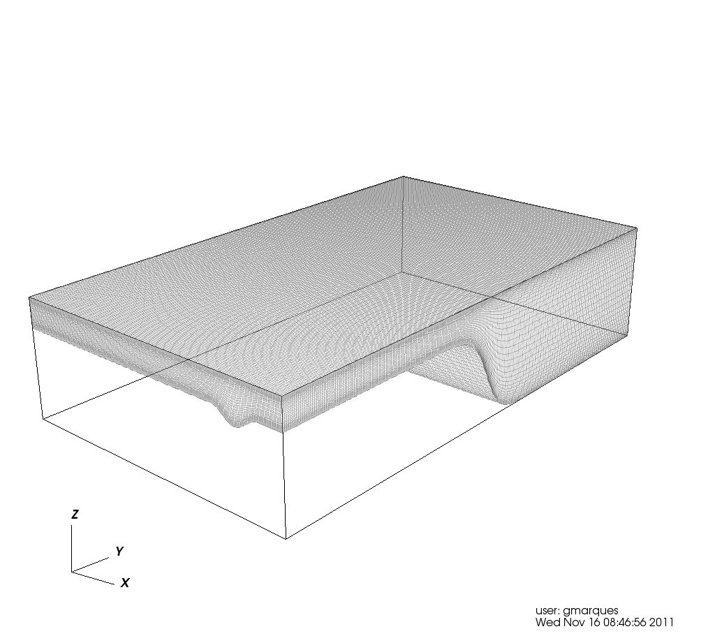

I've used Mayavi in the past, but recently I started using Visit (https://wci.llnl.gov/codes/visit/) instead. The latter is also free, high performance, and interacts with Python.
The following tutorial (see Section 5.4) explains how to write a curvilinear mesh with data (vectors and scalars) in a VTK file using the visit_writer library: https://wci.llnl.gov/codes/visit/2.0.0/ ... t2.0.0.pdf
The attached figure shows a curvilinear ROMS mesh written in a VTK file and visualized using Visit.
Best,
Gustavo

I read the netcdf file using Python and then I follow the above tutorial (see example using Python on Section 5.4) to write the mesh with data in a VTK file. Install Visit, so you can import the visit_writer library from Python.The following tutorial (see Section 5.4) explains how to write a curvilinear mesh with data (vectors and scalars) in a VTK file using the visit_writer library: https://wci.llnl.gov/codes/visit/2.0.0/ ... t2.0.0.pdf
