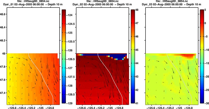

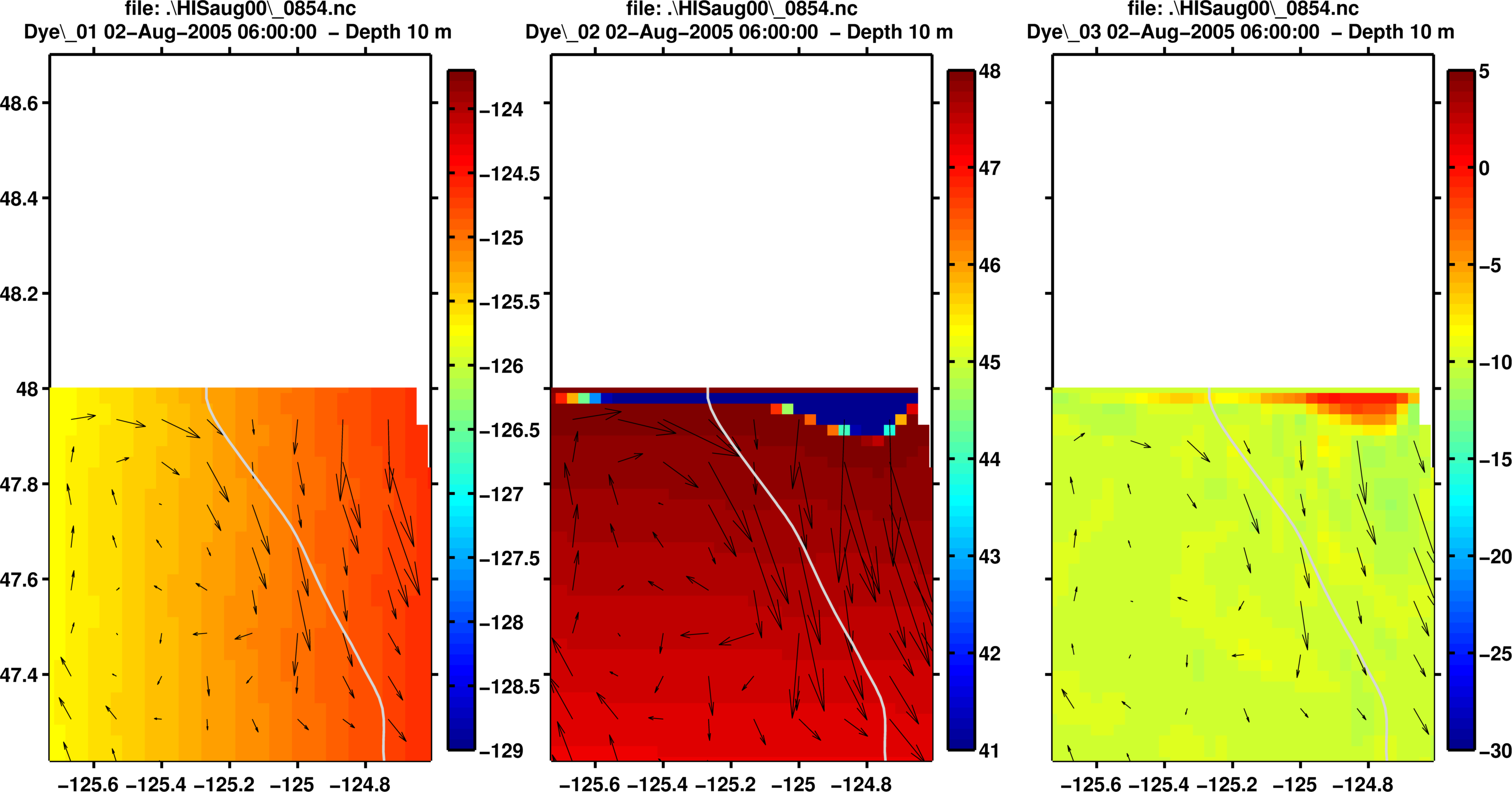

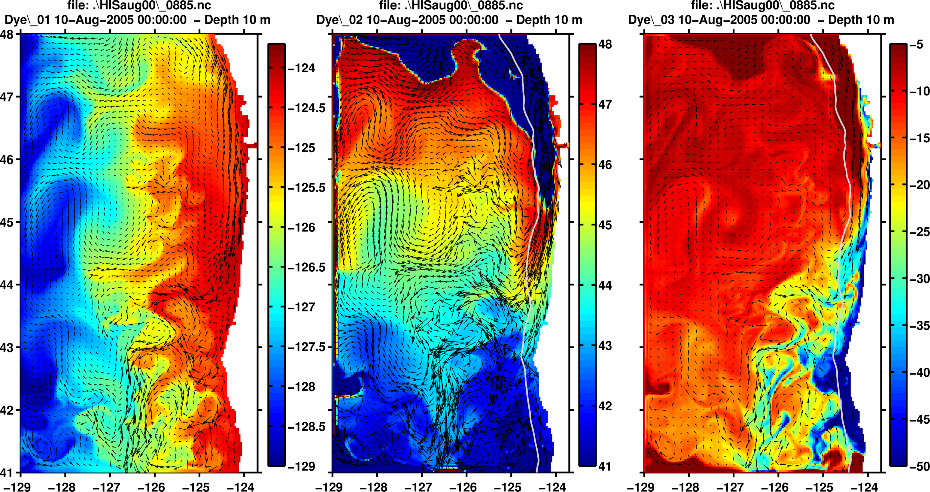

I am advecting three dyes one looks great, one is terrible and the third is less than acceptable. This is during the same run and all options for the three dyes are the same. I had done a similar run before and it worked nicely. I have double checked my bry and ini and forcing files it is all as it should. Why would one dye be advected nicely and the other not?
I can see a bad oscillation in the first HIS file after I restart the simulation with the dyes.Plot attached. the dye values in leftmost are ok, the dye values in middle should be equal to the latitude at each point, that blue stuff coming out of the boundary isnt good. Similarly the one on right should all have values of -10 (about)

These dyes are the initial position for any given grid cell and by advecting them I get Lagrangian label dyes. They are defined as:
dye_01=X(x,y,z,t=0)=x
dye_02=Y(x,y,z,t=0)=y
dye_03=Z(x,y,z,t=0)=z
And then advected to compare their initial with their final position. Up to one month integration has been successful before.
