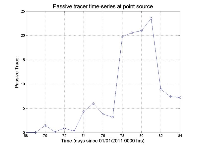

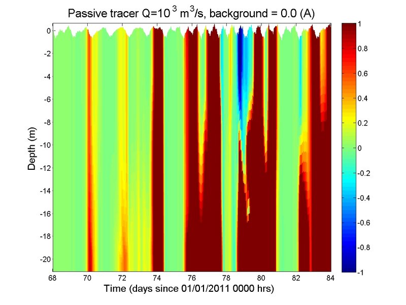

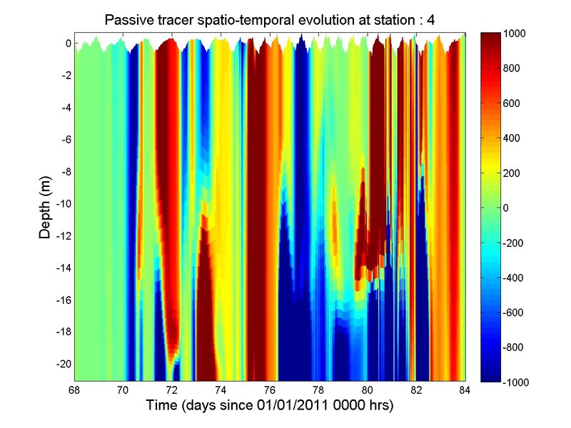

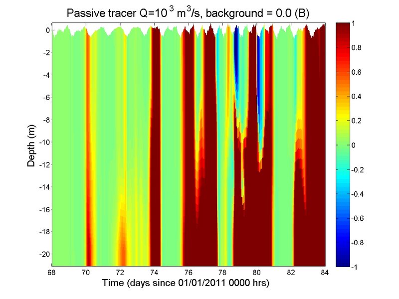

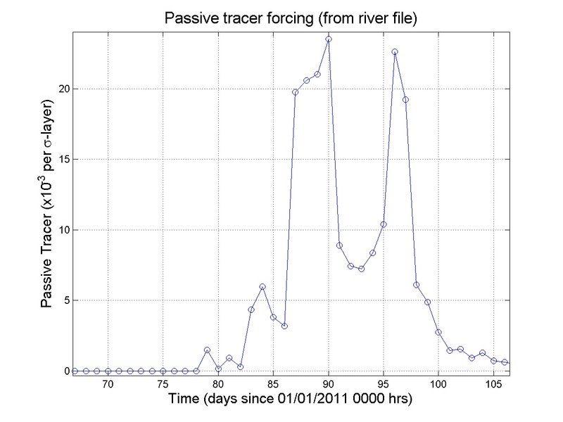

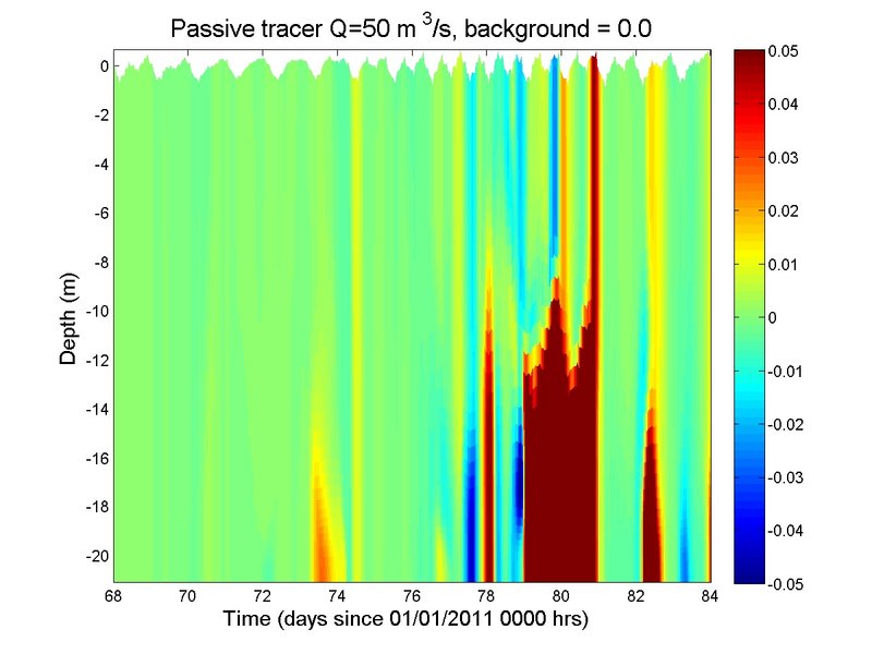

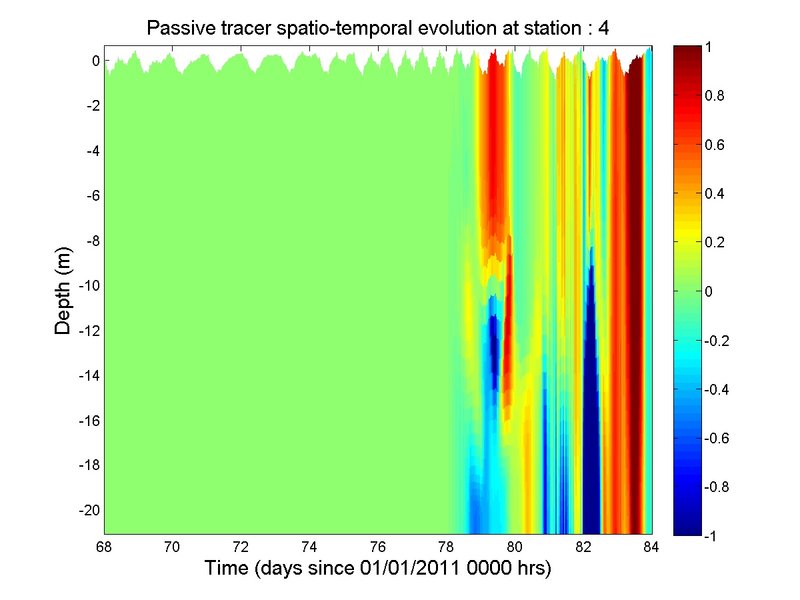

I did some ROMS simulations with a single point source. In the river/point source forcing NetCDF file, in the vertical, I put the distribution to be uniform and as I was only interested in a passive tracer evolution, I put both T and S to zero (in time and space). As I was also trying to simulate a "dump", I put the river transport to zero (in reality it should be a hat-function with a width of ~1-3 hours). The only time-varying quantity was the passive tracer (river_dye_01) - see the plot below. My background passive tracer value was zero and so was my open ocean boundary value. I edited the toms.in file so that I had :
LtracerSrc == F F T ! temperature, salinity, inert
The CPP options I used included :
#define T_PASSIVE
#ifdef T_PASSIVE
# define ANA_BPFLUX
# define ANA_SPFLUX
and, I tried two configurations : (a) #undef TS_PSOURCE and (b) #define TS_PSOURCE.
For (a), I was expecting nothing to happen and for the passive tracer to be constantly held at the background/open boundary value of zero. For (b), I was expecting something like a diffusive process to take place. The results are given in the plots below for the first 16-days of the simulation - i.e. days 68-84 (please note the difference in color scales for the two Hovmoller plots).
As you can see, even with (a), the passive tracer begins to change and evolve with time on day 78 (which is when the river/point source has non-zero passive tracer values). With (b) the situation goes completely out of control and we get huge positive and negative passive tracer values. Although the passive tracer from the river/point source forcing file has only positive values, the plots below show that they in reality take both positive and negative values.
Could someone explain to me what is happening in the ROMS and why we get positive and negative passive tracer values and why a non-zero passive tracer evolution takes place for scenario (a)?

Sorry, I forgot to add that in the simulations pertaining to (a) and (b), the resulting ROMS T and S fields between them are identical. So differences between them are only seen in the passive tracer field.

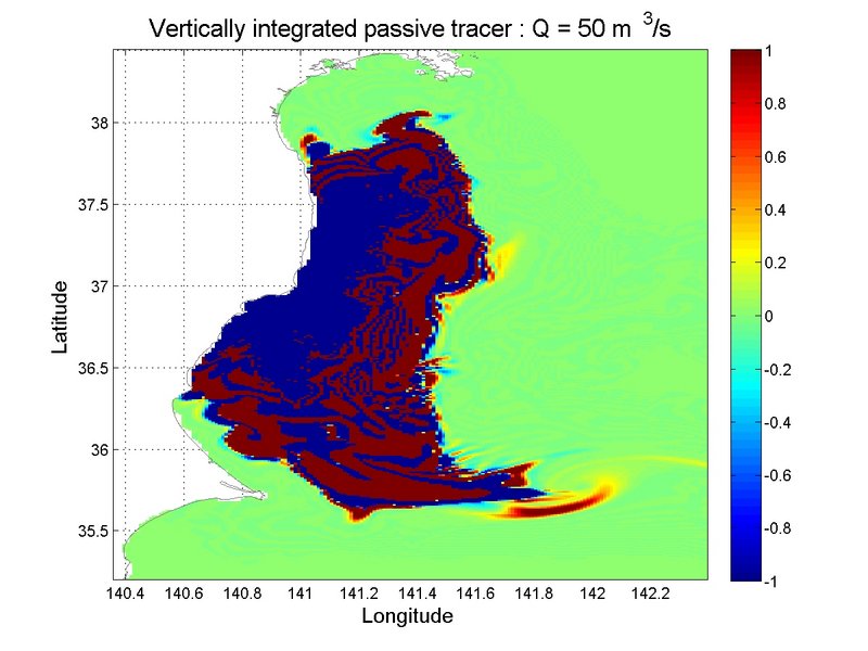

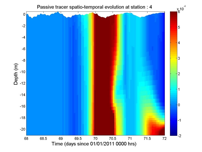

So I repeated the above mentioned simulation with the only differences being :
(1) I included UV_PSOURCE in the CPP options when compiling the code and,
(2) for river_transport, I used 1 m3/s - a small value.
Please find attached the outcome from ROMS. Now, we find that the passive tracer is much closer to zero (the default/background value) but it still goes both positive and negative.
Could someone please let me know how I can include a point source/river in my ROMS simulations which only generates a passive tracer and not any T or S? This used to be so easy to do in the older ROMS like version 3.4, 3.6, etc.!
Also, do you think there is a bug in the way the rivers have been coded up in the newer ROMS and should I write something under "ROMS bugs"?

To implement a point source for selected tracers, use LtracerSrc in the input file.lanerolle wrote:Could someone please let me know how I can include a point source/river in my ROMS simulations which only generates a passive tracer and not any T or S? This used to be so easy to do in the older ROMS like version 3.4, 3.6, etc.!
I don't know if it's a bug or a feature, but as far as I can see point tracer sources (TS_PSOURCE) are useful only at points adjacent to the land mask or the edge of the domain. Elsewhere they generate a dipole, as I pointed out above (8 september). And point mass sources (Q_PSOURCE) are broken.lanerolle wrote:Also, do you think there is a bug in the way the rivers have been coded up in the newer ROMS and should I write something under "ROMS bugs"?

So taking Mark's and John's advice, I set-up a passive tracer simulation where the point source was adjacent to land (to avoid the horizontal dipole). Now, I have a new problem!!! The passive tracer assumes both positive and negative values in the horizontal, vertical and also in time (intermittently)! I used the following CPP options (in addition to the usual):
#define T_PASSIVE
#ifdef T_PASSIVE
# define ANA_BPFLUX
# define ANA_SPFLUX
#define UV_SADVECTION
#define TS_SVADVECTION
#define TS_U3HADVECTION
#define SPLINES
#define TS_PSOURCE
#define UV_PSOURCE
I thought because we use an upstream-biased advection, we do not get oscillatory tracers and momentum in space. Also because of the Adams-Moulton-Leapfrog predictor corrector time stepping, the parasitic/computational/numerical temporal mode is damped and hence we should not have +/- values in time either. But this does not appear to be the case.
I set-up a series of simulations using the passive tracer time-series shown in the Figure 1 and they are with :
(a) river transport = 1000 m3/s, Vshape = 1/Nz, P_amb=0.0
(b) river transport = 1000 m3/s, Vshape = [zw(k)-zw(k-1)]/H (sums to 1.0), P_amb=0.0
(c) as in (b) but with river transport = 50 m3/s, P_amb=0.0
(d) as in (c) but with P_amb=1.0e-6
where P_amb is the value employed as the initial and open boundary passive tracer level and the minimum value for the point source time series also. The river transport was ramped-up linearly in time over a period of 1-day.
The results are shown in Figures 2-5. In Figures 2-4, I have plotted a Hovmoller plot (depth-time) at two grid points East of the point source (the river transport > 0 and river direction = 0 so the point source flow is to the East). Figure 5 is the result from run (c) and is a horizontal spatial plot of the vertically integrated passive tracer at each grid point. In these plots, I have artificially changed the color scales to highlight the positive and negative values. Using P_amb=1.0e-6 did not help to alleviate the negative passive tracer values and run (c) and run (d) gave practically the same outcomes.
So as you can see, ROMS generates oscillatory positive/negative tracer values in space and time and using different background tracer values does not help. Using different Vshape functions does not help either. Furthermore, it appears that for smaller river transports, we get more negative values than for larger transports. For my application, ideally, I need to use a very small river transport value (prescribed by observations and it is much less than 1000 m3/s).
Could someone please let me know why this is happening in ROMS and suggest some workarounds for me? I need to do this simulation urgently and it is high priority.
#define T_PASSIVE
#ifdef T_PASSIVE
# define ANA_BPFLUX
# define ANA_SPFLUX
#define SPLINES
#define TS_PSOURCE
#define UV_PSOURCE
- Posts: 1383
Re: Can we have only passive tracers in rivers/point sources
I have told you several times in the past to not use TS_SVADVECTION and UV_SVADVECTION in realistic applications
I mentioned this when we visit NOAA and every time that the subject comes up. I see that you have ignored the advice. This vertical advection options are in ROMS legacy code and should be only used in highly idealized applications
Perhaps, I should remove these options from the code to avoid repeating myself all the time.
I have also recommended in all ROMS workshops to use TS_A4HADVECTION and TS_A4VADVECTION with explicit diffusivity (TS_DIF2 and MIX_TS_GEO). For vertical advection of momentum you should use UV_C4VADVECTION.
Just try the recommendation and compare the solutions. Then, you will know what I am talking about. This is the best advice that I can give to any ROMS user...

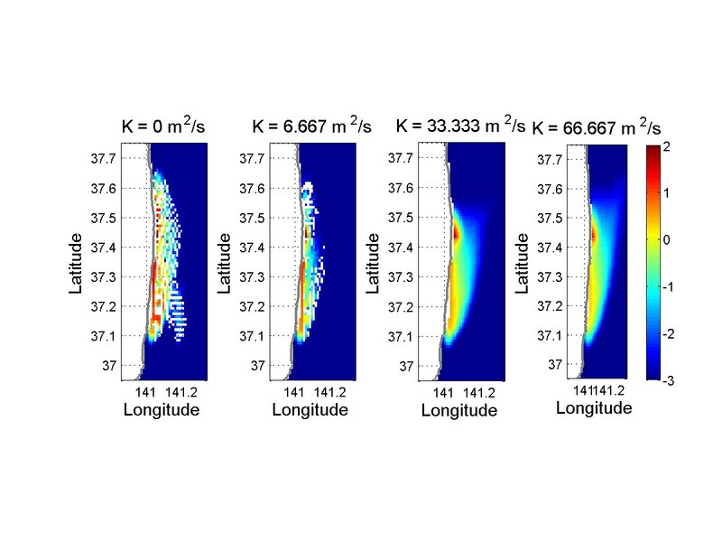

I have done an extensive series of experiments and here is what I found out (at least for my application) :
1. If I use MIX_GEO_TS with TS_DIF2 (or TS_DIF4), ROMS is unconditionally unstable! I tried using diffusivity values 0 <= K <= 100 m2/s and with time steps dt, dt/3, dt/5 and in all cases, ROMS blows-up almost immediately (first 3-10 time steps either from a cold start or a hot start/restart) with the exception of K=0. For K=0, the model is stable for dt, dt/3, dt/5 and runs indefinitely but the passive tracer has +/- values both in time and space and are so bad that the numerical solutions are practically unacceptable. For my application, dt=15s and NDTFAST=60 (I also tried values 20-60 and get the same result). I also tried using the experimental ROMS CPP option MIX_STABILITY but it did not help either.
2. Out of sheer desperation, I used MIX_S_TS with TS_DIF2 and then repeated my runs for 0 <= K <= 100 m2/s with dt=15s. In all cases, the model is stable and does NOT blow up!!! I do not need to cut down dt to get the simulations to be stable. Furthermore, I have looked at the results and the diffusivity acts in the expected manner - the more diffusivity the more smooth the solutions are (even if they are unphysical) and the less smoothing the more osciallatory (in space and time) they are.
Please see the attached plot. The grey line is the coastline. I have plotted the passive tracer field (at the surface) using a Log10 scale for improved clarity and when tracer values are negative, I set them to NaN before taking the Log (in Matlab). So negative values (to the right of the grey line) appear in the plot as white pixels and non-negative (i.e. positive) values have various colors. As you can see, the negative values disappear with increasing K and I have confirmed this to be true by examing the full 3D x time passive tracer fields. [In the plot, I chose K=0, 6.667, 33.333, 66.667 m2/s because my dt=15s, dx=dy=1000m (approx) and so mu=K*dt/(dx*dx)=0, 1 x 10^-4, 5 x 10^-4, 1 x 10^-3]
So it appears that there is a problem with the Geopotential horizontal mixing in ROMS and it renders the whole kernel unstable (at least for my application were there is realistic T, S stratification). On the otherhand, the classical Sigma-surface mixing works well and in the expected manner but we know that it adds an artificially large amount of smoothing.
Could this possibly be a formulation problem or a bug in the ROMS Geopotential horizontal mixing algorithms?

I routinely use MIX_GEO_TS - it's fine. That is not your problem.
How are you controlling nonlinear instability in momentum? With MIX_S_UV or a horizontal momentum advection scheme that dissipates the short wavelengths?
As I was mainly interested in simulating a passive tracer, I wanted to minimize the "damage" I would do to the numerical solutions by introducing "numerical/articificial" viscosity and diffusivity. So what I did was :
1. For tracers, I used TS_DIF2 and MIX_S_TS (as MIX_GEO_TS gave blow-ups) and used diffusivity only for the (single) passive tracer - hence, in ocean.in, I had TNU2 == 0.d0 0.0d 33.333d0 (TNU4 == 3*0.d0)
2. For momentum, I did nothing - i.e. I did NOT define UV_DIF2 or MIX_GEO_UV or MIX_S_UV or any such option.
