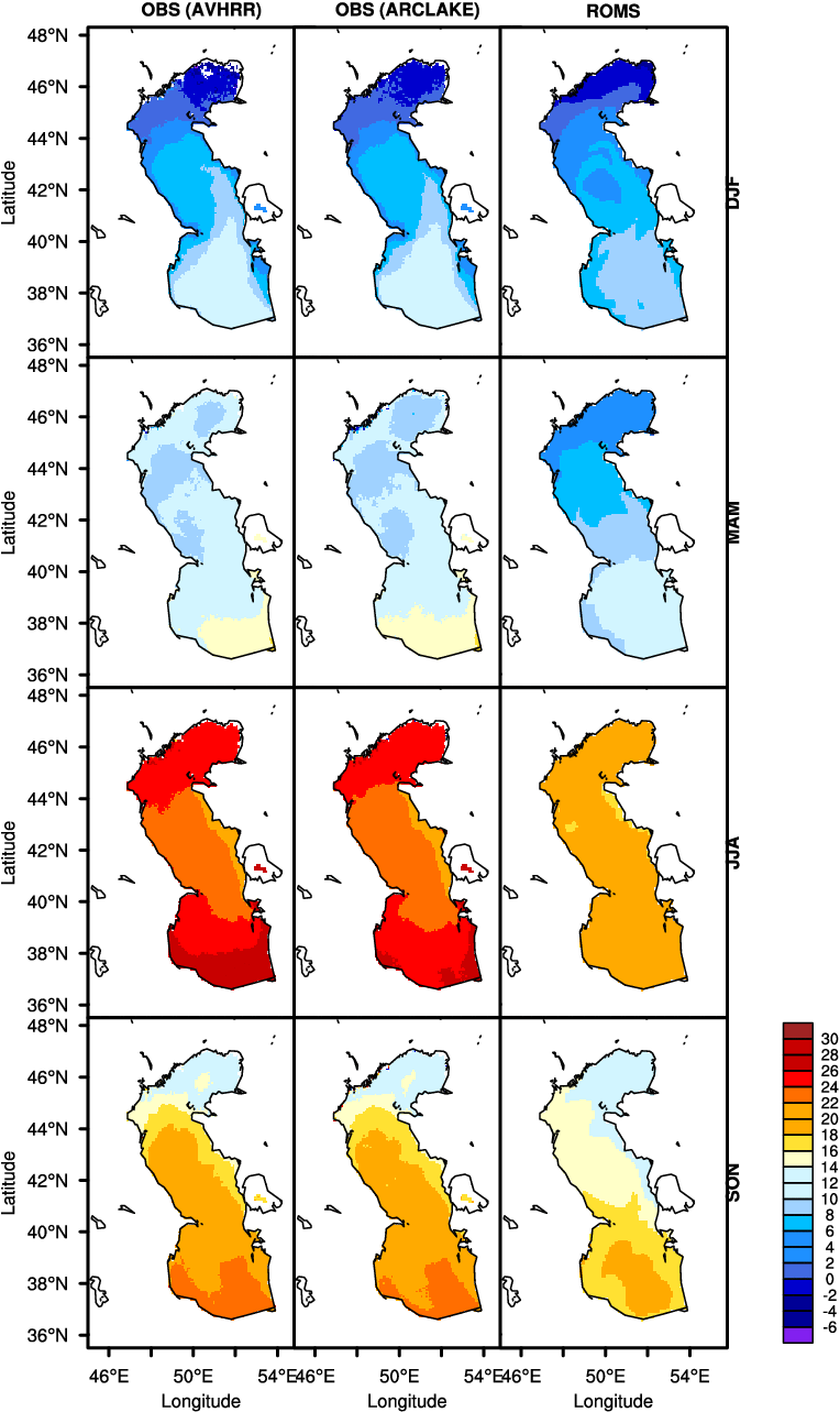

Thanks for the clarification. Now, it is much more clear for me. I also did some tests using NCEP/NCAR Reanalysis after fixing the calculation of the net fluxes but the model is still cold in almost each season after 10 year simulation. In this case, the same forcing is applied perpetually. You can see from the attached plot. Now i will try to use different datasets such as NNRP2, ERA40 and ERA Interim to compare the results. I saw a paper for same region that the flux variable are multiplied by 1.05 to get realistic results from their ocean model (HYCOM).
Sea Surface Temperature (AVHRR vs. Model)

Have you tried as Kate proposed? You could use only downward flux instead of net, for that you just need to insert flag LONGWAVE_OUT on your cppdefs file. Would be interesting to see how it compares to the run you just showed.
turuncu
Posts: 129
Joined: Tue Feb 01, 2005 8:21 pm
Location: Istanbul Technical University (ITU)
Re: Which heat fluxes to input when using bulk formulation?
#17 Unread post by turuncu »
Yes. I have already done that test. Actually this results belong to it. The lake is much more warmer than this when i used the net longwave and net shortwave (without LONGWAVE_OUT) but i don't know why it is colder in this case.
--ufuk
