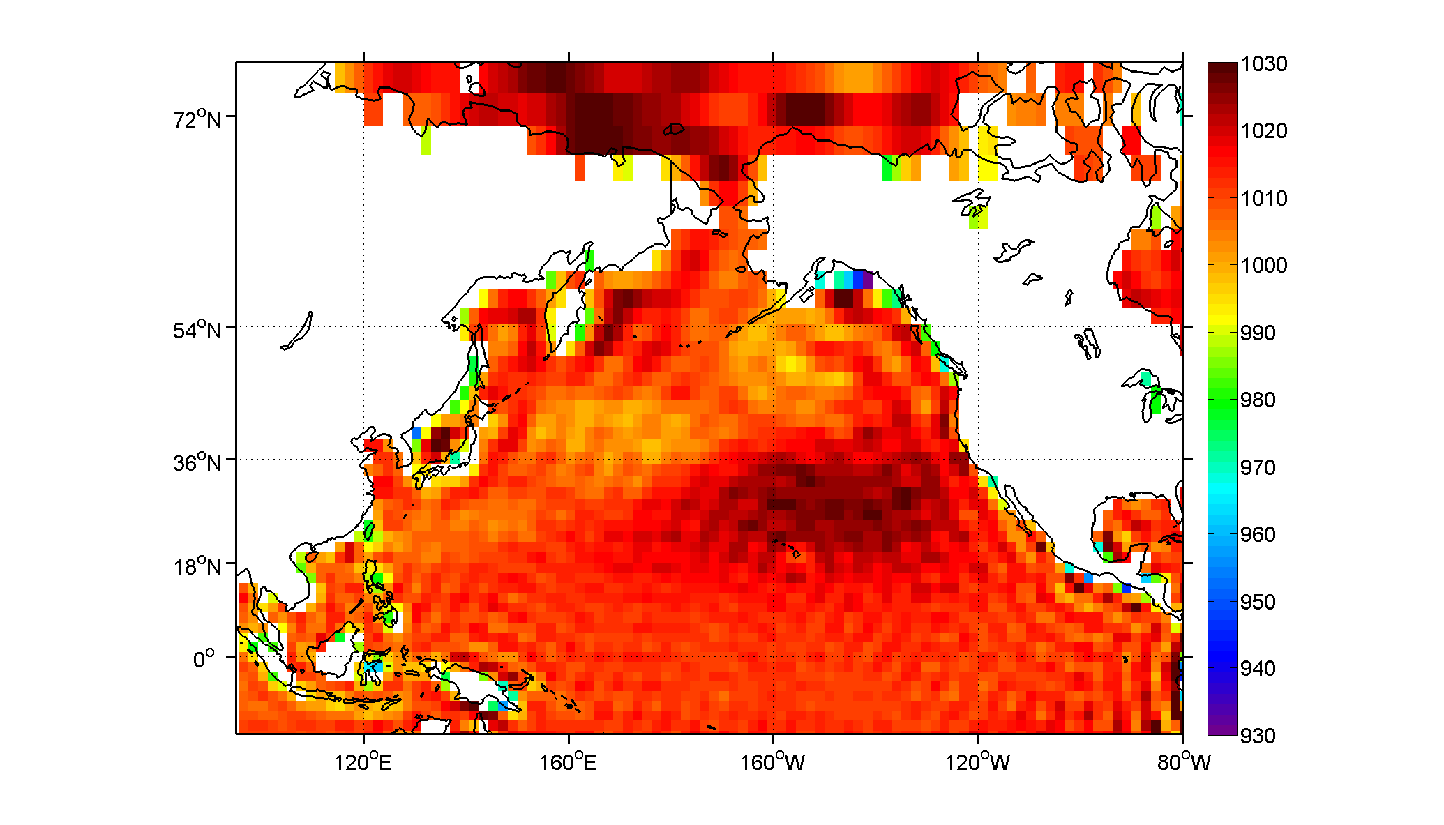

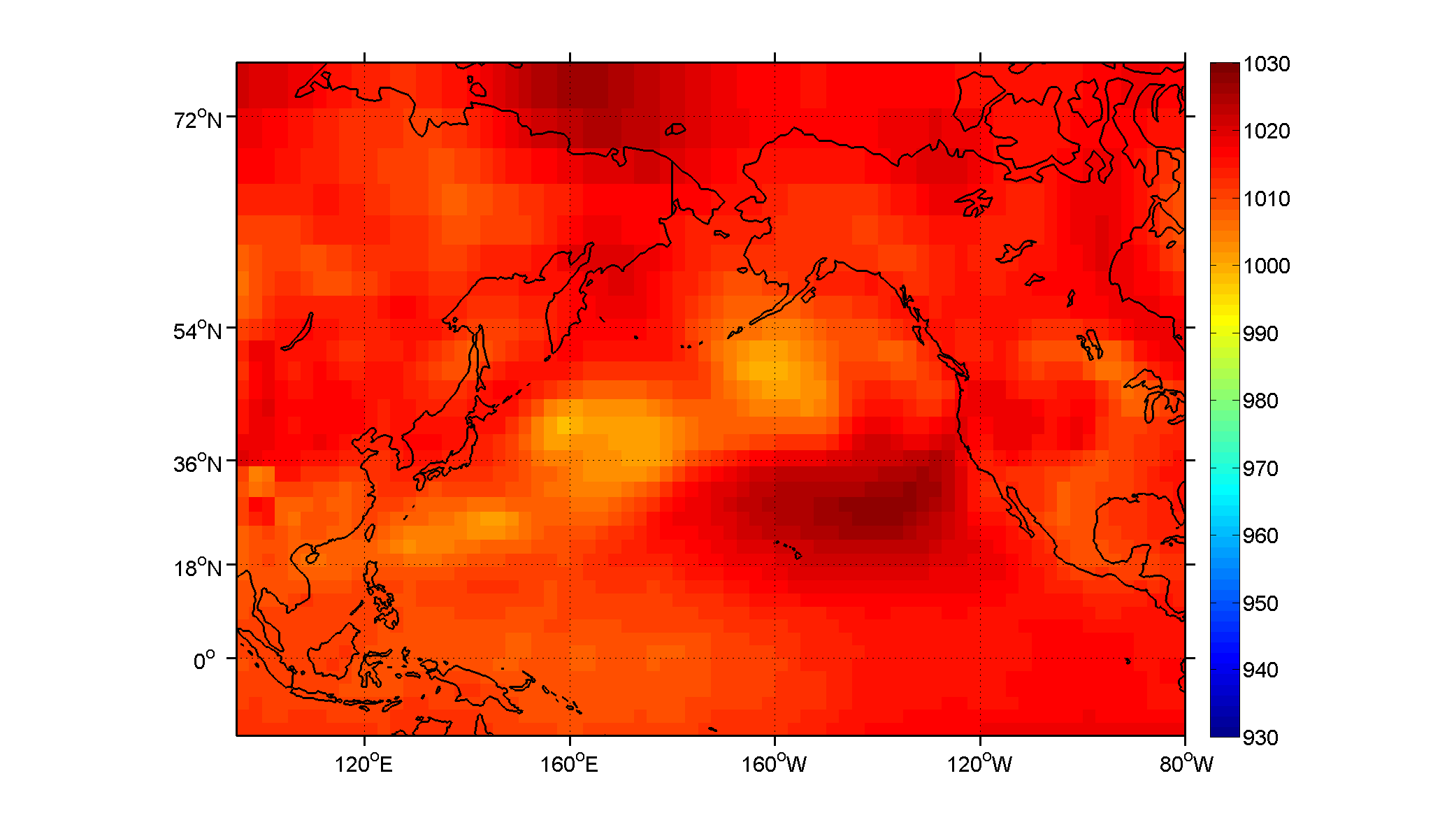

I downloaded sea level pressure and surface pressure from NCEP reanalysis version 1.
I plotted same time step of both dataset(see attached)
The general features of the ocean looks about the same although there is a small wave like motion in the surface pressure.
Significant differences occur in the land area especially in high altitude area.
The press_sfc_mask_2010 figure denotes surface pressure data in the ocean.
We can see there is a difference between sea level pressure and surface pressure in the coastal area.
I looked up the bulk_flux.F file and found that Pair affects not only heat flux but also wind stress calculation.
Therefore, if one have to use the surface pressure data especially near the coastal area with high altitude such as Taiwan, Vladivostok,
Gulf of Alaska, they'd better convert it to sea level pressure.
