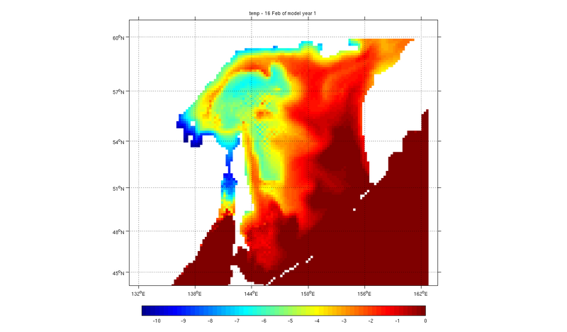

Dear ROMS users,
I've got a same problem which Mr.Lanerolle had mentioned above. My domain is including the Okhotsk basin which is cold area
and the air temperature goes down below -10 degree celcius in winter(especially on February).
And then I got a unphysical sea surface temperature value which is lower than -10. degree.(see the attached picture)
I used NCEP 2m air temperature, sea level pressure, 10m wind and solar radiation for calculating the heat flux via bulk formula.
Any recommendation would be great.

susonic
Posts: 170
Joined: Tue Aug 21, 2007 5:44 pm
Location: UST21 / Korea
Re: Good fix for issue with Bulk Flux in ROMS
#6 Unread post by susonic »
Hi Mr.Liu,
Thank you for your reply.
What do I need to do if I want to consider the sea ice effects?
Do you mean that I should turn on the ICESHELF cpp option if I want to consider sea ice effects?
Thanks in advance
-Peter

The reason I came up with the fix for Bulk Flux was because it is known that the upper region of my domain (Chesapeake Bay) where water temperatures were going well below 0 C (in the ROMS application) is NOT known to freeze regularly and hence NOT produce ice.
So I think it is important for you to verify (from obervations) whether parts of your model domain freeze and produce ice shelves and what the extent of this freezing is. The ice model should only be used if it is known that your domain does indeed contain ice/freeze. Otherwise, you will have to use a fix in the Bulk Flux model to prevent water temperatures from going below freezing temperatures (depends on S). If you use the ROMS ice model without having this info, you may end up generating too much/too little ice relative to observations which is unphysical.

The ICESHELF option is just that - a fixed ice shelf. It is not dynamic or thermodynamic sea ice.
It's important here to keep in mind Lyon's comment that in the upper Chesapeake Bay sea ice does not form, yet ROMS with the COARE bulk formulae and atmospheric boundary layer and radiation analyses from NCEP cause unnaturally low below freezing sea temperatures. So this is a failure of the bulk formulae or the atmospheric data, or both.
Lyon's fix, to essentially limit the cooling with a switch that shuts off further cooling, is a reasonable kluge. The fact he knows for sure is that the water does not freeze, so limiting the minimum temperature at least treats the symptom, if not the actual malady. If you adopt this approach I suggest that heroic efforts to make the freezing point salinity dependent are probably not required since you are making such a large and abrupt change to the effective bulk formulae. It's also important to allow warming to occur to recover from the situation, so be careful not to shut of the solar heating.
