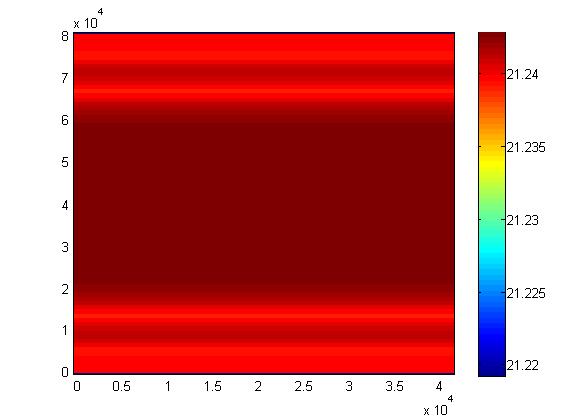

So I can say input grid file is in the .in file and grid is specified in ana_grid. I am not clear about the following line
If your grid is specified in ana_grid, then you need to be sure you are writing the grid to the output.
Anyway, even with the masking error i continued to follow your prescribed commands
>> file = 'ocean_his.nc'
>> g=roms_get_grid(file,file); % the grid structure
>> s = 0.1;
>> roms_zview(file,'temp',1,-5,g,3,s,'k')
and get an matlab figure. But not sure about the acceptability. Is it possible to post some output figure considering upwelling test case in this thread or in your url http://romsmatlab.tiddlyspot.com/? So that we the new users can crosscheck.
Rouf
rouf

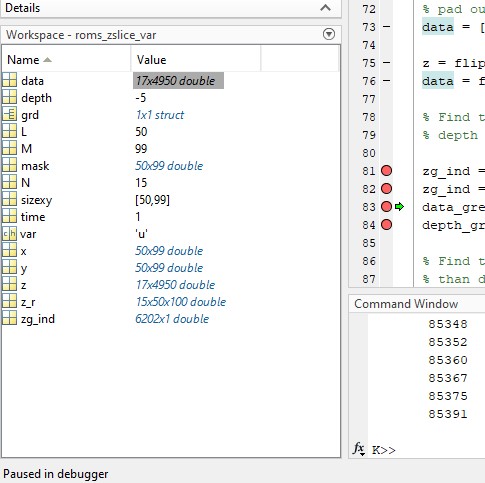

Sorry, I forget to inform the following error messages that i get after roms_zview command. There is a output figure, but seems not the actual output figure.
>> roms_zview(file,'temp',1,-5,g,3,0.1,'k')
??? Reference to non-existent field 'mask_u'.
Error in ==> roms_zslice_var at 44
    mask = grd.mask_u;
Error in ==> roms_zslice at 64
[data,x,y] = roms_zslice_var(data,1,depth,grd);
Error in ==> roms_zview at 217
      u = roms_zslice(file,'u',time,depth,grd);
Looking for kind help

From your last message it is hard to tell what success, if any, you are having. You say
Please show me what figure you get. (Use the upload attachment panel to include it in your posting.)
Your last error message (I am pleased to see they are progressing) suggests using the option to plot velocity vectors is now seeking masks at u,v points that are unavailable. So I have further modified roms_get_grid to create null masks for all of u,v,psi in the case there is no mask information in the grid or output file.
I'd like to return to one other of your comments:
ROMS can't be doing both, so which is it? Are you giving grid information by a netcdf grid file (via input GRDNAME in ocean.in), or are you using ana_grid.h . The standard out (logfile) tells you which ROMS is using. (Just because GRDNAME is set in ocean.in does not mean ROMS is using that, so please answer accurately).
rouf

#15 Unread post by rouf »
Dear Wilkin,
Please find the attached file.
In terms of running upwelling test case in ROMS, I didn’t modify anything except following running ROMS under the tutorial installing ROMS in windows XP via Cygwin. I am not sure about the term standard out (logfile), but I check the upwellingout.dat file (which I get by running ROMS). At the end of that file, it mentioned that ana_grid.h is used as Analytical header files. So I suppose ROMS use ana_grid.h here.
Looking for your comments
Rouf

This is correct! The problem here is that you don't know how the upwelling test case looks like. Neither you are reading the information provided correctly. There is a sample of the upwelling plot in :arrow: wikiROMS. The upwelling test case is horizontally uniform :idea: You need to plot cross-sections instead :!:

Your plot looks correct, Did you make it with my roms_zview or not?
As Hernan points out, with UPWELLING you will get more informative plots if you make cross sections such as with roms_iview.m.
rouf
Re: roms_matlab plotting and analysis routines
#18 Unread post by rouf »
Thanks Wilkin. Yes I made it with your roms_zview. I also make figure with your roms_iview. It seems ok. I am actually new in this field. But all of your cooperation is helping and incisting me to go forward.
Rouf

Dear Wilkin and rouf
I had the same error that rouf said when i used roms_get_grid Function, I am actually new in using ROMS,
When I run these two commands:
file = 'ocean_his.nc';
g will not return any value, and the errors are:
file =
ocean_his.nc
Warning: Variable not found: mask_rho
> In roms_get_grid at 57
  In plot_upwelling at 3
Warning: Variable not found: mask_psi
Warning: Variable not found: mask_u
Warning: Variable not found: mask_v
Warning: Variable not found: h
Warning: Variable not found: angle
??? Reference to non-existent field 'h'.
Error in ==> roms_get_grid at 59
        grd = setfield(grd,vname,zeros(size(grd.h)));
Error in ==> plot_upwelling at 3
g=roms_get_grid(file,file); ; % the grid structure
I use the latest version of the roms_wilkin matlab tools form https://www.myroms.org/svn/om/matlab/roms_wilkin, The Revision 372,and my roms's version is 3.0. I ensured ocean_his.nc is in right path, also found by using ncdump command that my ocean_his.nc has no mask_rho, mask_psi, mask_u, mask_v and angle information,the grid maybe specified in ana_grid. I didn’t modify anything In terms of running upwelling test case in ROMS.

Location: Morgan State University
#62 Unread post by cfan608 »
Wilkin, thanks for the reply. Here is the debug results:
the line 71 is the reshape statement for z, before line 71, the size(z) is:
>> size(z)
ans =
17 43 82
after the reshape statement, size(z) becomes
size(z)
ans =
17 3526
[/color]
at then at line 78, all variables gone!
??? Error using ==> vertcat
CAT arguments dimensions are not consistent.
Error in ==> roms_zslice_var at 78
z = [-Inf*ones([1 L*M]); z; zeros([1 L*M])];
and if I comment out the line 78, here is the result:
>> roms_zview(file, 'temp', 2, -5, g, 0.2, 'k')
??? Index exceeds matrix dimensions.
Error in ==> roms_zslice_var at 91
data_greater_z = data(zg_ind);
Error in ==> roms_zview at 157
[data,x,y,t,grd] = roms_zslice(file,var,time,depth,grd);
thanks for your help.

now i want to your help,i want to plot mesh with topography,my code is
lat=ncread('estuary_his_0008.nc','lat_rho');
lon=ncread('estuary_his_0008.nc','lon_rho');
m_proj('miller','lon',[117 134],'lat',[15 43]);
m_grid('linestyle','none','box','fancy','tickdir','in','xtick',117:4:134,'ytick',15:4:43);
m_gshhs_i('patch',[.6 .6 .6])
hold on
addpath('J:\east\east preference\ROMSprocess\');
file=('G:\mysoftware\bin\delft2roms\case2\smooth_east_grd3_728.nc');
grd=roms_get_grid(file);
roms_plot_mesh(grd,1,[0 0 0],'rho');
but my figure is
Posts: 938

Hi again
I have successfully plotted the upwelling case, but now I want to plot it at a different times and even set up a bunch of times to be able to animate them. Can someone point me in the right direction in terms of the wilkin routines or otherwise?
hclarke
Posts: 22
Joined: Sun Dec 04, 2016 1:03 am
Location: UTAS
#89 Unread post by hclarke »
Hi again
I've used:
>> roms_iview(file,'temp','1-Jan-0001',1,g,1)
then compared the plot with:
>> roms_iview(file,'temp','6-Jan-0001',1,g,1).
I've attached the figures. Is this what I'm supposed to be seeing? There is distortion to the left of the latter plot. Is that the upwelling?
Upwelling figures.docx
(56.84 KiB) Downloaded 5796 times

and I get the shown the following error :
Index exceeds the number of array elements (84150).
Error in roms_zslice_var (line 83)
Error in roms_zslice (line 81)
Error in roms_zview (line 177)
data = roms_zslice(file,var,time,depth,grd);
This is the only function I face error with. As per the TiddlyWiki website in which you maintain these routines, it's written " Produces a pcolor plot of the requested VarName at constant depth. If requested, velocity vectors are plotted over the image according to the inputs Vec_d, UScale and varargin." And the depth parameter in the function says that it's depth in z direction of a 3D ROMS grid. I don't know where my plot's going wrong in that case. I have a total of 15 vertical levels in my grid file and my model is also a 3D model with the following resolution Resolution, Grid 01: 98x48x7.
Is there some data missing in my his.nc file or grid file ? Or I am doing or interpreting something wrong ?
I am attaching the ncdisp output from my his.nc file for your reference.

#91 Unread post by wilkin »
I have no idea what you have done wrong.
I assume you have tested other options, like plotting different variables than 'u', specifying time as an index instead of a date string, plotting at constant vertical index (instead of z) using roms_sview? Does that tell us anything?
Where you are getting the error, Matlab is finding the index of the z-levels that bracket the -1 m depth you request.
Depth -1 m is shallow and might be less than the depth of the center of the surface cell if your vertical resolution is coarse, but at this point in the code the array it is slicing has already been padded with zeros to ensure that there is a point to complete the interpolation.
You will have to debug this in Matlab. Set a debug break point in roms_zslice_var.m ...
>> dbstop in roms_zslice_var
The run roms_zslice.
Check the inputs to roms_zslice_var in the Matlab command window, in particular size(data) and size(grd.z_u). They should match, and in your case I think they should be [15 50 99] though I could be off by 1. Then step your way down to row 82 where you got the error. Now data should have the vertical coordinate padded and have been be rearranged into a 2-D ribbon of size [N+2 xi_u*xi_eta] so for you [17 4950]. Check everything that's going on in the code there to figure out why you get that error.
By the way, the tiddlywiki page is a bit out of date, but the instructions you quote are still correct. I maintain this code now on github at
https://github.com/johnwilkin/roms_wilkin
neelbasak08
Posts: 99
Joined: Wed Dec 09, 2020 3:58 pm
Location: Thapar Institute of Engineering and Technology, Patiala, PN, India
#92 Unread post by neelbasak08 »
Thanks Mr. Wilkin,
Yes, I did test some other variables like ubar in roms_zview but I believe it's a 2D parameter therefore having depth was no sense there and MATLAB plotted the results anyways. Yes, the roms_sview worked fine with date input as a string.
I followed your debugging suggestion. It seems that my data attribute has a dimension 17x4950 and my error causing parameter zg_ind has a dimension of 6202x1. May be that's why the indexing error might occur. But I am sure what might be causing these varied dimensions ?
Rest all parameters look pretty fine as per what you had suggested like z attribute was of the size 17x4950 and z_r attribute was 15x50x100.
Attaching the workspace values for reference.
Kind regards
-Neel
workspace details during debug
Screenshot 2021-04-01 190344.jpg (49.89 KiB) Viewed 2265173 times

#93 Unread post by wilkin »
Have you inadvertently edited any of the roms_wilkin code?
Is it up to date?
Maybe send a small version of your output file for me to look at. Not all 172 records. Just a couple.
neelbasak08
Posts: 99
#94 Unread post by neelbasak08 »
Thanks Mr. Wilkin for your reply !
Earlier I'd been using the version I had downloaded via svn though I hadn't changes anything in that and ran it command line just. And I am sorry I didn't read the part in one of your previous posts mentioning that now you maintain it in your git repository. I was more focused on the debugging checks that you had suggested. So I downloaded the git version and tried if i were any successful but alas! no. The same problem seems to persist and the debug produced pretty similar results like the earlier one.
I failed to understand the part where you said " Maybe send a small version of your output file for me to look at. Not all 172 records. Just a couple." By output file you meant the history .nc file I believe. I am attaching it for your reference. It has only output for an hour of simulation.
Kind regards
-Neel
Lombok_roms_his.nc
output his.nc file
(14.3 MiB) Downloaded 5664 times
Posts: 938
#95 Unread post by wilkin »
The issue is that your grid has bathymetry values h < 0 and roms_get_grid is calculating z_r etc. values that are not monotonic.
roms_zslice_var uses the tests:
zg_ind = find(diff(z<depth)~=0);
and
zl_ind = find(diff(z>depth)~=0);
as the basis of the logic to find the k indices immediately above and below the slice depth.
With a non-monotonic z coordinate these are multivalued and the resulting index vectors exceed the dimension of the grid.
I can't believe no one has ever struck this problem before. I thought my code was robust to h < 0 in the land mask. In fact, I'm sure I've worked successfully with such girds before.
I don't have the time to check, but it may be that you have very large negative h values, and a very strongly stretched coordinate (theta_s = 8, theta_b = 4), and this combination is perhaps producing the non-monotonic z coordinate.
I suggest you modify your grid file to make h in the land mask some benign small positive value. It will make no difference to the ROMS solution.
Meanwhile, I'll think of what logic I need to add to trap this case.
Posts: 938
#96 Unread post by wilkin »
I have modified roms_zslice_var.m to reset all z to equal 0 on land.
If you update from github https://github.com/johnwilkin/roms_wilkin you should be able to plot from the output files you already have.

Thanks a lot, Mr. Wilkin!
I updated the code from GitHub and it works just fine. Again another thing I wanted to confirm is that the documentation of these routines is the same as the one in TiddlyWiki right?
