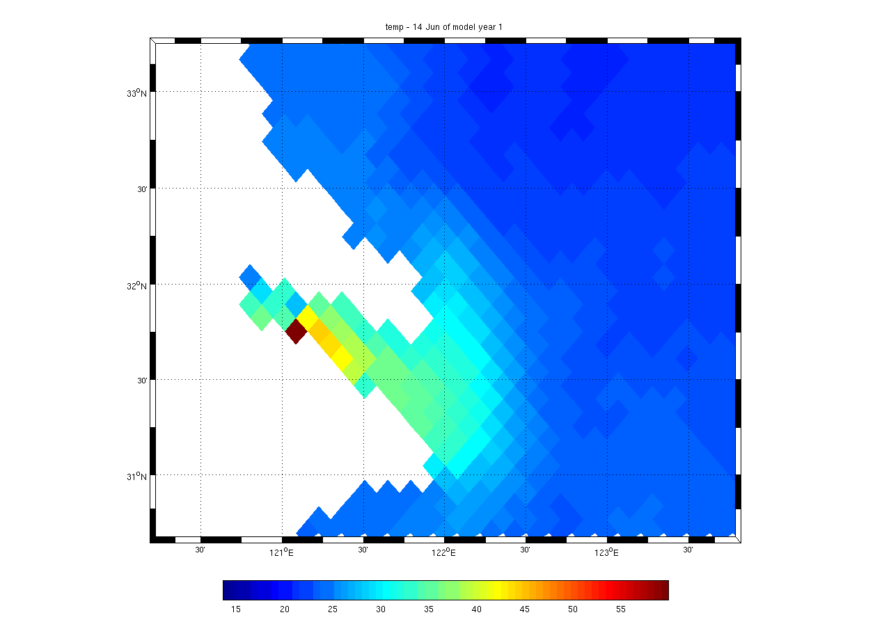

Hi, all

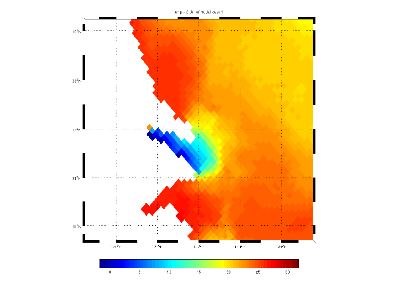

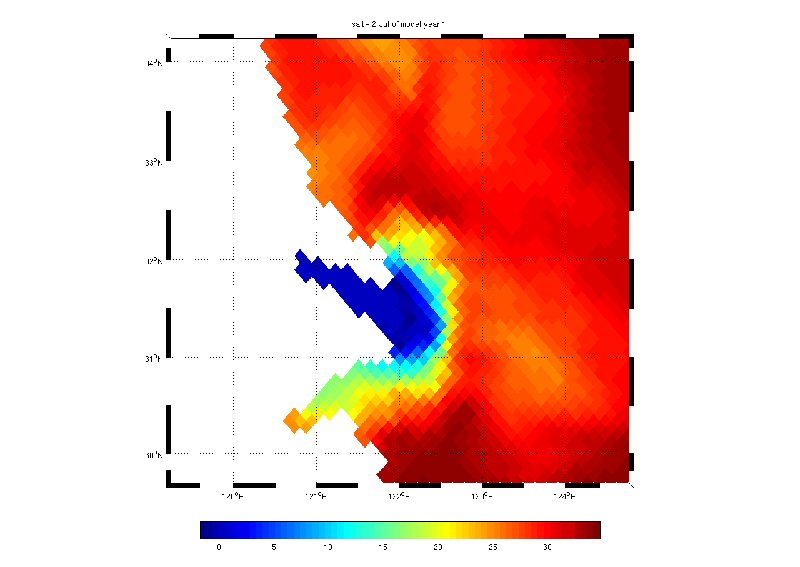

I'm trying to represent the river plume model which has a large discharge with uv_psource & ana_psource defined on cpp flag. The discharge varies 10000 upto 60000 ms-1. The size of delta x is approximately 11 km. At first, when I put the tidal forcing together with river, every thing was fine. However, once I ran the model without tide, I got high temperature when the amount of discharge is getting larger. At that time, I put only one river point source. I was thinking only one river point is not able to run off such a large amount of discharge. Hence, I tried to devide the discharge by three and put them in each grid point as a point source. Yet I still get the high temperature and it blow up when it is above 50 degree celcius on both cases.
I also tried Q_psource with ana_psource instead of using UV_psource with ana_psource. It looked fine at first but eventually the problem arose again. At this time, I got low temperature around -2 degree celcius instead of high temerature. By the way, the model didn't blow up until the end of set up time. The value of salinity in all cases were fine and they were reasonable. I don't know why I'm getting high/low temperature in my model.
Would you help me out please? I attach the pictures of my result.
Thanks in advance.
Regards,
-Peter
Thanks in advance.
Regards,
-Peter

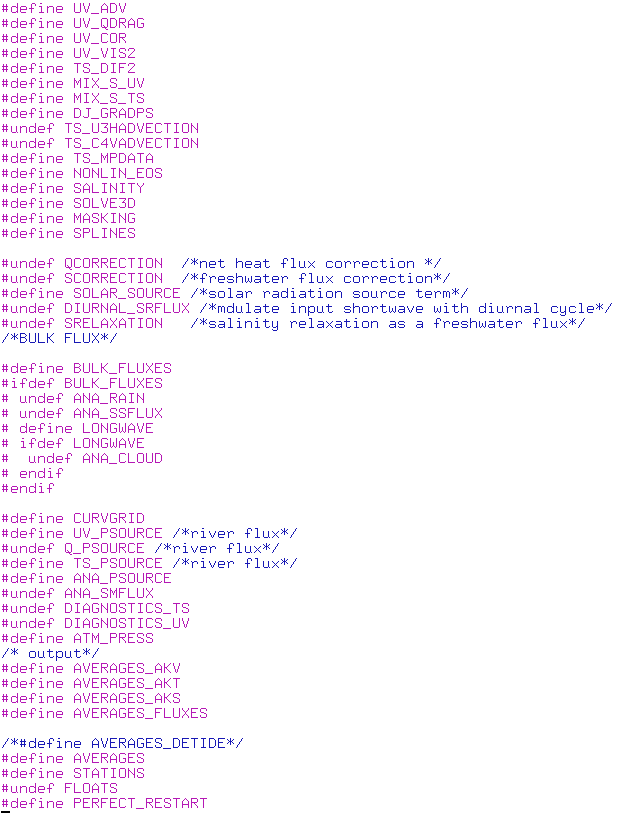

Hi warner,
Thank you for your reply. I'm using default uv_advection scheme and u3h c4v for TS.
I attached again with png format.(sorrry and thanks)
I'm going to use the mpdata and will report the result here.
FYI, it has wrong spell in mpdata_diff.F on 19th line.
Regards,
Regards,
Re: Point source definitions
what did you mean by
"FYI, it has wrong spell in mpdata_diff.F on 19th line."
What is the text on that line, and what is wrong?
thanks
thanks

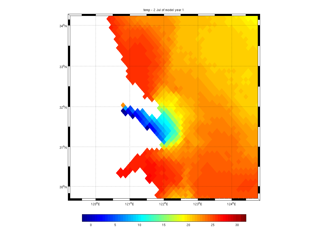

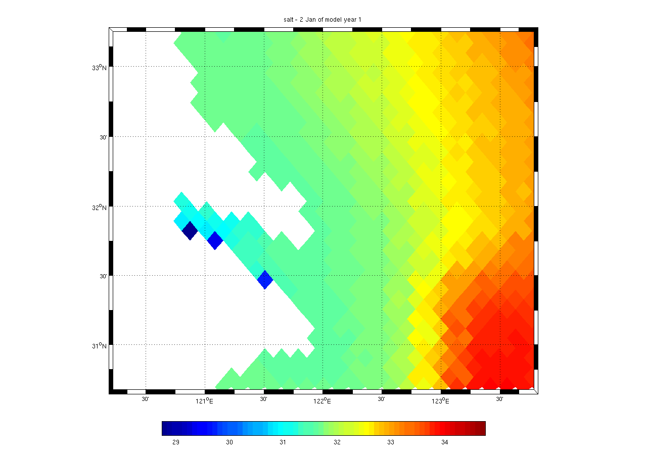

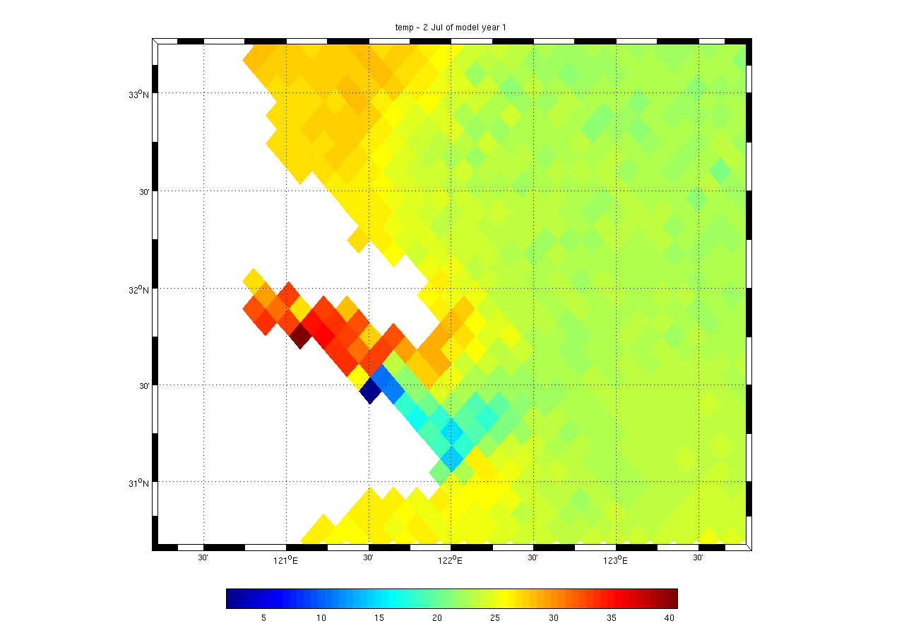

Well, it's not a big deal. I underlined the character in figure(see below).jcwarner wrote: What is the text on that line, and what is wrong?
Even though I'm using a mpdata, I'm still getting weird value.
This time, it has both hot water and cold water at the same time.
Actually, I had run my model several time without using mpdata and sometimes I get
good result(reasonable result) but other times I got some weird value such as hot water
or cold water. I also attach my ana_psource file. The discharge varies 10000 upto
60000 ton/sec. What seems to be wrong? Please help me out.
Regards,
ana_psource.h
- (15.51 KiB) Downloaded 904 times
- spell.png (10.09 KiB) Viewed 29778 times
1) where are these points on the grid and which way is 'xi'?
Are they flowing in the correct direction?
#elif defined ECSY10
Nsrc=3
Dsrc(1)=0.0_r8
Isrc(1)=61
Jsrc(1)=84
Lsrc(1,itemp)=.FALSE.
Lsrc(1,isalt)=.TRUE.
Dsrc(2)=0.0_r8
Isrc(2)=62
Jsrc(2)=82
Lsrc(2,itemp)=.FALSE.
Lsrc(2,isalt)=.TRUE.
Dsrc(3)=0.0_r8
Isrc(3)=63
Jsrc(3)=77
Lsrc(3,itemp)=.FALSE.
Lsrc(3,isalt)=.TRUE.
2)Did you try to make the Lsrc(*,itemp) to be .true.?
3) Does this flow go negative or is it always positive?
# elif defined ECSY10
fac=1.0_r8
Nsrc=3
omega=2.0_r8*pi/365.0_r8
amp=30000.0_r8
NsrcEach=1.0_r8/3.0_r8
DO is=1,Nsrc
Qbar(is)=(fac*((amp*(-sin(omega*(tdays(ng)+78.0_r8)))) &
& +32000.0_r8))*NsrcEach
4) maybe try without all the bulk flux stuff on. See if it just works ok with only rivers.
(*** i am just thinking of any quick issues that i see***)

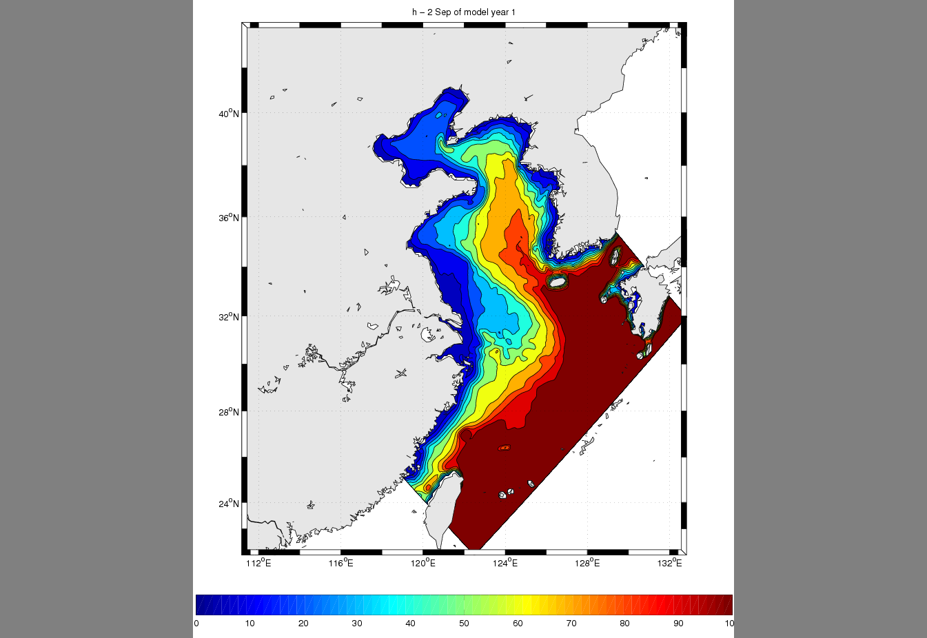

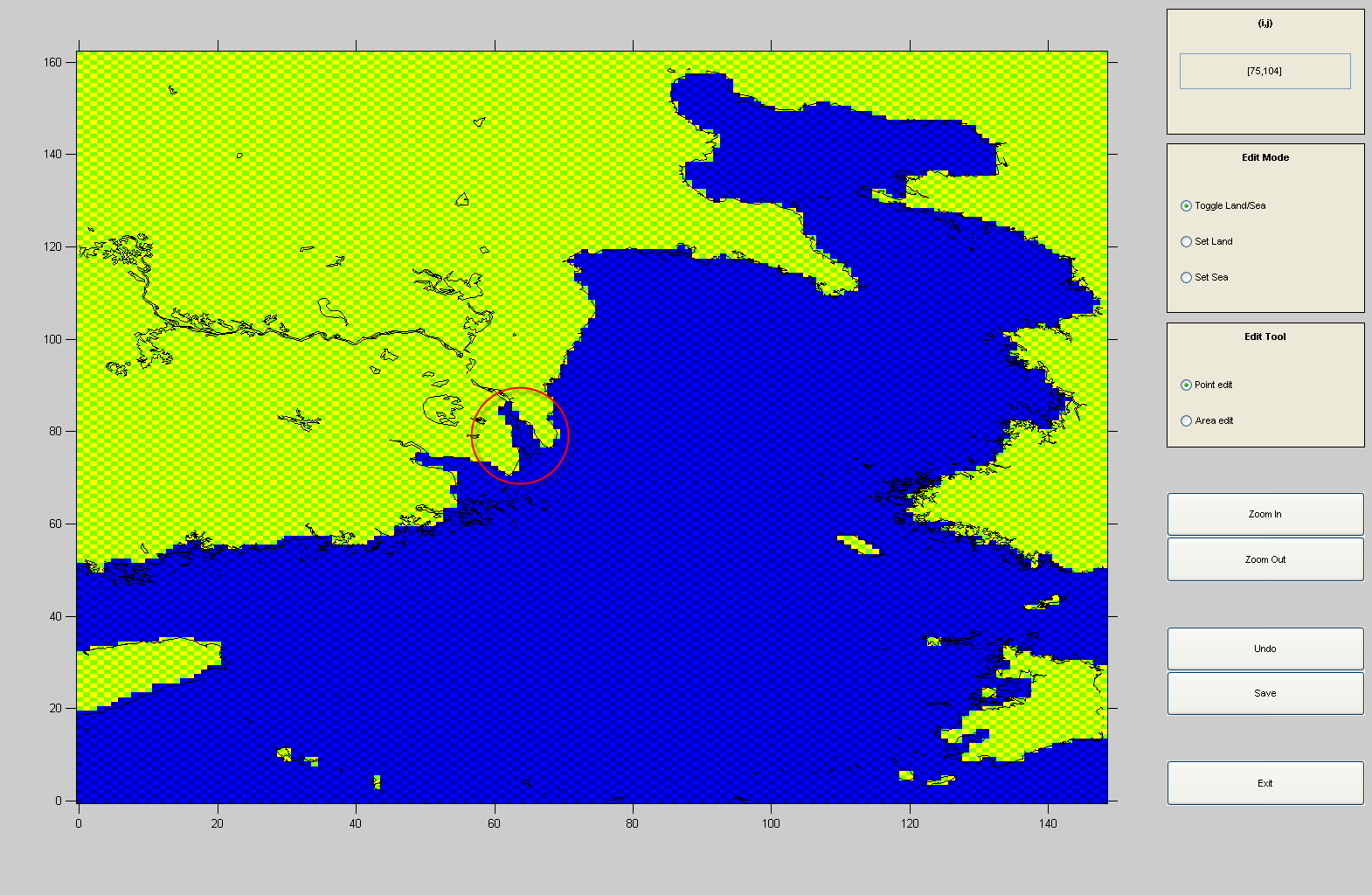

My domain is rotated so the xi direction would be rotated anticlockwise 40 degree from its original direction.jcwarner wrote: where are these points on the grid and which way is 'xi'?
And also if you see the above figure, named river_point, you can see the three blue points.
Those are river flux points.
No, not yet. I don't want to give the temperature value because I don't have the value of temperature.jcwarner wrote:Did you try to make the Lsrc(*,itemp) to be .true.?
Not always. Sometimes without any problem but othertimes it goes below zero/extremly high temperature.jcwarner wrote:Does this flow go negative or is it always positive?
I also tried to run it with undefined BULK_FLUXES but I got the same result.jcwarner wrote:maybe try without all the bulk flux stuff on. See if it just works ok with only rivers.
All I can tell you by
is its related with the wind direction. I could see when the wind is strong and the river is getting larger, the temperature is going down or up. Maybe I need to devide more river point sources?susonic wrote:sometimes I get
or cold water.
Thank you for your quick replies.
Best,
-Peter
1) "My domain is rotated so the xi direction would be rotated anticlockwise 40 degree from its original direction.
Those are river flux points."
I can not tell exactly where they are.
Load the grid in matlab and plot those locations.
Be careful, in that matlab indexing starts with 1, but roms indexing can be different.
2) try to run it with a const T at those locations, say 20 .
3) plot a time series of veolcity at those river points.

Thank you Kate and Warner. I'm running the model again under temperature "TRUE" and staion with river point.
I'm also testing with same discharge but more river point source. We'll see what happens.
I'll report the result soon.
I took a few snapshot and attached. I just hope that this is what you want.
Regards,
-Peter
Regards,
-Peter
It took a while for me to fix the high/low temperature with point source erorr.
Now, I think I don't get the weird value anymore. The solution is turn on both the
temperature and salinity flag. I had been doing all the experiments with only salinity value defined
because I didn't know the temperature of my river source.
However, as pointed out by Warner,when I gave the temperature in my river forcing file together with salinity, there was no more high/low temperature in my result! I tested with higher resolution with same domain and it worked without any problem. I also tested it with tide, without tide and tide only cases, and it worked well with all the cases.
In the end, since I don't know the river temperature, I gave the nearest SST value(whole year) to my river temperature ignoring its vertical structure. Although it's not the best solution, the result is resonable.
As, I mentioned above, I didn't always get the high/low temperature with my river even if I didn't turn on temperature(the salinity was resonable). So, I thought the problem might be related with my rotated frame. But when I tried it with unrotated frame, I was still getting high/low temperature in my result when the discharge is getting larger.
Well, I don't think many of you guys had experienced this problem, because my river discharge is kind of unusually high varying 10,000 to 60,000 ton/sec winter and summer, respectively.
