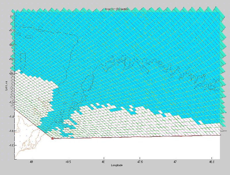

It is said that seagrid can change the space of the grid by change the position of the spacer. I did as the seagrid tutorial, but the spacing is not changing. What's wrong with the seagrid spcaer? Can someone tell me why it doesn't work for me? Thank you very much~

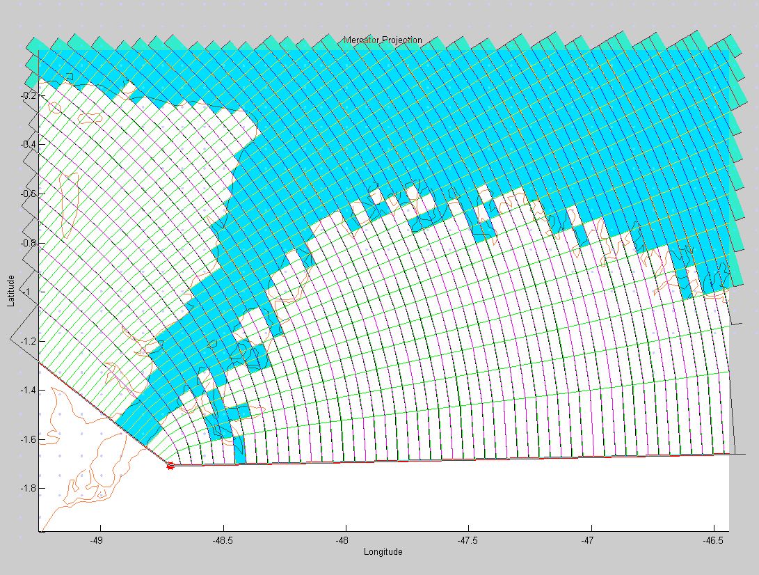

I just tried it, and it works for me. You are supposed to click-and-drag to move the spacers closer or further apart. I had to keep clicking on <toggle>=>refresh to keep the spacers visible, but other than that, it worked okay, and I used it to focus grids toward the center of a test grid as below:

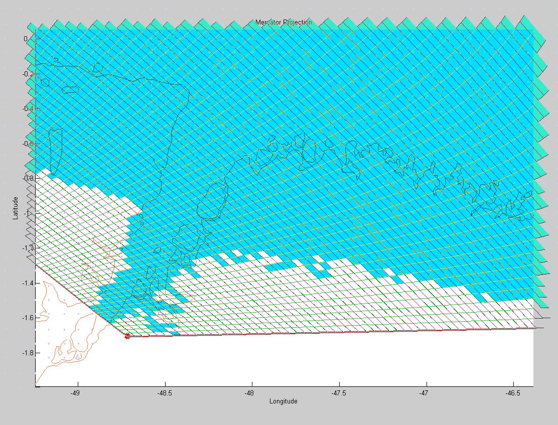

Thank you very much, rich. I know what's the problem. The seagrid that I use is from the RNT toolbox. Maybe it's different or old, so the spacer is not working. I download the one you told me. And the spacer works well. The RNT users should remeber that the RNT seagrid is to some extent different from the latest version. Thank you again,rich.

Yes,it's the land mask computing which cousts a long time. But the seagrid I use is from the RNT toolbox( http://eros.eas.gatech.edu/RNT/ ). Maybe there are some different. I usually load the coastline first, then setup the grids and computing land mask. Finally, adding bathyment and editing land mask.
