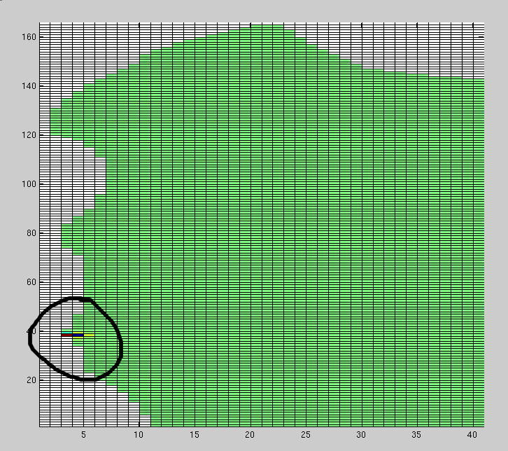

- Posts: 45
- Joined: Fri Feb 06, 2009 5:20 pm
- Location: NNSTU, The Nizhniy Novgorod State Technical University named after R.E.Alekseev, Russia
Re: My seashore test
Without wet and dry ROMS blowing up on second time-step.
With wet and dry ROMS blowing up on fourth time-step.
I many times started the program with different parametres and have noticed that most part of time is spent on Corrector time-step for tracers. And blowing up when kinetic energy becomes more than certain value(~2.0E-2).
No zero in bath, but NaN in vbar and ubar, u and v(((( - Border where is NaN and where is not NaN present for ubar and vbar very strange (look at the picture). NaN in the ubar and vbar where white color.
I attach two restart files with wet and dry and without it. PS my second post without wet and dry;
my third post with wet and dry.
And that can be with SWAN???

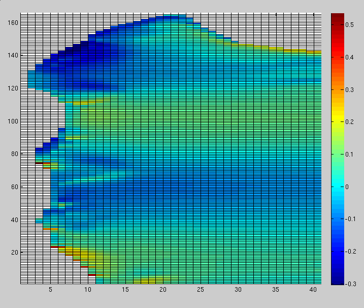

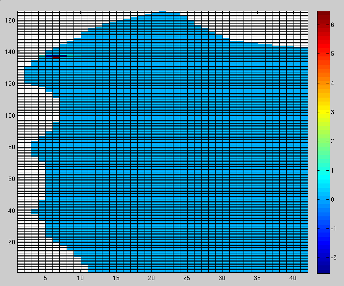

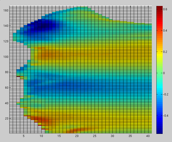

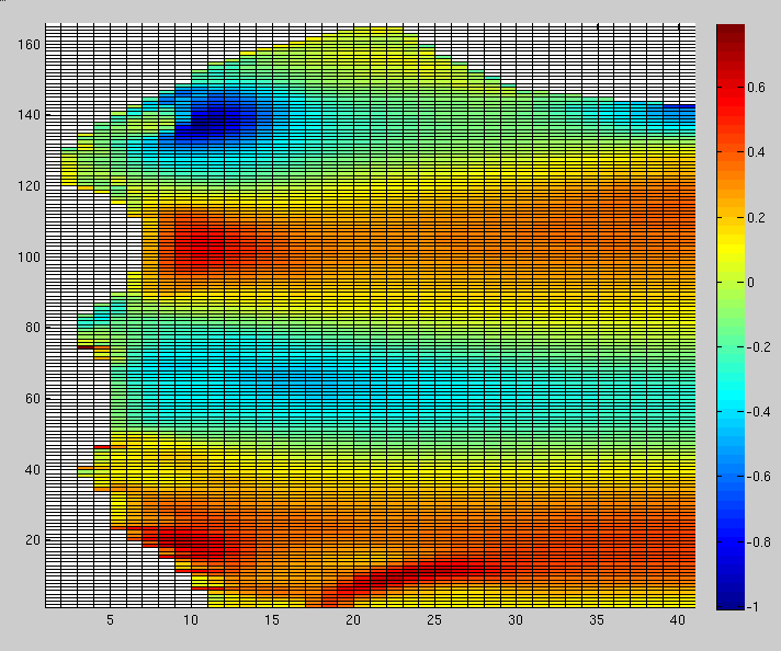

run it w/ wet_dry on, save every time step and see what the history files tell you.
- Posts: 45
If I do Hwave less when 2.0 when kinetic energy becomes less and ROMS work more long.
seashore.log
- Log file
- (21.33 KiB) Downloaded 2086 times
- ocean_his.nc
- History file
- (15.2 MiB) Downloaded 1685 times

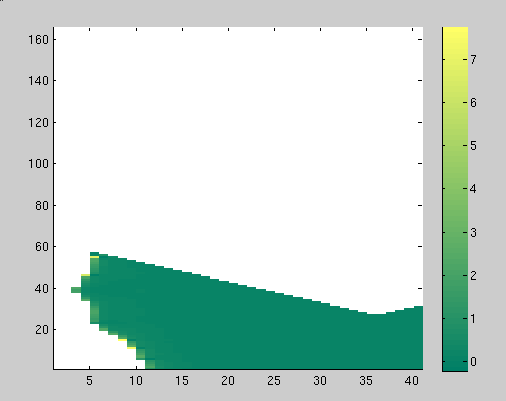

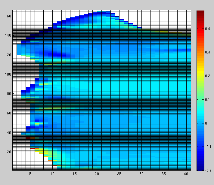

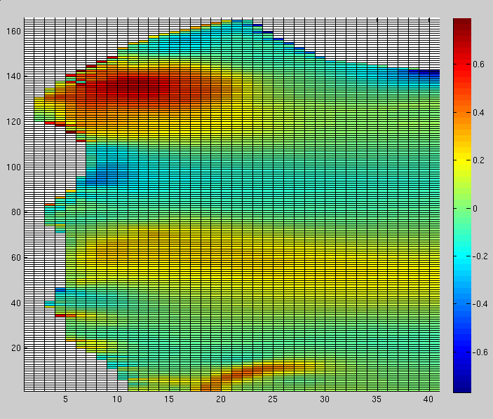

i am looking at the ocean_his.nc file.
There are no values for the x,y, lon, or lat, so I con only pcolor the values of the arrays, not in any spatial sense.
One of the problems is that the wave heigths are rather large, especially in the shallow areas. Typically the ration of Hwave/depth ~ 0.8 maximum (or so). Since you specificy a const Hwave of 2 m, that value is rather large in the shallow regions. So you say that it runs longer when Hwave is reduced. Try Hwave = 0.2 m to start, just to see if it runs.
then we can step to the next problem.

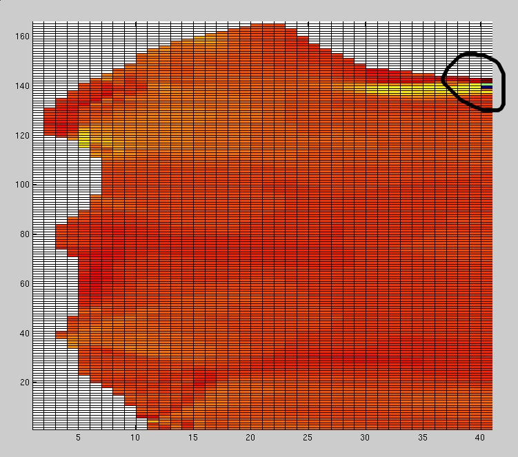

Again blowing up((((
I have noticed the tendency:
At first kinetic energy fluctuates, is then levelled and starts to grow, but then again starts to fluctuate (((

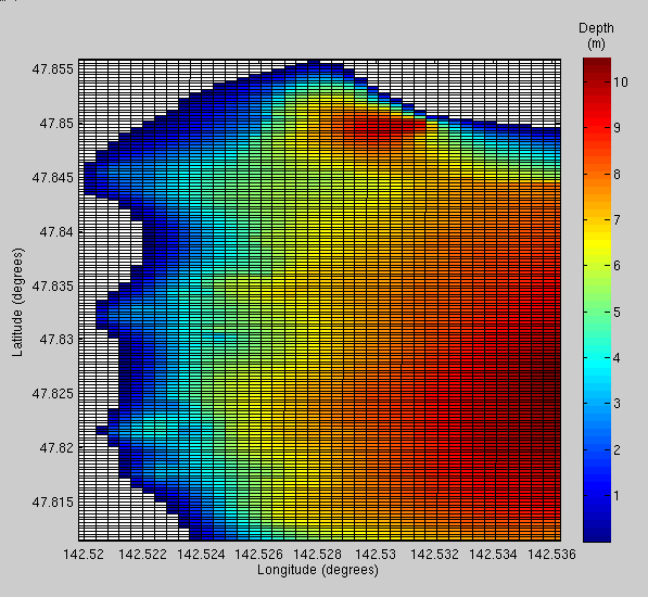

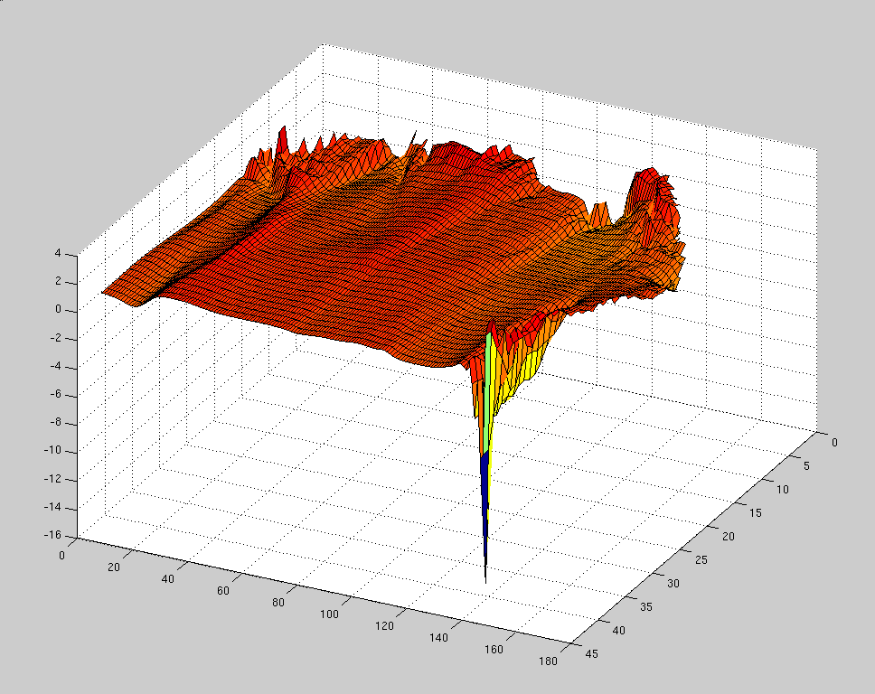

The thing that is wrong with the application is the smoothing of the very high roughness. You had
I would also advise you to check the masks: I recently had a similar problem caused by incoherent mask_u, mask_v mask_rho when using editmask.
If the issue is really bathymetry smoothing I have programs to do this, which is now much faster and available from my web site.
Those are incredibly large value. Maximum rx0 should be 0.2 and maximum rx1 should be 6. Above those values the situation is unstable and here it is the cause of the problem.Maximum grid stiffness ratios: rx0 = 9.926508E-01 (Beckmann and Haidvogel)
rx1 = 2.196218E+04 (Haney)

Blowing up with less time step(((
dt=4.
Before falling unreal parametres are observed, for example 148.879 kg/m3 suspended cohesive sediment(((
ps Oscillations begin around mid-calculated time(((
In ubar next :
dt=4.
In ubar next :
- Ubar with pcolor
- ubar_blow_dt4.png (12 KiB) Viewed 69738 times
seashore.log
- Log file for single mod
- (250.26 KiB) Downloaded 1592 times

What can be it??? (With dt=40)
60 0 00:40:00 4.231106E-03 3.573977E+01 3.574400E+01 3.072280E+07
61 0 00:40:40 1.664284+150 NaN NaN -6.095703E+51
seashore.log
- Log file
- (26.4 KiB) Downloaded 1531 times

In ubar inf (with dt=40):
1.0e+66 *
NaN NaN NaN NaN NaN 0.0000 0.0000 0.0000
NaN NaN NaN NaN 0.0000 0.0000 0.0000 -0.0000
NaN NaN NaN NaN 0.0000 -0.0000 -0.0000 -0.0000
NaN NaN NaN NaN 0.0000 0.0000 -0.0000 -0.0000
NaN NaN NaN NaN -0.0000 -0.0000 -0.0000 -0.0000
NaN NaN NaN NaN 0.0000 0.0000 0.0000 0.0000
NaN NaN NaN NaN -0.0000 0.0000 -0.0000 0.0000
NaN NaN NaN NaN 0.0000 -0.0000 0.0000 0.0000
NaN NaN NaN NaN -0.0000 -0.0000 -0.0000 0.0000
NaN NaN NaN NaN 0 -0.0000 0.0000 0.0000
NaN NaN NaN NaN 0 0 -0.0000 -0.0000
NaN NaN NaN -0.0000 0.0000 0.0000 0 -0.0000
NaN NaN NaN -0.0000 0.0000 0.0000 0.0000 0
NaN NaN NaN 0.0974 0.0001 0.0000 0 0
NaN NaN NaN 0.9606 0.1708 0.0001 -0.0000 0
NaN NaN 6.6829 -6.5159 1.0553 0.0735 0.0001 0.0000
NaN NaN -1.0045 0.9921 0.1450 0.0002 -0.0287 -0.0000
NaN NaN -0.0706 0.0718 0.0001 0 0.0000 0
NaN NaN NaN -0.0000 0.0000 0.0000 0 0
NaN NaN NaN -0.0000 0.0000 -0.0000 0.0000 -0.0000
NaN NaN NaN 0.0000 0.0000 0.0000 0 0.0000
NaN NaN NaN -0.0000 0.0000 0 0.0000 -0.0000
NaN NaN NaN 0.0000 0 0.0000 -0.0000 0.0000
NaN NaN NaN -0.0000 0.0000 -0.0000 -0.0000 0.0000
NaN NaN NaN NaN -0.0000 -0.0000 0.0000 0.0000
NaN NaN NaN NaN 0.0000 -0.0000 -0.0000 0.0000
With vbar, zeta this too))) Zeta should be zero ashore?
1.0e+66 *
- Blow.png (9.04 KiB) Viewed 69744 times
i am trying to help but you are going to have to do some things here.
The last restart file was for dt=10, and the figures you posted are for dt =40. Looks like you are trying different things. With a dt of 40, the Courant number is real close to 1. Lets lower that a little to make sure we stay away from problems.
Try this:
dt = 30
ndtfast =30
Run it.
Set the history file so that when it blows up, there is at least 10 steps in the history file.
So if it blows at 60 steps, then set nhis = 10.
Set the nrst to be the same as nhis.
post those files when it dies.
Try this:
dt = 30
ndtfast =30
Run it.

Hi, sorry for the delay)))
Now dt=20 dtfast=50 and max Courant number is 1.91612862E-01. But scheme still blowing up(((
I can not upload the history file because it is too large (106 MB), but I can upload picture with necessary data.
For example:
Ubar (from history) 8 step: Ubar (from history) 9 step: Ubar (from restart) 10 step: Ubar (from restart) 11 step: Ubar (from restart) last step: And Sxx(Sxy, Syy) starts fluctuate:
Sxx (from history) 9 step: Sxx (from history) 10 step: Sxx (from history) 11 step: My restart and log file attached next.
For example:

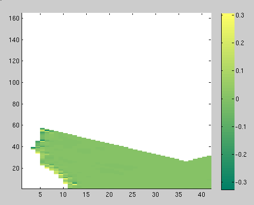

and sand_01:
Near the bottom (from restart): On a surface (from restart):

--I already run ROMS with FSCHAPMAN and M2FLATHER boundary conditions and app blew up on 3th hours of estimated time.
--About Lwave... Yes, I have written nonsense)))) I do not have ocean_frc.nc file, therefore I use analytical values or SWAN. I'm define ana_wwave and set this values in ana_wwave.h. If I set undef ANA_WWAVE then compiler give me error: "I can't find ocean_frc.nc." If undef NEARSHORE_MELLOR then compiler write: "I don't know Hwave and Lwave"))) Should I undef that and another?
--I think (look at my prev post) what problem with stability was from EAST fsobc))
About other points I will write a bit later, then ROMS end to work.
