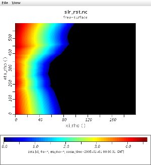

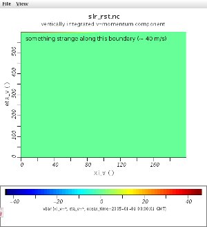

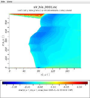

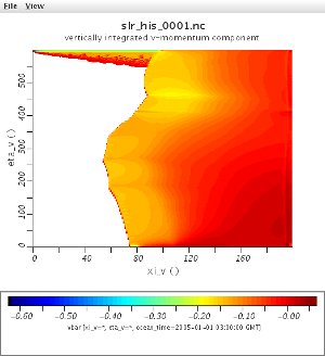

Hi! It's me again,
Since my domain was a bit big (200x600) so I was afraid of some uncontrolled grid cells. It took me sometime to prepared more ideal bathymetry as attached with the same size (so in thi run only netcdf grid file was different).
ROMS died at the 2nd timestep (a step better than the original)
zeta, ubar, vbar in RESTART and my impression also included there.

- there're big values along the top (left) boundary
- vbar.jpg (13.6 KiB) Viewed 29365 times
- ubar.jpg (13.13 KiB) Viewed 29364 times
- strange zeta: the left haft of the domain shouldn't be covered with water
- zeta.jpg (13.97 KiB) Viewed 29364 times

OK. The way wet_dry works is that the free surface is draped over the topography. So you had a comment "strange zeta: the left haft of the domain shouldn't be covered with water"
Well, what is happening is that the water level is being set to be greater than the depth, by an amount of Dcrit. For further description please seee here-->
https://www.myroms.org/wiki/index.php/WET_DRY

It looks to me that the problem is along the northern (left ) boundary. There could be issues with certain boundary conditions. With all the possible combinations of types of BCs, I can not check them all. So maybe you have a configuration that was not tested. I recently (yesterday) posted a fix for set_data - what was happening is that the user was imposing a BC of zeta that was less than the dpeth. So i had to code in a catch to prevent that. It sounds like a similar issue to what you have. This wet_dry option is relatively new. So maybe you are finding something that others did not cathch yet. Sorry. But can you at least update the ROMS/Nonlinear/set_data.F routine and see if that works. IF not, I may need to grab your input files and take a quick look.

But I believed that there're still some bugs related to BC (when the water level is physically below bottom of the boundary cells).
The attached are output of HISTORY after 1 hour (in fact ROMS now can lives much more than that).
- vbar1.jpg (17.17 KiB) Viewed 29343 times
- ubar1.jpg (16.21 KiB) Viewed 29343 times
- zeta1.jpg (14.53 KiB) Viewed 29341 times

That northern boundary is still not looking correct. In the figure, vbar along the northern edge, left side, is negative (in a triangle region). So is the water level along that side much greater than the land? If so, then water will come in. Like a tidal wave. I can not prevent water from coming in. You must do that. Is it realistic for the water level to raise above the land there on the left side?
If it is not realistic, then you must not let it happen. This can be dealt with in several ways. 1) use land mask = 0 so that those cells never get wet. 2) limit the boundary zeta_north to not go above the land (just on the left side). The latest 'catch' i coded in should then set the water level to be Dcrit higher than the land, and all should be ok.
