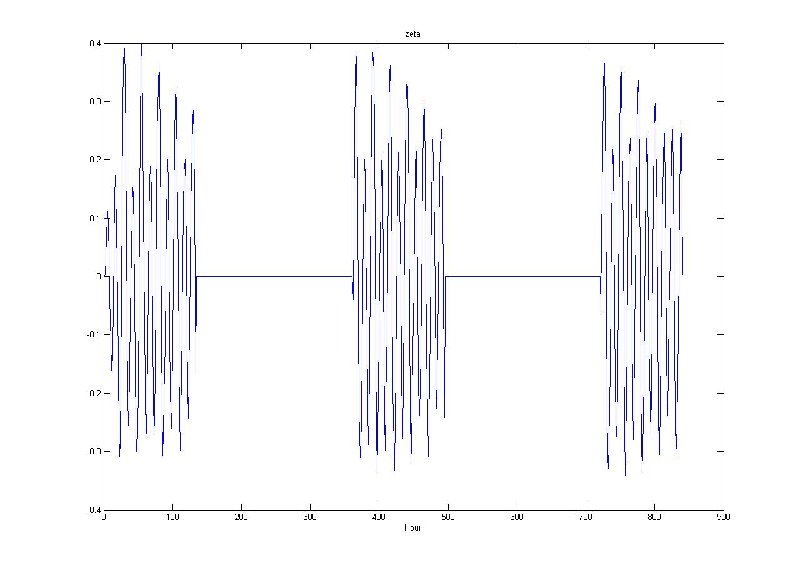

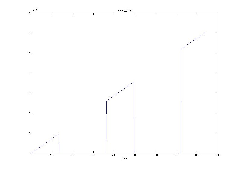

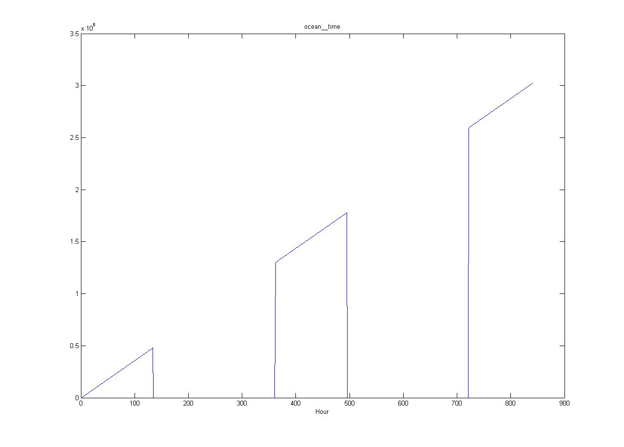

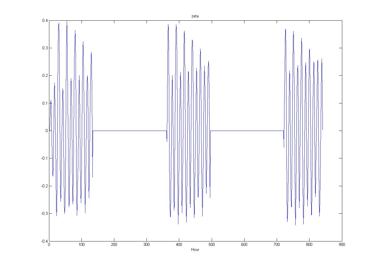

When I run a tidal foring application ,something strange happened.It seems that zeta was set to zero periodically. I check variable 'ocean_time' in history file,which has the same error as zeta. Because RAMP_TIDE is used in my header file,the error in ocean_time could result in same error in zeta. But I am confused why that error happened?
