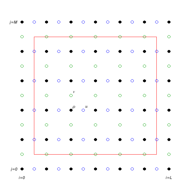

To amplify on Hernan's reply, the following graph shows the ROMS horizontal grid structure. The solid circles are the "rho" points where SSH is evaluated, the open circles are the points where the velocities are evaluated (blue for U, green for V).
Schematic diagram of ROMS horizontal grid layout.
The red line marks the model's normal-velocity boundary. When a wall boundary condition is in effect, it is applied by setting normal velocity to zero on the red line. When one of the various open boundary conditions is in effect, points on and outside the red line are calculated by the boundary condition code. You can see that setting the SSH at the outer edge of the model is not going to affect flow in the interior significantly unless the code that calculates the boundary normal velocity (on the red line) responds to this SSH somehow.
