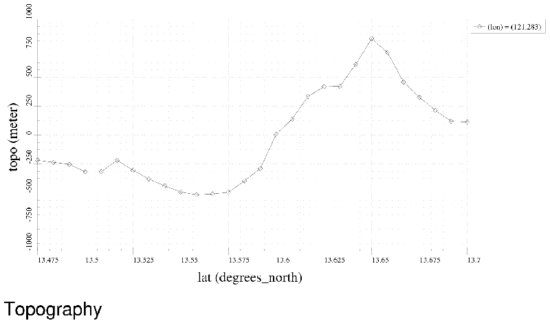

What is the proper way for handling sea cliffs?
In the Philippines, at about 121.283 degrees East and 13.6 degrees North, there is a sea cliff that rises from the deep ocean. At 900-meter horizontal resolution (SRTM30 data) the north-south cross section of bathymetry/topography is plotted below. The numerical values for the topography here are (from south to north):
-491 meters (below sea level)
-515
-508
-493
-396
-288
+7 meters (above sea level)
+139
http://acd.ucar.edu/~drews/SeaCliff.png
Obviously the topography is very steep at the shoreline. ROMS reports Beckman numbers of Inf here, but I guess I can calculate rx0 by hand as (288 - 0.5) / (288 + 0.5) = 0.9965; way over the recommended maximum value of 0.4, but this is real topography. I think I would have to increase my horizontal resolution by a factor of 100 to achieve a better r-factor {(2.88 - 0.5) / (2.88 + 0.5) = 0.7}
I am blowing a strong wind from south to north (toward the cliff). DCRIT = 0.5 meters, N = 3 levels, and DT = 6.0 seconds. I'm using MY25_MIXING. There are two problems here:
1. When I mask out all land above 5 meters, ROMS generates a blowup error on the first time step. When I mask out all land above 10 meters (now including the 7-meter point), ROMS gets started okay. I can live with that - 7 meters is a pretty high storm surge but I don't mind calculating a few extra grid points along the coast. Question #1 is how should I set the land-sea masking in this case? Is it not possible to jump right out of the sea onto a masked-out land point?
2. When I allow the 7-meter point to be "sea" (wet or dry), ROMS runs for about 5 simulated hours before blowing up. The error is a CFL violation in the W-velocity at the 7-meter point; the vertical velocity there is about 3 times what the CFL criterion will permit. The free-surface height zeta is still 7.5 meters, so that grid point has not gotten wet yet. Question #2 is how can I avoid getting so much vertical velocity in my "draped" water?

Interesting questions and quite relevant to some of my new domains.
First of all, for something like your first example, what I do is mask out the land points and smooth the water points. There's more than one way to handle the land-sea interface in the smoothing operation, however. Because of some fjords, I want my smoother to just smooth the sea points with each other and not try to smooth across the transitition, even if one of our steps has traditionally been to set the depth of land points to shallow water depths. A 200 m fjord with a flat bottom should not need any smoothing even if surrounded by cliffs.
Why should your first test have failed then? I'm not sure.
In the case where it really does make sense to include wetting and drying, one needs a new way to compute the r-value. Since in the running of ROMS, you set the wet points to always be at least say 0.5 m deep, you can simply clamp depths to that depth when computing the r-value, but you'll still get crazy values in the shallows. A jump from 10 m to 0.5 m is still an r-value of 0.9, in the badly-behaved range. Being good about the r-value would require quite a buffer of grid points between the 10 m channel and the wet-dry shallows. Say you aim for 0.333 in the r-value, that means points at 0.5m, 1m, 2m, 4m, and 8m. What do people realistically do about this?
