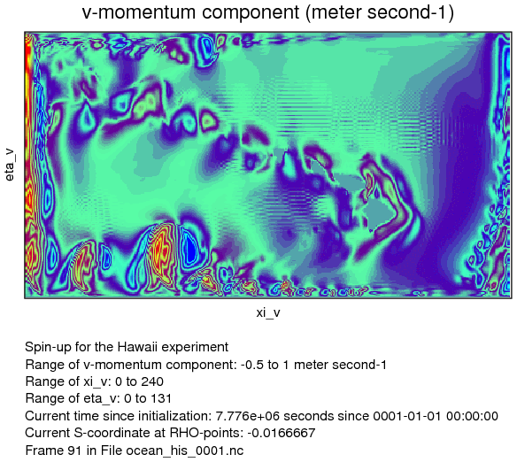

Despite I can succesfully run the first year of spin-up (meaning that the model doesn't blow-up!! I start from rest and uniform conditions), after couple of months of simulation the velocity field in the first vertical levels becomes characterized by weird/unrealistic stripes:
This is the surface field of the V-momentum component after the third month of spin-up.<br />The figure was generated with ncview using the &quot;detailed&quot; colorbar.
The figure was generated with ncview using the "detailed" colorbar.

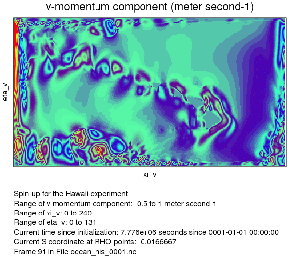

Playing around trying to figure out what was causing the problem, I ran a simulation with the exact same parameters as the previous one, but using the GLS as vertical closure scheme instead of the LMD. As you can see the velocity field looks ok in this case:
I then checked the depth of the surface boundary layer (Hsbl) for the simulation with the LMD scheme activated. That field, as well, was characterized by similar stripes as the ones present in the velocity field.
Assuming at this point that the origin of the problem is the LMD vertical closure scheme (and not being experienced at all with it) I would like to know if anybody had a similar problem with it, and most importantly if anybody has any suggestion on how I could fix it.
I looked at the examples that come with ROMS, and the ones that have a resolution similar to my experiment (DAMEE_4, SCB, NATL) all use the same CPP options (LMD_CONVEC, LMD_MIXING, LMD_NONLOCAL, LMD_RIMIX, LMD_SKPP) and the same values for the parameters in the .in file that I'm using.
Thanks a lot,
francesco

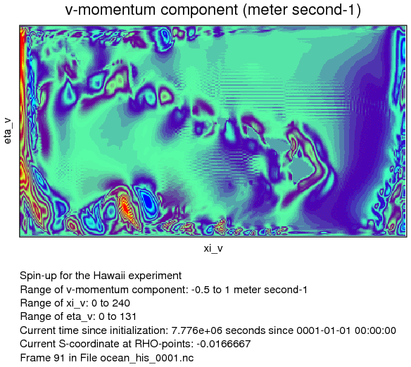

I use the LMD_SHAPIRO option to smooth out hsbl.
nencio
Re: Problem with KPP
#3 Unread post by nencio »
Hi kate,
thanks for the quick reply. I tried your suggestion and the hslb field is much smoother now. However the velocity field still shows those weird stripes:
anything else I can try??
...and most importantly: anybody who had a similar problem??
thanks,
francesco
