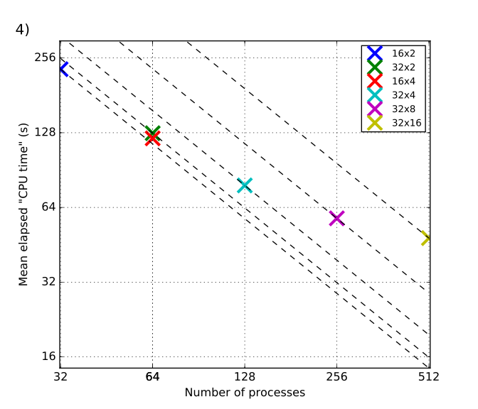

Hi, I'm tinkering with benchmarks on Amazon Web Services (AWS). The attached figure shows time (in seconds) spent per process for the ROMS ”large” benchmark test (benchmark3.in), as function of the number of processes. Axes are logarithmic with base 2. Computations are performed on c4.8xlarge instances of AWS, which have 36 vCPUs per node. I used only 32 vCPUs of the c4.8xlarge to avoid potential problems with some Linux operating systems which have a vCPU limit of 32. These instances feature custom Intel Xeon E5-2666 v3 (Haswell) processors.
AWS defines a ”vCPU” as a hyperthread of the Intel Xeon processor. Note that a stock Xeon E5-2666 v3 has 10 cores and 2 threads per core, but that AWS uses a ”custom” version.
Software stack:
Operating system: CentOS Linux release 7.2.1511
Linux kernel: v3.10.0 x86_64
Fortran compiler: gcc-gfortran 4.8.5
MPI library: openmpi 1.10.0
More info, including a tentative cost estimate for a realistic study, can be found https://poidl.github.io/awsroms/. Let me know if you find mistakes.
