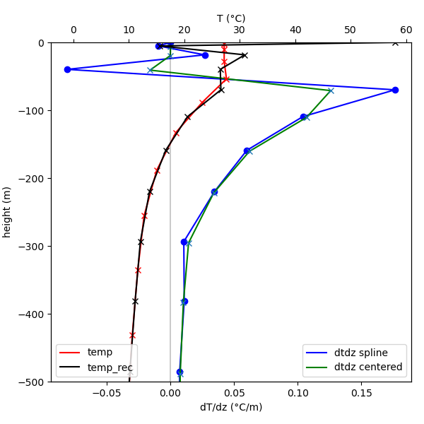

I was looking at the reconstruction of dT/dz (temperature derivative) via splines in the
function s_balance.m from the ROMS matlab repository. I try to reproduce the tridiagonal system for the derivative, departing from
Eq. 3.16 of Shchepetkin & McWilliams 2005 (btw I think there is a sign typo in the first fraction
of their 3.16, but it does not propagate to their 3.19) in the attached note.pdf. I compared
my python solution with the matlab/octave code in s_balance.m, and the derivative is
identical. I have not compared the reconstruction of T itself.
The problem is, the plots of the reconstructions look pretty bad, with large oscillations (see below).
I know that in the unbalancing of salinity, the mixed layer is damped/excluded, but the question is more generally
about the use of splines elsewhere in the ROMS code.

Legend for the figure:
temp: temperature profile
temp_rec: reconstructed temperature on z_w points, using parabolic splines (as in the attached pdf)
dtdz: vertical derivative on z_w points, using splines as in s_balance.m and the attached pdf (I compared the matlab
code results in octave to my Python version, it's identical). No filter was used.
dtdz_centered: plain centered differences mapped to the depths halfway between rho points
Thanks for any help.
