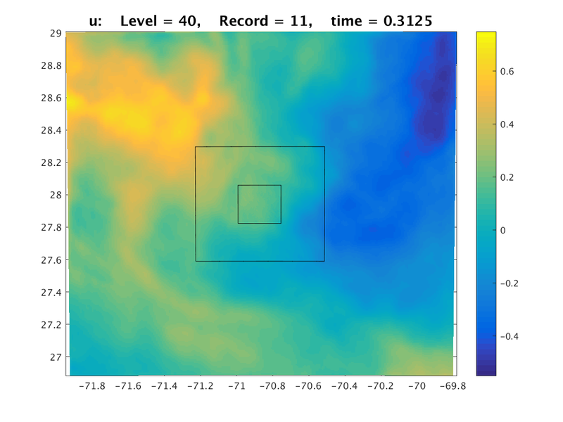

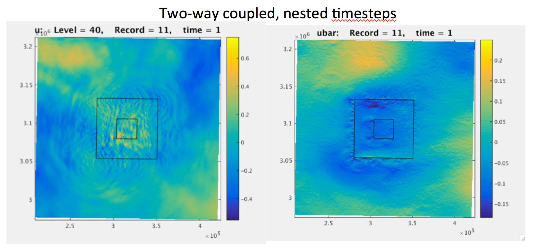

We are trying to run ROMS in a well resolved nested deep water (h ~ 5000m) configuration and have encountered a difficulty. We are using three nested grids at a grid ratio of 1:3. On the coarsest grid, dx ~ dy ~ 800m while at the finest dx ~ dy ~ 89m. The initial condition is derived from NCOM and the bathy from Gebco 2014. Other details of the three cases we ran can be found in the attaches Archive.zip file. It includes the job.in script and a subset of the logfile.

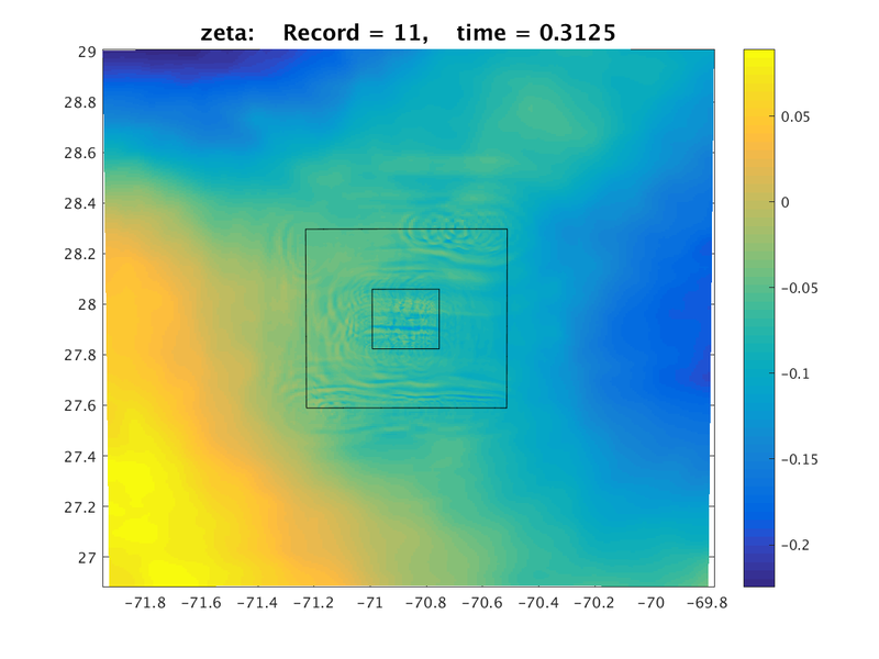

The issue is the creation of spurious waves at the boundary of the nests when using two-way coupling. This is shown in the first two images below of the u-field at top boundary and the elevation.
Two-way nesting

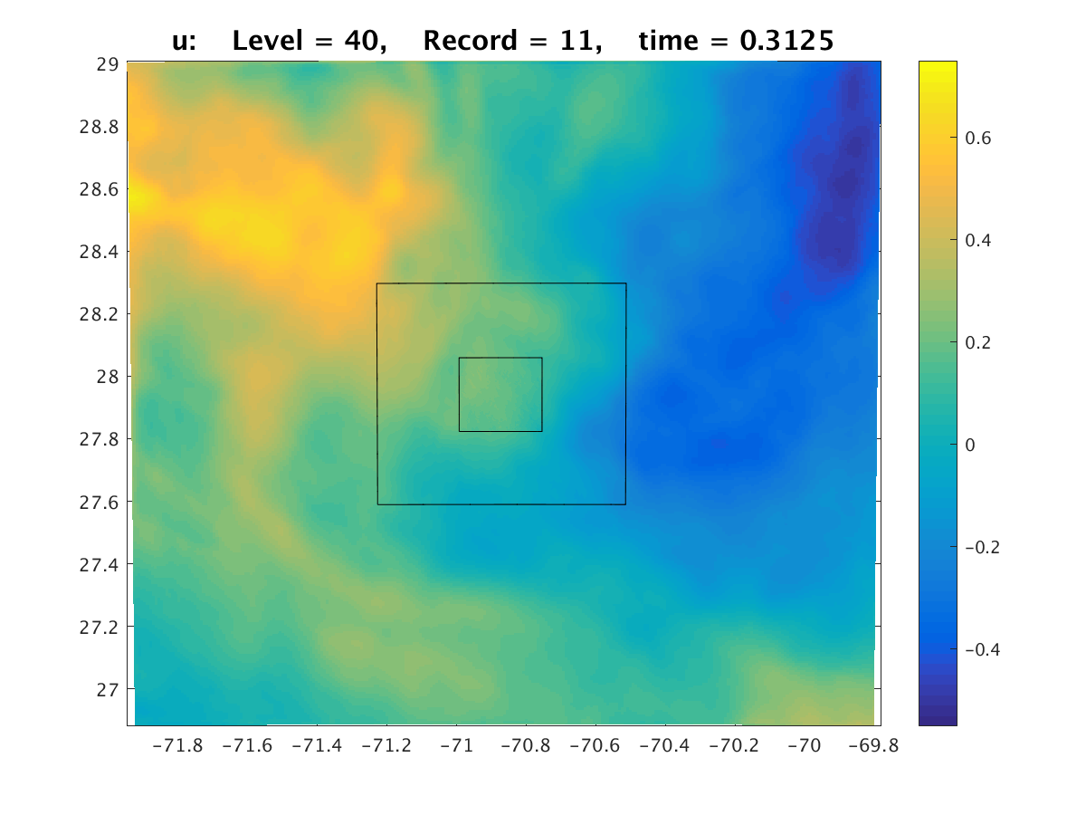

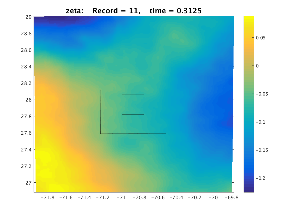

Following the suggested procedure, we stepped back to the simpler case of one-way coupling and found the results well behaved, as can be seen in second two images. Same initial and boundary conditions. Same time stepping and forcing. Only change was requiring one-way coupling, via the compilation flag 'ONE_WAY'
One-way nesting

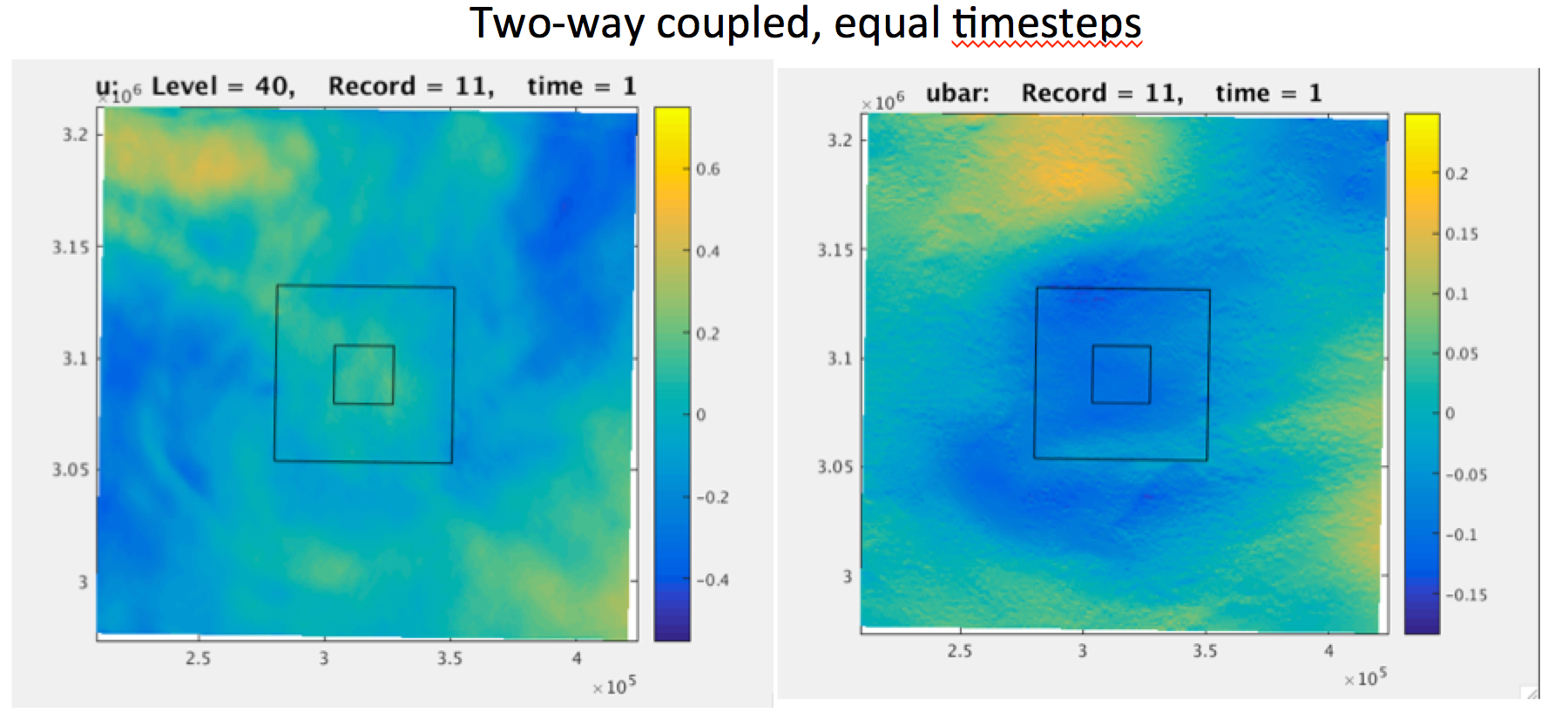

In a attempt at diagnosing the issue, we re-ran the two-way coupling but used a synchronized time step. That is all levels were run at the time step of the finest grid. This seems to eliminate the wave generation, but at the expense of having much longer run times.
Two-way nesting,synchronized time stepping

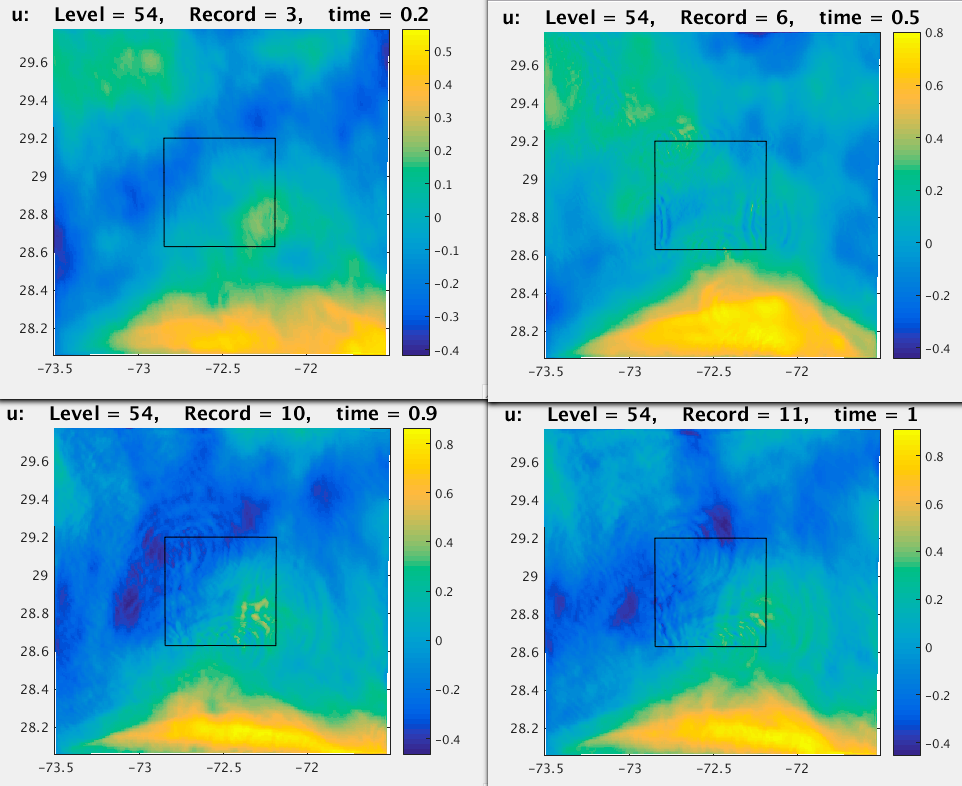

The attached image shown a screen capture of a different deep water case showing the evolution over a day. The waves near the lower left corner at one-day are sufficient near the boundary to imply that they were generated sometime after the start of the simulation.

Re: Difficulty with two-way deep water nested grids - update
I continue to have difficulties with two-way coupled nested grids, but with John Wilkin's guidance have been able to clarify a few things. The inputs are derived from an NCOM run, Atmospheric inputs derived from WRF and Gebco bathymetry.
1. I've confirmed smoothness of bathymetry at and near the nest boundaries.
2. I've confirmed correctness and consistency of contact regions.
3. Metrics were a bit of a problem. We were using a spherical/GreatCircle approximation in grid_metrics.m, which I believe is not strictly valid for ROMS. Metrics generated this way should have a radial dependency, but pn & pm as 2-D arrays can not. The 'NESTING_DEBUG' cpp flag provides mass conservation output for the nesting boundaries and mass was not conserved at the nesting boundaries when using a spherical grid.
Therefore I reconstructed the problem in UTM coordinates. The metrics now conserve area during the nesting data exchanges and the mass flux is also conserved during nesting.

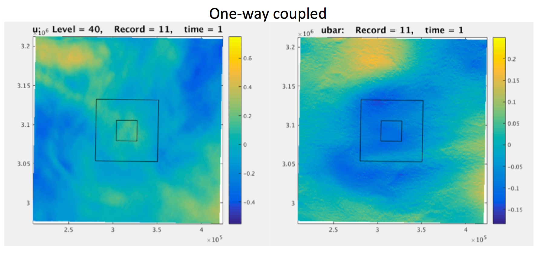

Mass conservation at the boundaries did not fix my two-way nesting issue. Below are three simulations using the UTM coordinates. One-way coupling, two way coupling where the nests have equal timesteps and two-way coupling where the timesteps are treated in normal nested way. Maximum Courant number is less the 0.75. Clearly, the third case is incorrect.
