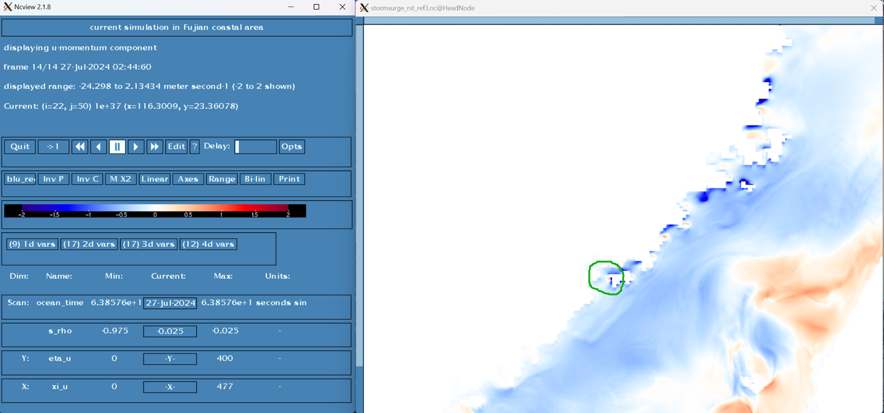

Progress has been made in my running. Upon reevaluating the forcing files, I identified issues with my "Lwave" variable. Consequently, I performed iterative calculations of Lwave using the dispersion relation, employing the wave period at the spectral peak, which is publicly available data from Copernicus Marine Service. I created a new nested example; however, the model experienced a blow-up after running for one day.
I hypothesize that the issue may stem from my use of Pwave_top as a substitute for Pwave_bot. Given the presence of very deep topography within my model domain, this approximation may lead to significant inaccuracies in deep water regions. Could this be one of the factors contributing to the blow-up?
I reviewed the SWAN code for calculating Pwave_bot and noted that it requires the integration of the wave energy spectrum. Unfortunately, I do not have complete data on the wave energy density spectrum. I would appreciate any suggestions on how to accurately provide Pwave_bot.
Additionally, I examined the .rst file and found that the anomalous velocities occurred near the boundary of an island in the coastal region. As a rough corrective measure, would it be feasible to set the land mask for this island to represent ocean instead?
