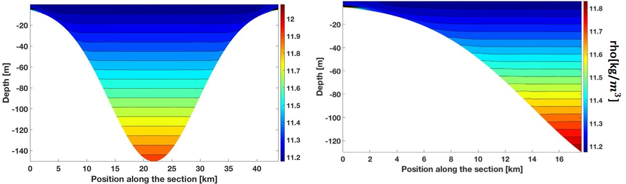

I am working with an axisymmetric idealized lake. I added two freshwater river inflows with a constant temperature of 4 degrees centigrade (I activated LUVSrc and temperature and salinity tracers). The lake surface temperature is set to freezing point temperature, and the lake's salinity is set homogeneously at 14 PSU.
My lake depth is 145 m, and the 45 km length scale and average inflow velocity is 2.1 m/s (dx=90m and dz=0.16 m and f=0.033, river_transport= 1m^3/s).

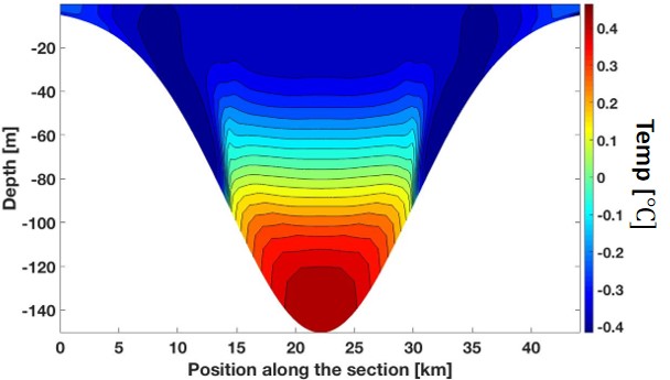

Despite adding freshwater inflow with a constant temperature of 4 degrees Celsius, the salinity of the lake near the river's mouth increased by approximately 0.5 PSU.

what about temperature? Is it correct or do you have a strange result? Are you sure about the inflow direction you set (inflow not outflow from the domain)?

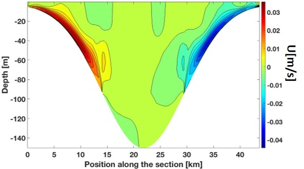

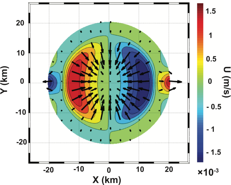

I changed my f=0, but still, i have the same problem with salinity. I attached velocity fields, temperature, and density vertical sections.

Despite adding rivers with a flow rate of 1 m^3/s, there is no noticeable increase in the volume of water, there is a potential problem with water mass.

Based on velocity fields, river directions are correct.

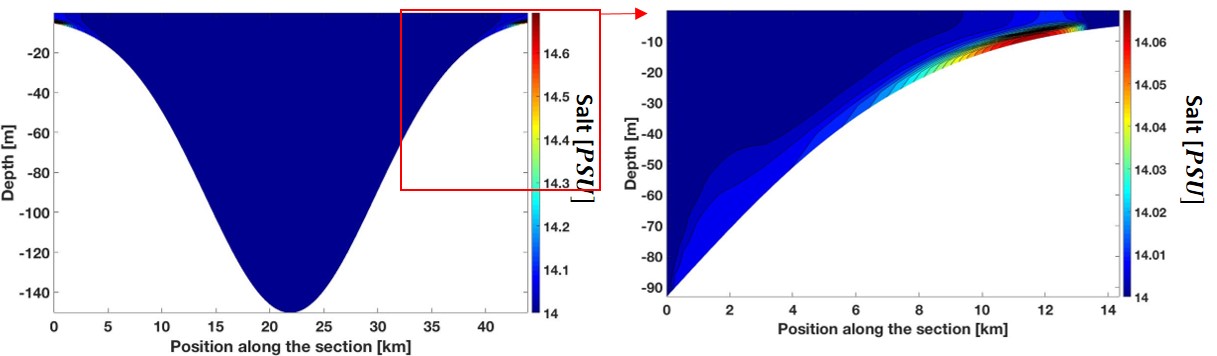

I tried LwSrc (mask = 1), and the salinity increased (I attached a salinity vertical profile close to the river mouth).

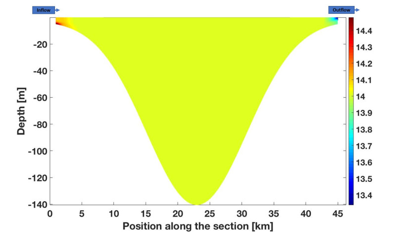

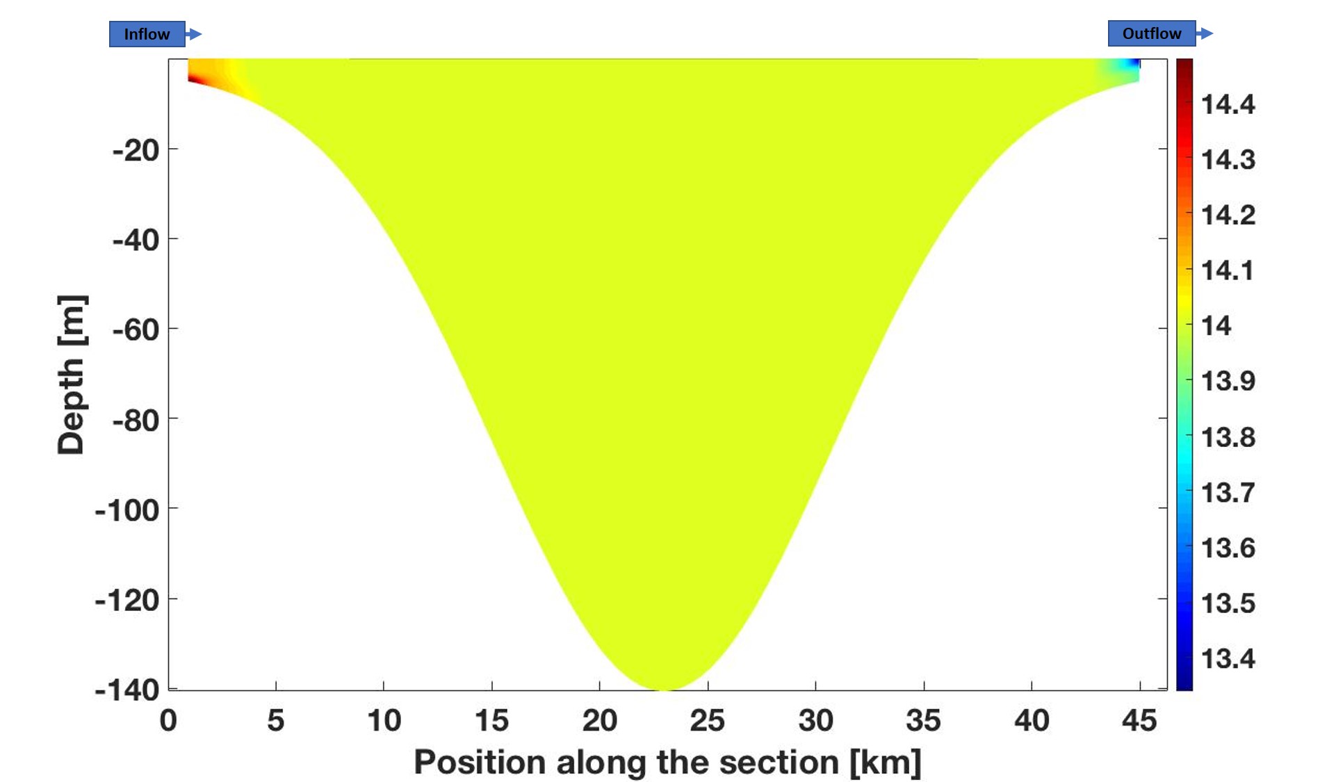

I changed my settings and defined one inflow and one outflow. Salinity increased near the inflow, and salinity decreased near the outflow.

In summary, i ran your case and i see the salt decrease for the LwSrc as it should, with the source of water coming in at salt=0.
I ran your case with LuvSrc and i see the salt increase. The reason is that both of your point sources take water out of the domain. If you take water out, and specify the salt out =0, then no salt will leave. Therefor the salinity (concentration of salt) will increase in the domain.
If you have a box of water with salinity = 20, then you evaporate half of the water, the salinity goes up to 40 because the amount of salt stayed the same but the volume decreased.
If you set
LtracerSrc == T F ! temperature, salinity, inert
then the LuvSrc will keep the salt at 14.
The specifies to remove salt at the tracer concentration of the source location.
If you set

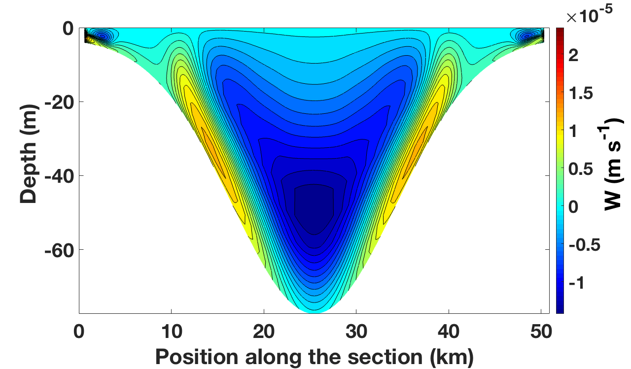

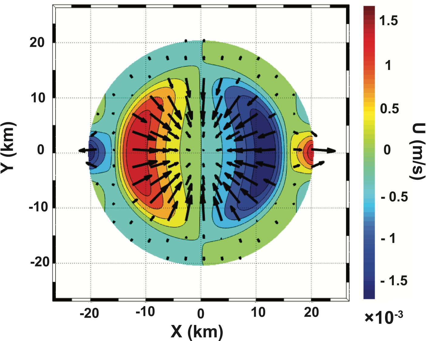

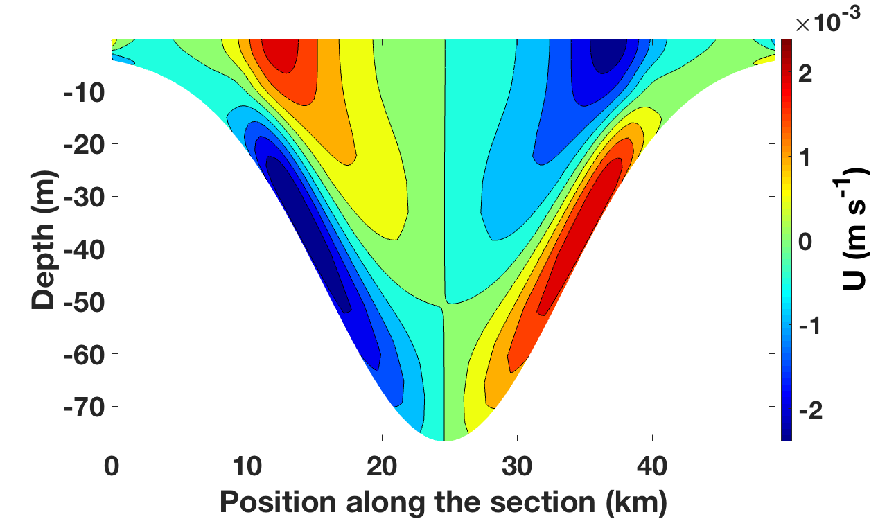

Hi John,
I think I added two river inflows, each with a discharge of 𝑄=5 m^3/s, primarily directed in the u-direction. However, I have noticed two different velocity directions in the model, and I am uncertain whether these indicate inflows as expected.
I have attached the following files for your reference:
Horizontal and vertical velocity sections *near river locations),
Grid and initial condition files,
River file, and Log file.
In particular, I would greatly appreciate your guidance on ensuring the proper representation of the river inflows.
Thank you for your time and assistance. I look forward to your insights.
Fatemeh
