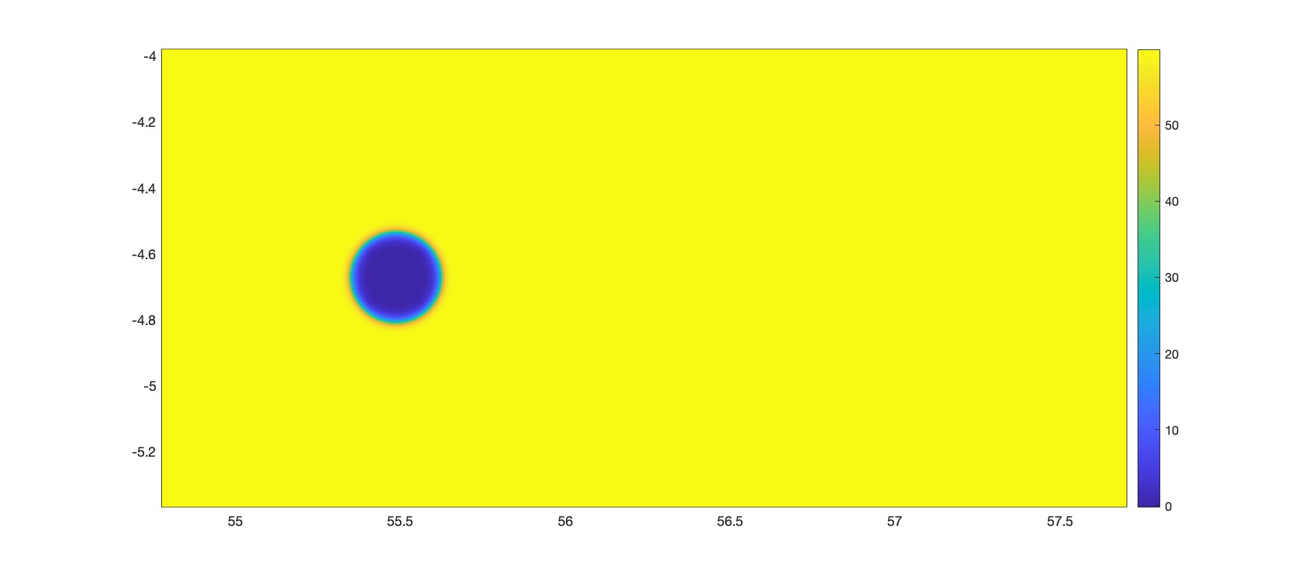

My model domain is for a circle island in shallow ocean, the bathymetry of the domain look like this: (x and y axis are longitude and latitude)
