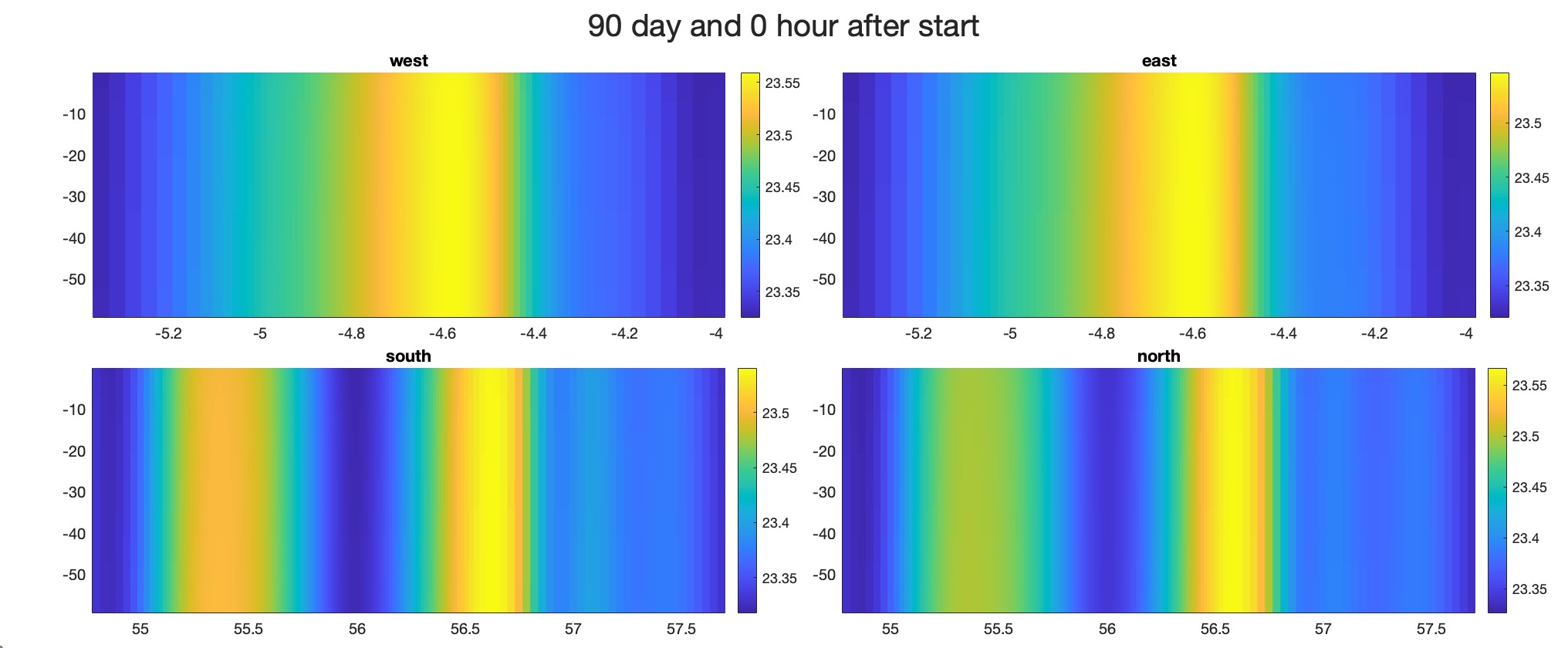

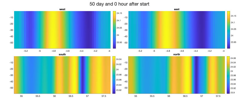

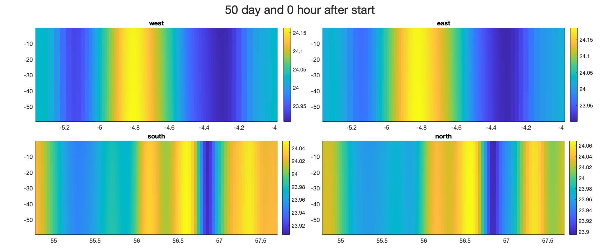

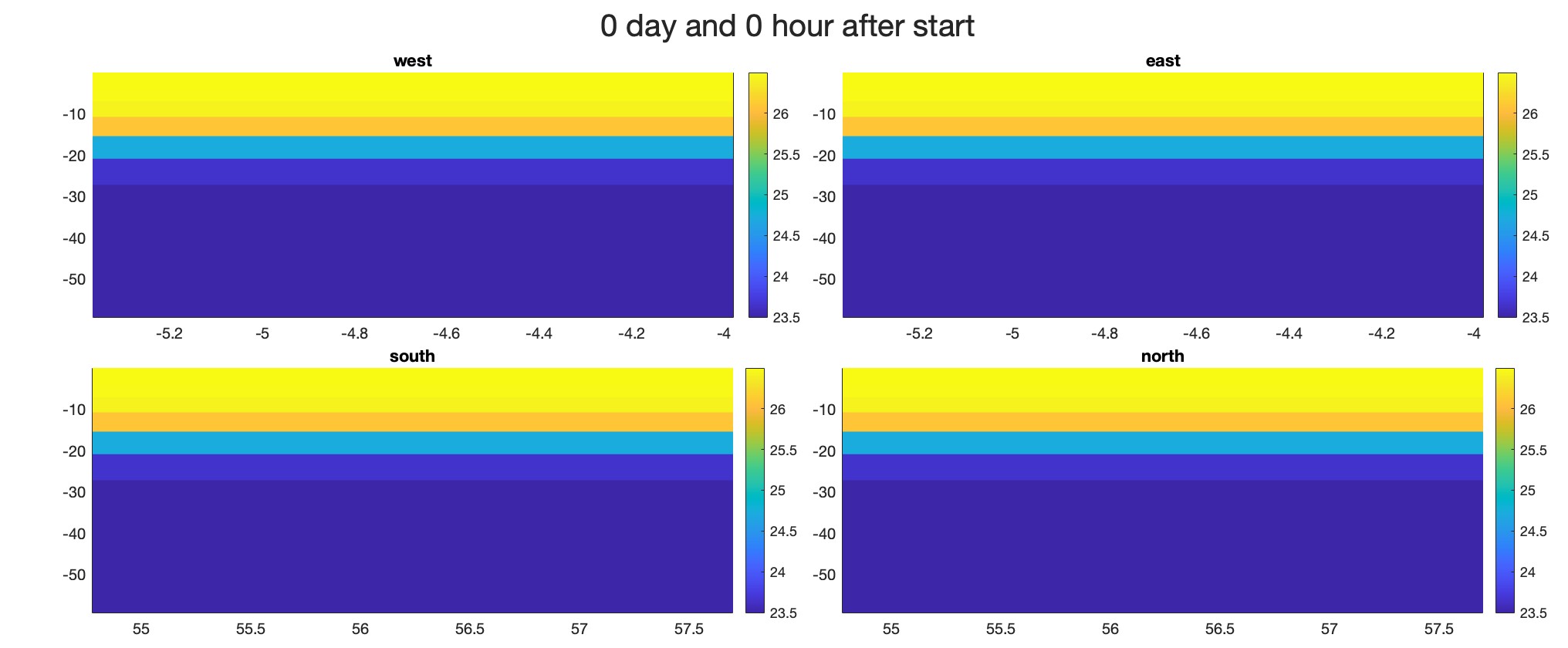

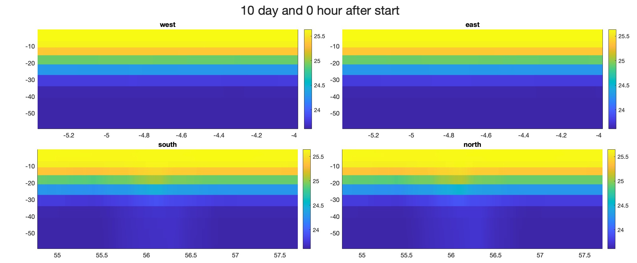

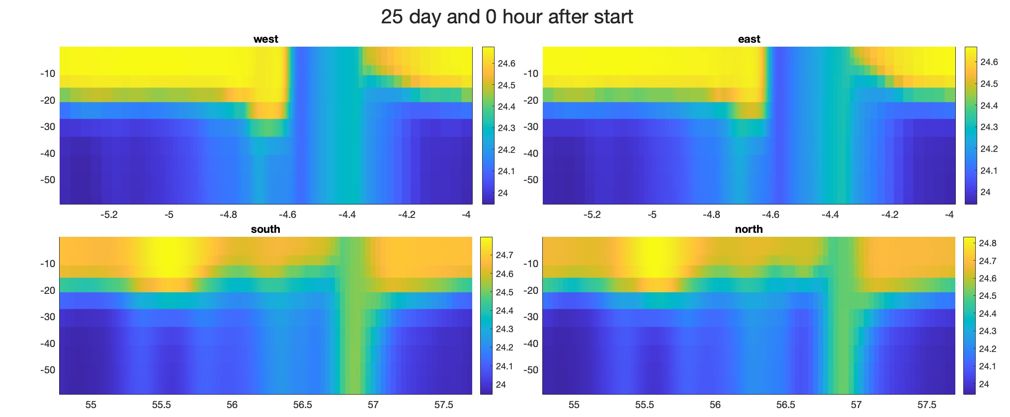

Here's the temperature change in time on four boundary:
Any insights or advice would be greatly appreciated!

It doesn't make any physical/logical sense to have some variables periodic and others not. Consequently, the logical flags EWperiodic and NSperiodic are set to .TRUE. if any boundary is periodic. See Utility/inp_decode.F
If you look in Nonlinear/t3dbc_im.F you'll see there are entires there for radiation, clamped, etc. but no entry for periodic. Periodicity is enforced elsewhere and since you have EWperiodic true your clamped condition is over-ridden.
If you want to reintroduce stratification internally to the domain, you might consider using nudging to climatology in a limited region. This can be done via ana_nudgcoef.h or via an input netcdf file.
