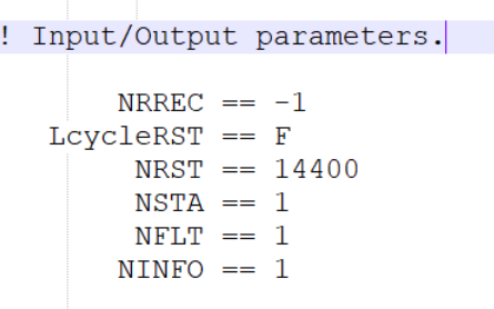

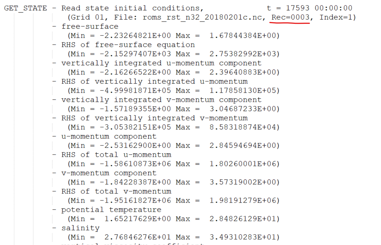

I set LcycleRST==F, and got multiple time nodes in restart_file, I want to ask, how can I restart the task from one of the time nodes, I try to change DSTART, the result is still restart from the latest time in restart_file :roll: :roll:

set NRREC = 1 or = 2

jcwarner wrote: Mon May 20, 2024 5:00 pm set NRREC = 1 or = 2
Thank you very much. Yes, after I set it up like this, it solved my problem easily :lol: :lol:
