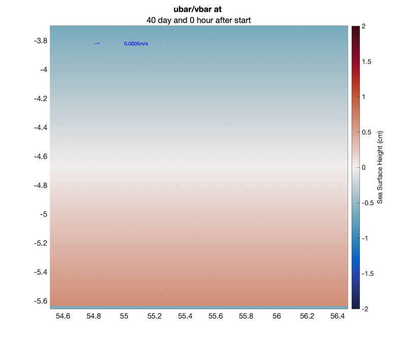

I'm encountering a persistent issue with the sea surface height (zeta) output from my ROMS model, particularly regarding the boundary conditions. My aim is to fix the sea surface height to zero at the north and south boundaries using the Chapman boundary condition, as illustrated below:
!                   W       S       E       N
!                   e       o       a       o
!                   s       u       s       r
!                   t       t       t       t
!                           h               h
!                   1       2       3       4
   LBC(isFsur) ==   Per     Cha     Per     Cha         ! free-surface
However, I'm observing discrepancies between the zeta values at the boundary in the ROMS output and the specified boundary condition. Just like I show in figure below.
Despite adjusting the Nudging/relaxation time scales to large values, the boundary issue persists:

Posts: 936
Re: Issue with Sea Surface Height (Zeta) Boundary Condition in ROMS Model
The Chapman condition does not "fix" zeta on the boundary. It is designed to radiate out barotropic waves generated inside the domain.
Read ... https://www.myroms.org/wiki/Boundary_Co ... _condition
It is designed to be used in conjunction with the Flather condition. Read ...https://www.myroms.org/wiki/Boundary_Co ... _condition.
Notice that the user imposed zeta on the boundary does not enter into Chapman, only Flather.
