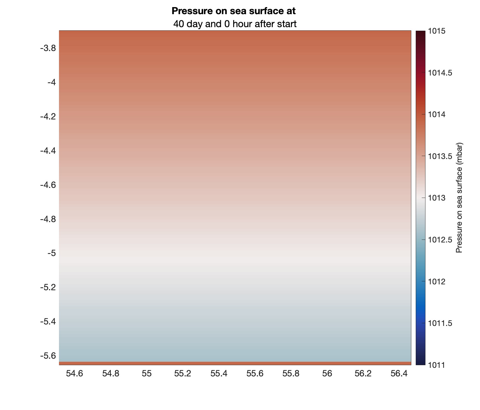

I'm currently working on implementing latitude-varying air pressure in my ROMS model to create a pressure gradient for driving geostrophic currents. To achieve this, I've constructed the air pressure in the ana_pair.h file as follows:
#elif defined SHALLOW || SHALLOWNI
      Cor_freq = -1.182E-05_r8
      Tilt_pressure = -0.05_r8*Cor_freq*rho0*111.2_r8*1000_r8
      Mid_lat = -4.6741
      Mid_pressure = 1013.25_r8
      DO j=JstrT,JendT
        DO i=IstrT,IendT
          Lat_move = latr(i,j)-Mid_lat
         /*0.01 for 1 pa = 0.01 mbar*/
          Pair(i,j)= Mid_pressure + 0.01_r8*Tilt_pressure*Lat_move
This method appears to generate a reasonable pressure gradient, as evidenced by the output (shown in the figure).
However, I've encountered a peculiar issue: there seems to be an unexpected pressure bump at the south boundary. My initial suspicion is that the periodic boundary condition might be influencing this anomaly. However, it doesn't seem logical to enforce periodicity on air pressure while setting other variables (such as u, v, ssh, etc.) to be periodic.
Does anyone have insights into why this strange pressure bump might be occurring at the south boundary? I would greatly appreciate any thoughts or suggestions on how to address this issue.

N-S periodic means that field values on the northern edge will be copied to the southern edge, and also the other way.
So the thin line along the bottom is the pressure from the northern edge, if you set periodic in the ocean.in file.
for a continuous gradient, periodic may not be the best choice. perhaps a body force might work better.

I use time varying air pressure to generate oscillating flow in a "1-dimensional" ( actually 3 x 3 horizontal grid) doubly periodic test case for teaching ... similar to the BIO_TOY example.
For this to work, I have to fill the entire grid and disable the periodic exchange.
So, in ana_pair.h note the +2 in the DO loop ranges ...

!  Exchange boundary data.
#if !defined COD_1DMIX
/* In periodic applications it is necessary to exchange boundary data
   to enforce periodicity. But in COD 1-D Mixing example we don't want
   to do this because it messes up grad(p) = spatially constant */
      IF (EWperiodic(ng).or.NSperiodic(ng)) THEN
