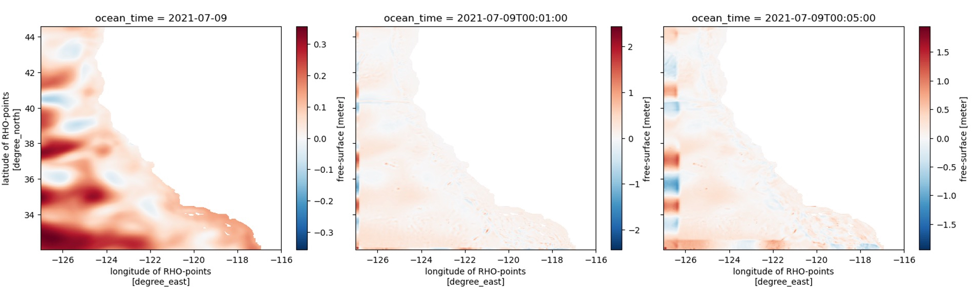

Hi all. I'm working on setting up a ROMS application using a lambert conformal grid projection that I created with pygridgen, but am finding some strange behavior at the open boundaries with respect to sea surface height (below). Using essentially the same setup, I don't run into this error when using a grid with a regular lat/lon projection. My input files (boundary, initial, climatology) are based on HYCOM data interpolated to the ROMS grid.
Essentially, a wave immediately (within a minute or less) begins to propagate and expand from the boundaries to the coastline over time. I can still run ROMS for a good amount of time despite this behavior, but I'm also trying to run it within the COAWST system. There I find that it causes the coupled system to crash at the first time step when information is exchanged between WRF and ROMS.

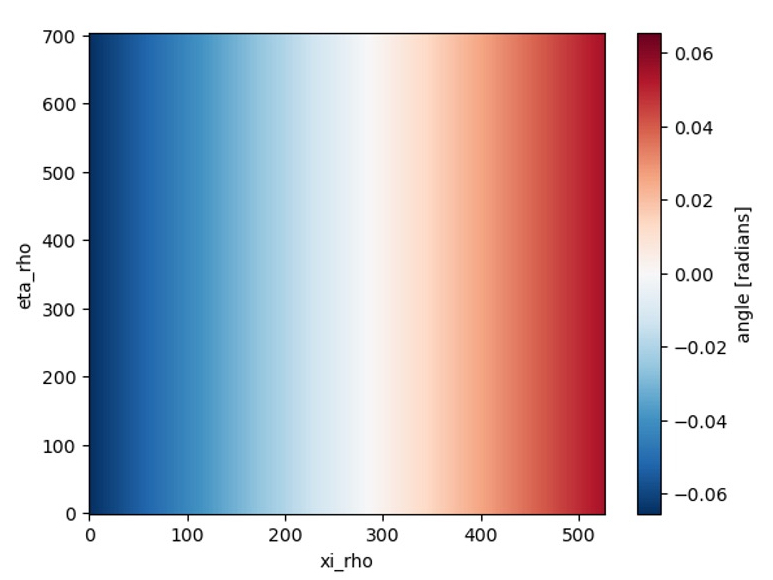

One place where I thought that there may be an error was in the angle values of the grid file. But, as shown below, they are relatively small and now I'm not so sure that they're the cause of this zeta boundary error. Thanks for any tips about where I might have gone wrong with my model setup, I appreciate the help!
angle plot v2.jpg (146.32 KiB) Viewed 9405 times

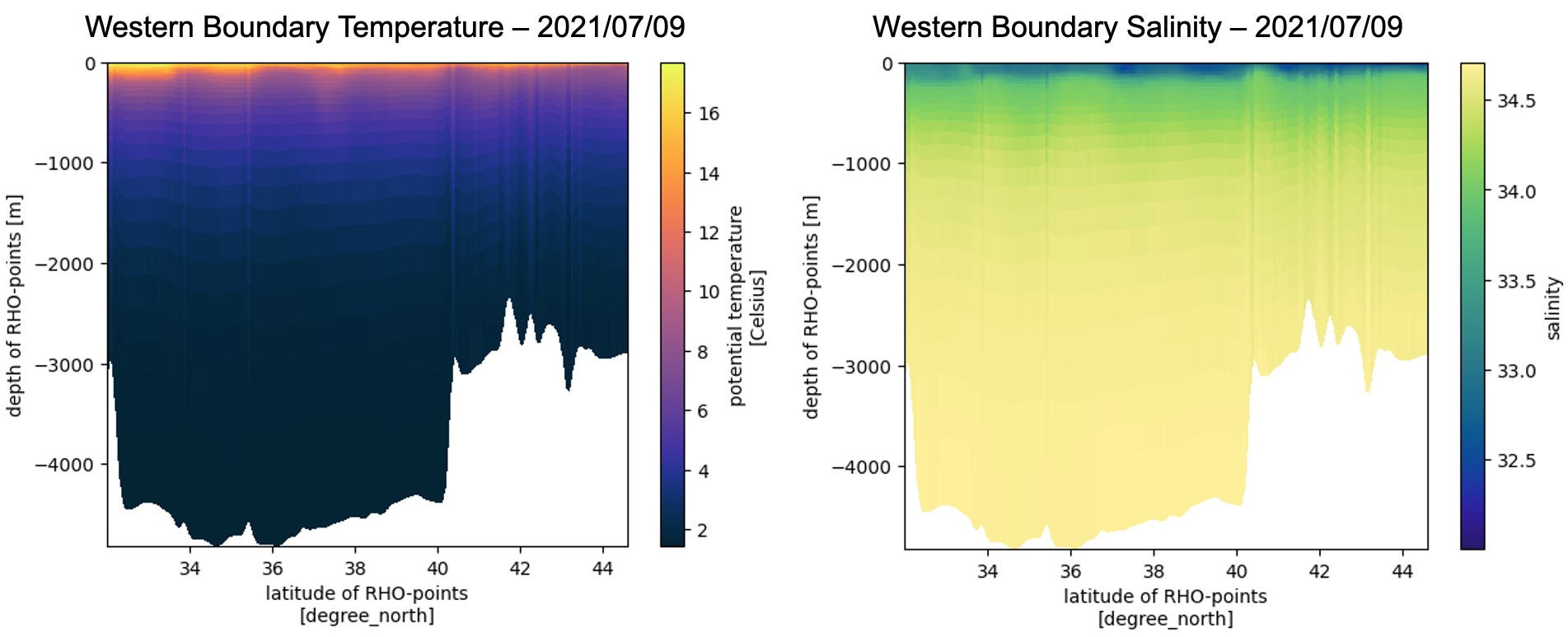

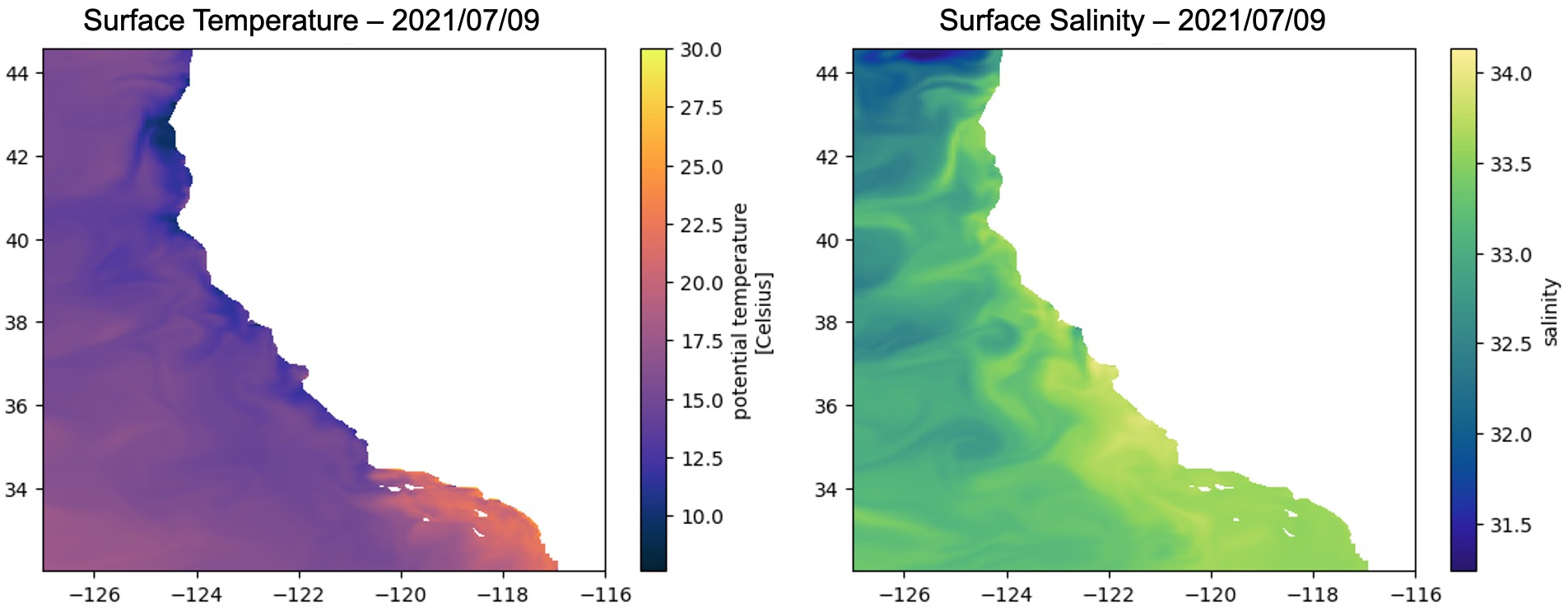

Thanks John. Temperature and salinity look okay to me, below are surface plots and western boundary profile views of both at the starting time step. The next time step is also basically identical.
The boundary conditions that I've set are below. I also tried running a bathtub case by closing all of the BCs but ran into the same issue.
