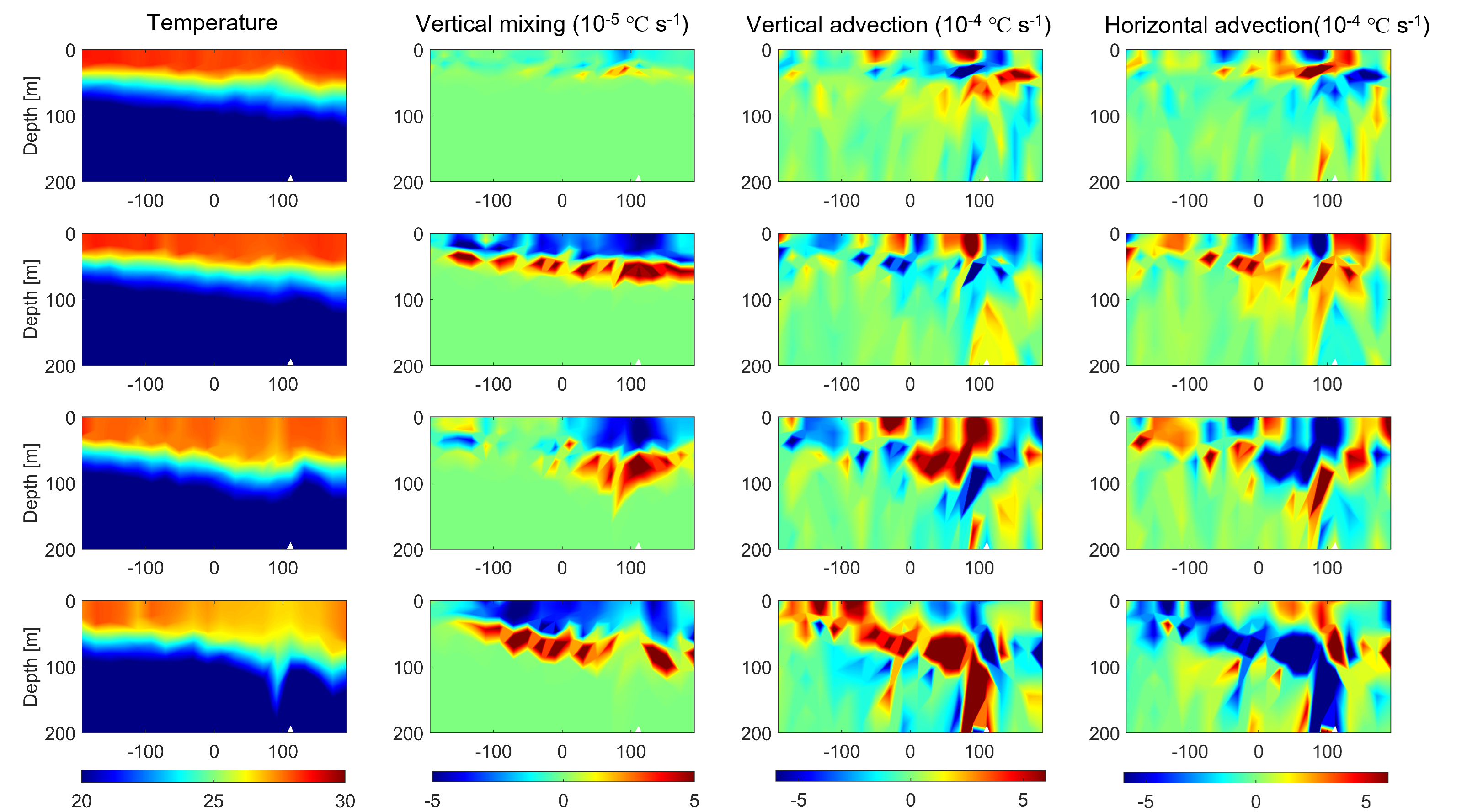

I simulated a tropical cyclone using ROMS model.
When I analyzed the temperature rate, vertical mixing and advection, I found the horizontal/vertical advection terms are far greater than the vertical mixing term. And another strange phenomenon is that the horizontal advection and vertical advection terms are exactly the opposite number. But actually, I learned from others that these terms in most cases are of the same magnitude (i.e., *10^-5). I tried to change some settings in the .h file and .in file and this phenomenon has not been improved (see Figure).

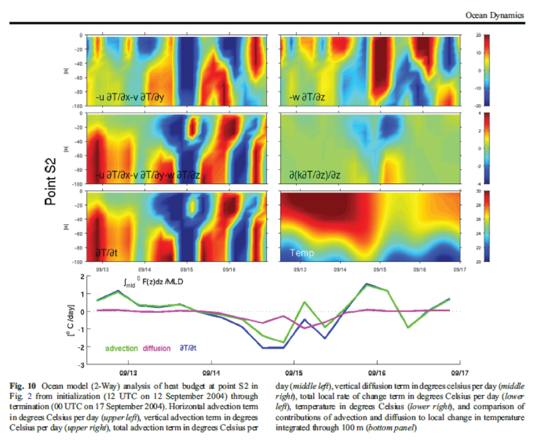

those are about the same dynamics that we simulated for H Ivan.
Zambon, J.B., He, R., and Warner, J.C. (2014). Investigation of Hurricane Ivan using the Coupled Ocean-Atmosphere-Wave-Sediment Transport (COAWST) Model, Ocean Dynamics, 64, 1535-1554. doi:10.1007/s10236-014-0777-7.
