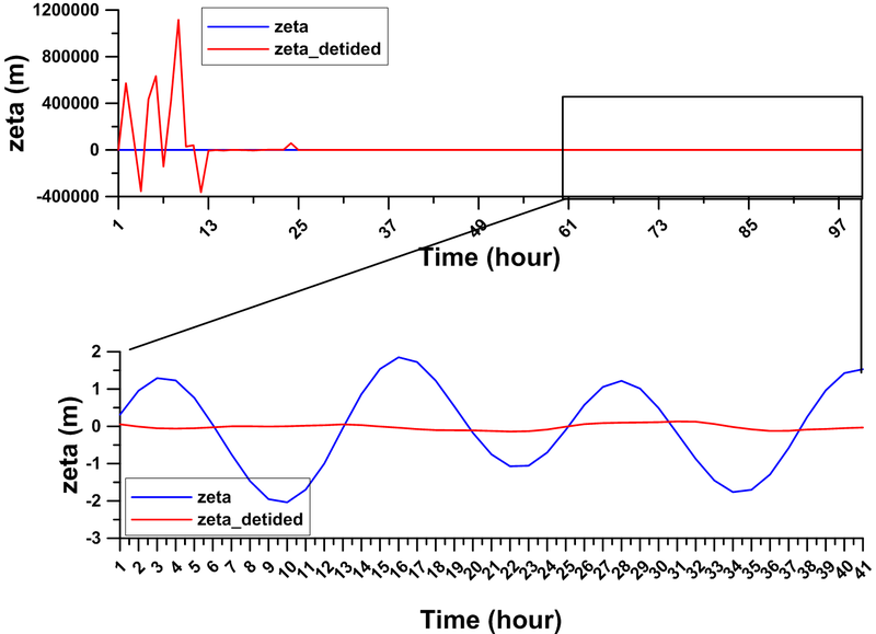

Hi every one
I performed detide test using the ROMS/TOMS 3.7 version.
In my cpp option, AVERAGES_DETIDE, AVERAGES, UV_TIDES, SSH_TIDES was applied.
Compiling and model run very well. To confirm detide result, average file output is hourly mean.
But result is that zeta_detided is too high from 1 to 55 hour. Initial max zeta_detided height appear higher sea level than 1000000 m. But since 60 hour, zeta_detided is stable and appear removed tide signal.
My problem is that why too high zeta_detided such as 1000000 m appear and how solved this phenomenon (or problem ?). Below figure is my result.
thanks.

hi jkoceans11,
I am also facing similar problem like you (Zeta_detide value is too large).
Did you resolve or understand the problem? If yes than Could you tell me how to resolve this issue.
With regards
-Ravi
