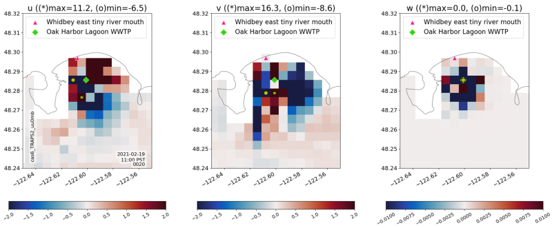

Thank you for all of the replies/suggestions! I haven't yet run a test with the additional outputs, but intend to do so soon and will attach the new files.
In the meantime, I was hoping to get your thoughts on the issue of transport. The max transport of any LwSrc is 7 m3/s, and the source that is causing issues has a max transport of 0.1 m3/s. I have set Vshape such that the vertical point sources discharge solely from the bottom sigma layer.
In contrast, the LuvSrc's generally have much larger transport values. The nearby Whidbey east river is relatively small, with a transport rate of -4 m3/s.
My follow-up question is: does it make sense that a LwSrc of 0.1 m3/s could generate the large velocities shown in the original post, despite being much smaller than the nearby LuvSrc?
Thank you again!
Aurora

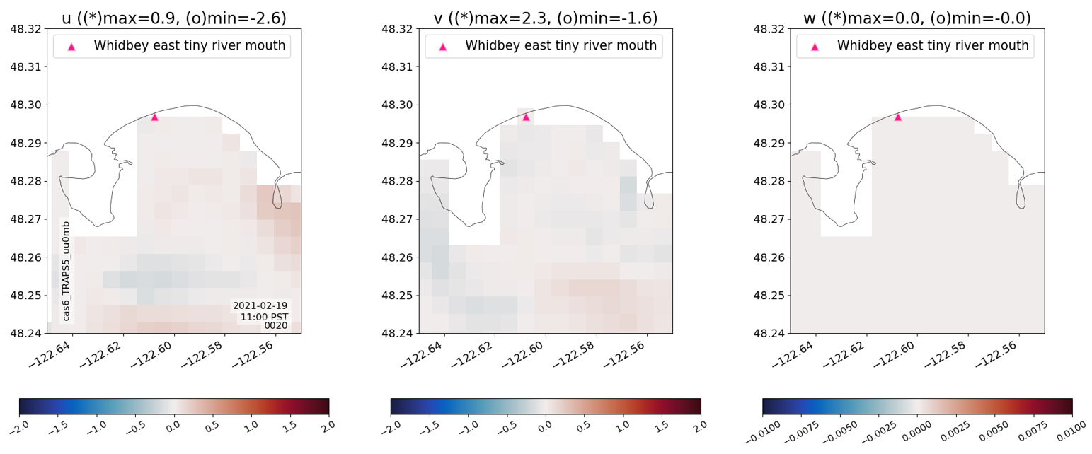

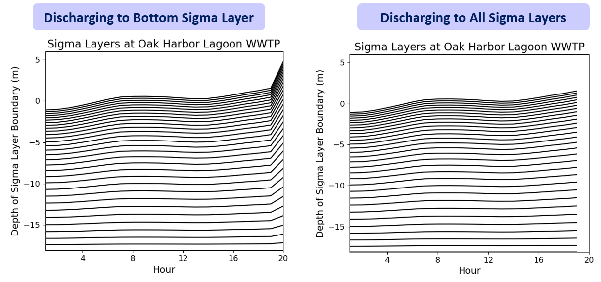

Here are the surface velocities for a run without any vertical sources:

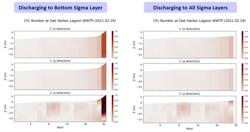

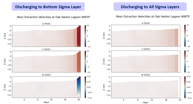

Hi everyone,
Again, thank you for your thoughts on this matter. I just completed another round of testing and wanted to share some new results.
Per your recommendations, I checked the vertical Courant number. They were indeed very high (but strangely only high near the surface sigma layers rather than the bottom sigma layer to which the vertical source discharges). In the latest test, I equally distributed Vshape of vertical sources amongst all sigma layers rather than discharging solely to the bottom sigma layer. Despite this update, ROMS still crashes near the site of the vertical source. So far the only remedy to the issue has been to remove the problematic point source.
Here I will note that this problem has happened before at an entirely different vertical source. After removing that vertical source, ROMS ran for 1.5 months before crashing at this second vertical source. Thus, the problem seems to be with vertical sources in general, rather than with individual sources. I could simply remove the problematic sources as they appear, but would prefer to understand the nature of the problem (and fix the issue, if possible).
Some other symptoms/observations:
  • High vertical Courant number
  • Vertical homogenization of velocity, temperature, biogeochemistry a few hours before blowup
  • Sudden jump in SSH
  • Large surface velocities near point source
Another note: forcing for vertical sources varies on a monthly basis. Thus, the input transport, temperature, biogeochem, etc. on the day of blowup is the same as the 18 days prior to blowup.
Please let me know if you have any other thoughts on this matter. I've exhausted most of my ideas and thus greatly appreciate any feedback. I have attached the most recent log file (for the case with vertical sources equally distributed amongst sigma layers). I have also included depth vs. time profiles at the location of the problematic vertical source on the day of blowup.
Aurora

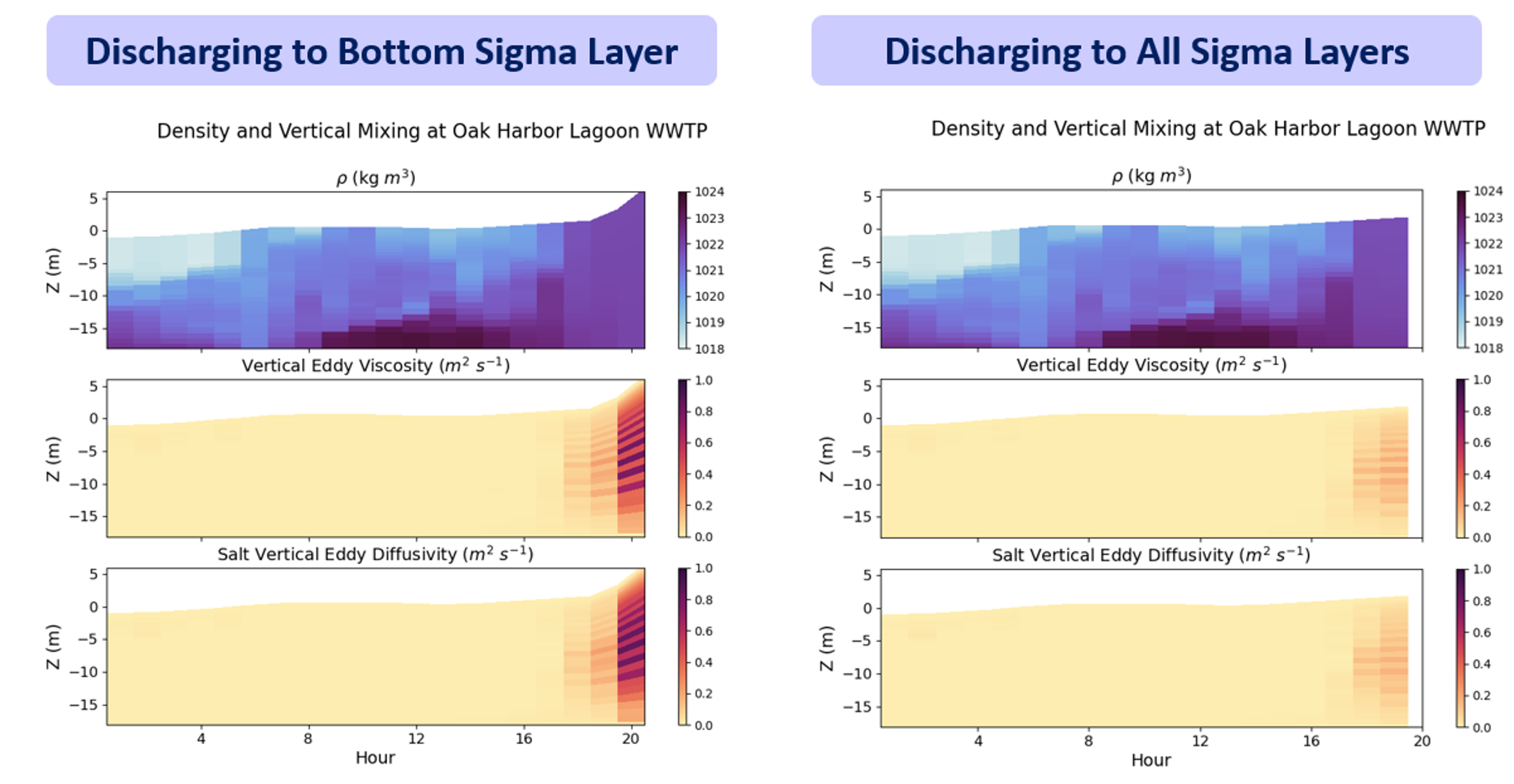

I think the sudden jump in sea level and surface velocities are symptoms of the instability, and not its origin.
Looking at the density profile and AKt vertical mixing eddy diffusivity immediately before and after the vertical homogenization of the water column can you convince yourself this is mixing due to static instability? If so, that should be OK and no indicative of an immediate problem. The sudden homogenization could, however, introduce large horizontal gradients in tracers and I see you have no explicit horizontal mixing of tracers to smooth that. Are you relying on the implicit diffusion in MPDATA to control all the small horizontal scales in tracers that can feed into instabilities?
Is this strictly a problem with the physics? i.e. nothing changes whether Biology is defined, or not?

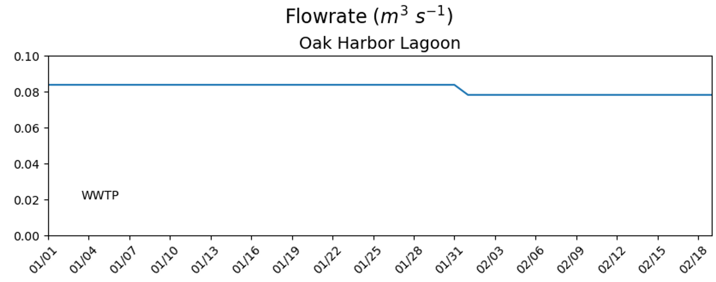

4- what is the time series of Qin (river flow) at the problematic point? can you plot that?

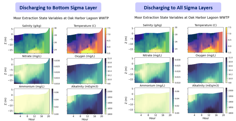

aleeson
Posts: 6
Joined: Thu May 12, 2022 7:40 pm
Location: University of Washington
Re: ROMS crashing when using LwSrc
#13 Unread post by aleeson »
Thank you for the suggestions!

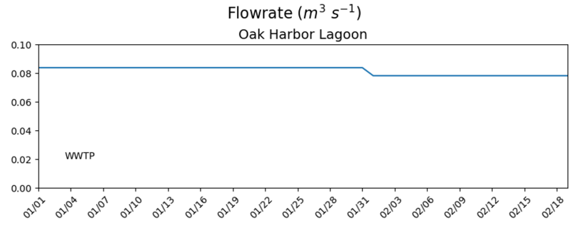

I've attached a depth vs. time plot of in-situ density and vertical eddy viscosity/diffusivity at the vertical source. There doesn't appear to be a static instability.
I've also included a transport timeseries of the problematic source. Discharge temperature from this source is always 10 degC.
The run seems to stop halfway when ninfo is too small, but I'll try to make it as small as possible.
Right now, I am making my way through testing different mixing and advection schemes to see if they may help.
More updates to come.
Thank you again for your thoughts,
Aurora

Dear ROMS folks, we are still having the problem Aurora describes above when using LwScr. She has tried many things to fix this:
-carefully checking the forcing files
-injecting the source at all levels, or at the top level, instead of the bottom level
-trying different advection schemes (A4 instead of MPDATA)
-turning off biogeochemistry
In all cases the model still crashes, sometimes running for a few months but when we look carefully there are large disturbances in velocity around the vertical source locations. The source transports are small so we would expect very little modification to the circulation.
So, I am wondering if there may still be bugs in this relatively new ROMS capability. Here are notes about places I am suspicious of, all from a recent version in ROMS/Nonlinear:

aleeson
Posts: 6
#19 Unread post by aleeson »
Hi everyone,
I am reviving this thread because we have recently resolved this issue, and we'd like to recommend an improvement to step3d_uv.F.
In most files in ROMS/Nonlinear, such as pre_step3d.F, we see a pattern of "IF Dsrc == 0 THEN ....; ELSE IF Dsrc == 1 THEN ..."
!  Apply tracers point sources to the horizontal advection terms,
!  if any.
!    Dsrc(is) = 0,  flow across grid cell u-face (positive or negative)
!    Dsrc(is) = 1,  flow across grid cell v-face (positive or negative)
          IF (LuvSrc(ng)) THEN
            DO is=1,Nsrc(ng)
              Isrc=SOURCES(ng)%Isrc(is)
              Jsrc=SOURCES(ng)%Jsrc(is)
              IF (((Istr.le.Isrc).and.(Isrc.le.Iend+1)).and.            &
     &            ((Jstr.le.Jsrc).and.(Jsrc.le.Jend+1))) THEN
                IF (INT(SOURCES(ng)%Dsrc(is)).eq.0) THEN
                  IF (LtracerSrc(itrc,ng)) THEN
                    FX(Isrc,Jsrc)=Huon(Isrc,Jsrc,k)*                    &
     &                            SOURCES(ng)%Tsrc(is,k,itrc)
                  ELSE
                    FX(Isrc,Jsrc)=0.0_r8
                ELSE IF (INT(SOURCES(ng)%Dsrc(is)).eq.1) THEN
                    FE(Isrc,Jsrc)=Hvom(Isrc,Jsrc,k)*                    &
                  ELSE
                     FE(Isrc,Jsrc)=0.0_r8
However, in step3d_uv.F we have only ""IF Dsrc == 0 THEN ....; ELSE ..."
!  Apply momentum transport point sources (like river runoff), if any.
        DO is=1,Nsrc(ng)
          i=SOURCES(ng)%Isrc(is)
          j=SOURCES(ng)%Jsrc(is)
          IF (((IstrR.le.i).and.(i.le.IendR)).and.                      &
     &        ((JstrR.le.j).and.(j.le.JendR))) THEN
              DO k=1,N(ng)
                cff1=1.0_r8/(on_u(i,j)*                                 &
     &                       0.5_r8*(z_w(i-1,j,k)-z_w(i-1,j,k-1)+       &
     &                               z_w(i  ,j,k)-z_w(i  ,j,k-1)))
                u(i,j,k,nnew)=SOURCES(ng)%Qsrc(is,k)*cff1
            ELSE
              DO k=1,N(ng)
                cff1=1.0_r8/(om_v(i,j)*                                 &
     &                       0.5_r8*(z_w(i,j-1,k)-z_w(i,j-1,k-1)+       &
     &                               z_w(i,j  ,k)-z_w(i,j  ,k-1)))
                v(i,j,k,nnew)=SOURCES(ng)%Qsrc(is,k)*cff1
I believe this ELSE statement is un-intentionally assigning v-momentum to vertical sources. I've recently run a couple of tests in which I've changed the ELSE statement in step3d_uv.F to "ELSE IF (INT(SOURCES(ng)%Dsrc(is)).eq.1) THEN" and they seem to run without issue.
Let me know if you have any questions or thoughts. Thank you all again for your feedback and suggestions!
Best,
Aurora
