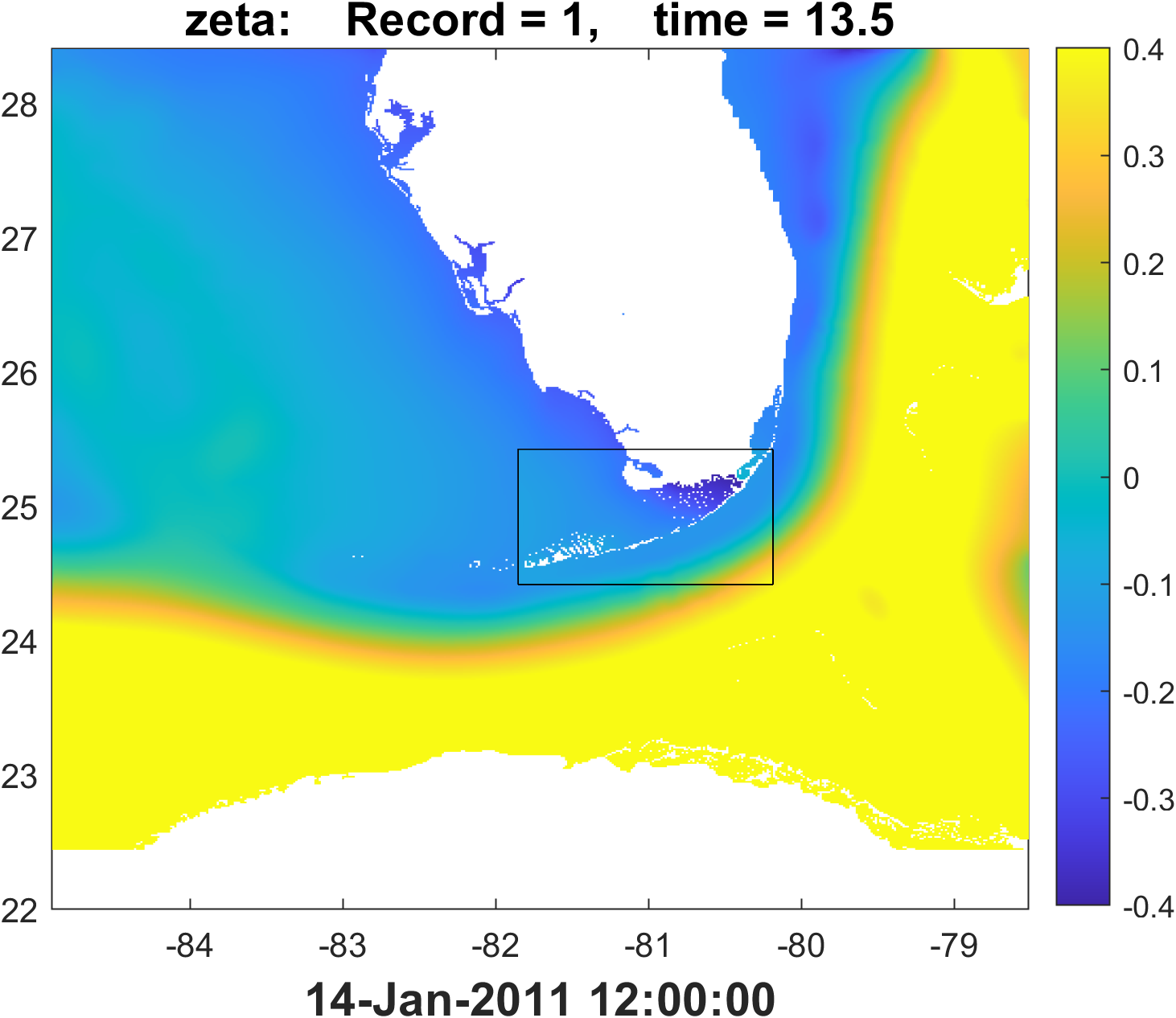

I'm constructing a nested model for Florida Bay area. The water level calculation is wrong for one-way nesting, but two-way nesting doesn't have the problem. The only thing I changed was the cpp option.

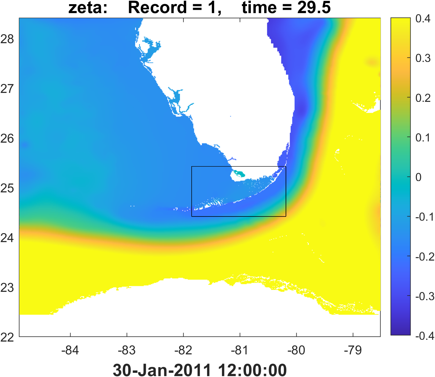

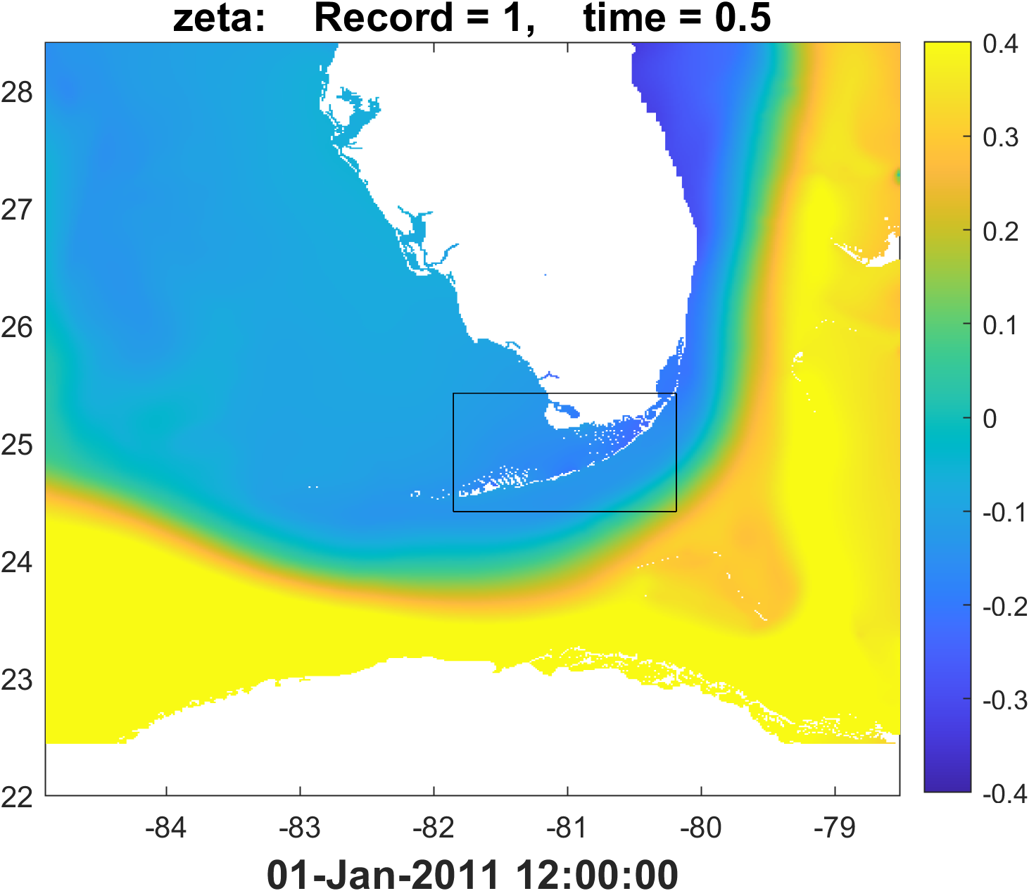

Here are plots of daily average water level for one-way nesting:
day 1:
day 14:
day 30:
day 30 plot for two way nesting:

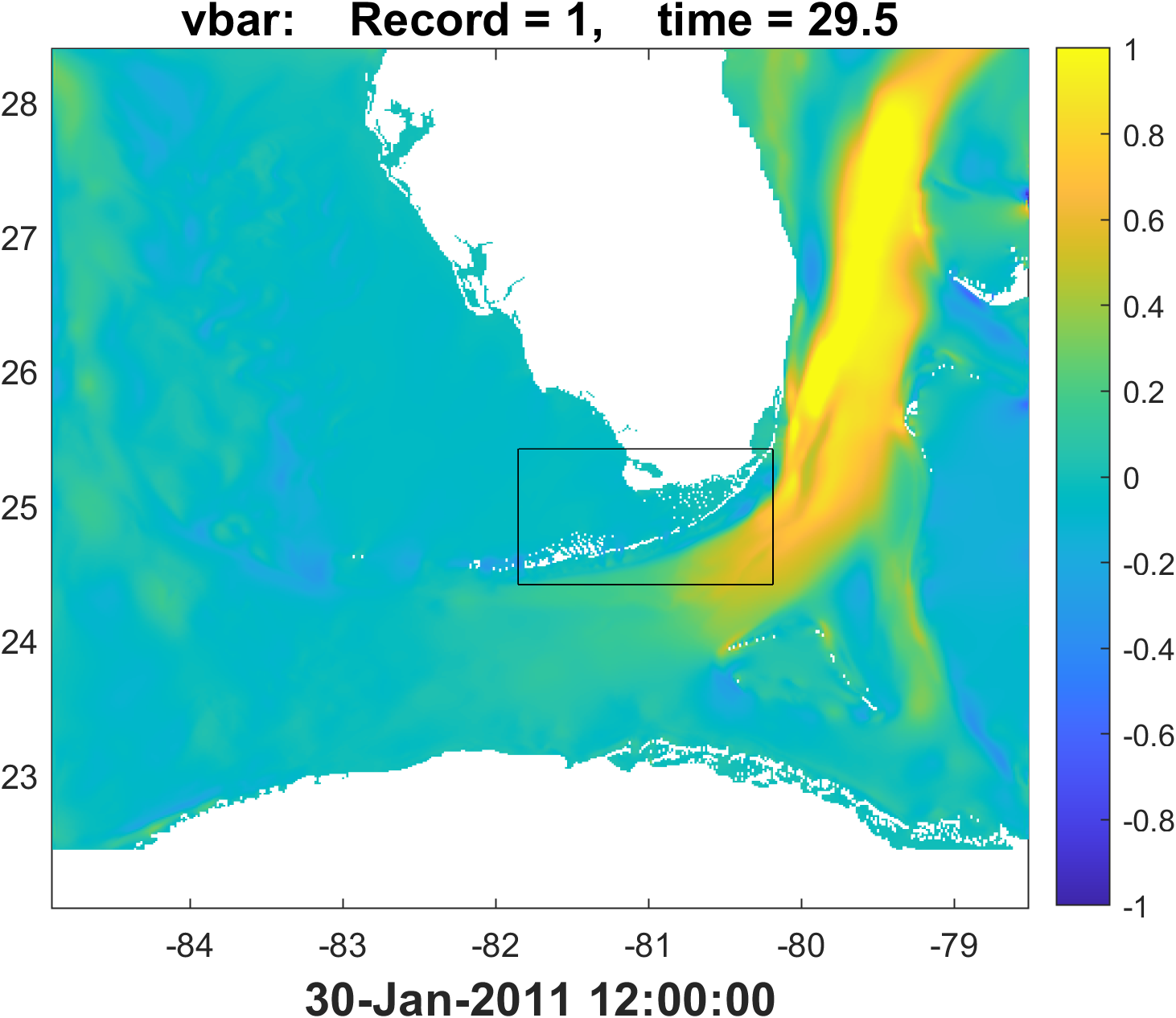

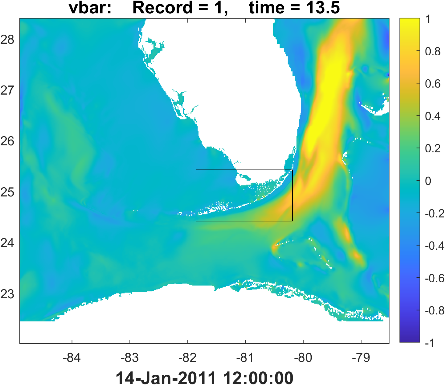

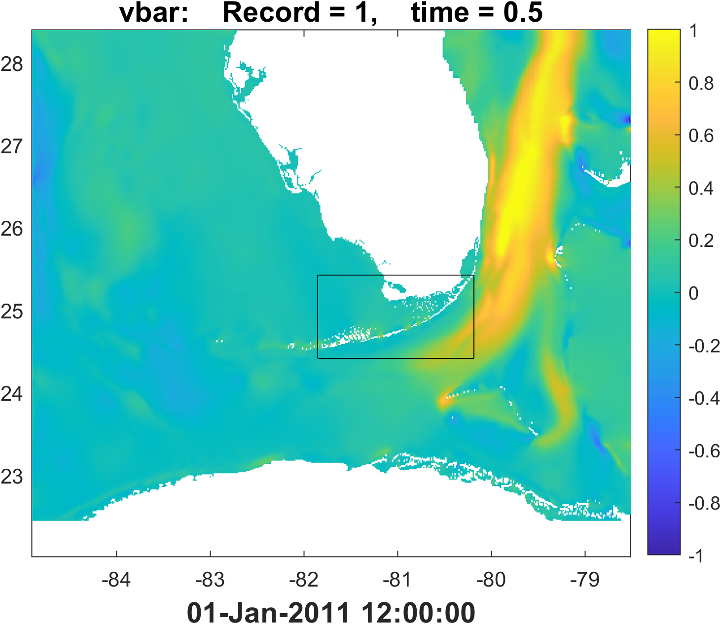

It's weird that ubar and vbar calculations are correct for one-way nesting, the vbar plots are attached below:
day 1:
day 14:
day 30:
Could anyone provide me with any ideas what might be causing this? Thanks in advance.

Yes, this makes a lot of sense to me. In such an active region, the nesting should always be two-way! The issue is that the finer, high-resolution nested grid resolves the smaller-scale processes, and there is no feedback from fine-to-coarse, so the two coarser and finer grid solutions are diverging. The coarse grid imposes boundary fluxes that don't have the memory of the finer grid solution.

I am a ROMS beginner but have experience with other models and I agree about needing two-way coupling with such a grid. I think the main problem is the corner of the one-way model in the Gulf Stream. Keep in mind the subgrid (child) has only the information given to it in the BCs and responds the the large water level gradient with its own internal dynamics, likely spreading erroneously high waters into the subgrid.
If you wanted to have a one-way coupled model, it would need to be angled or otherwise altered to never include the Gulf Stream. But I expect it is always better tonuse two-way coupled model.

1. I understand that for the one-way nesting, the two models (coarse and fine) will diverge. Shouldn't the divergence start inside the domain because of different masking, refined resolution, etc? I don't understand why my model starts to diverge on the boundary (as philip said, bot right GS corner behaved the worst) since we are using interpolations from the parent for the contact points. Maybe I misunderstood how nesting work, is the parent imposing fluxes on the child, and the fluxes are calculated only based on the parent without the consideration of the child boundary points?
2. Why ubar and vbar behaved a lot better than zeta for my one-way nesting model?

Is the bathymetry continuous at the nest perimeter? If not, it's not possible to match velocity ubar,vbar with transport ubar*h,vbar*h and volume will not be conserved. Two-way nesting compensates for this by establishing a pressure gradient that will drive flow into the nest to rebalance the sea level.

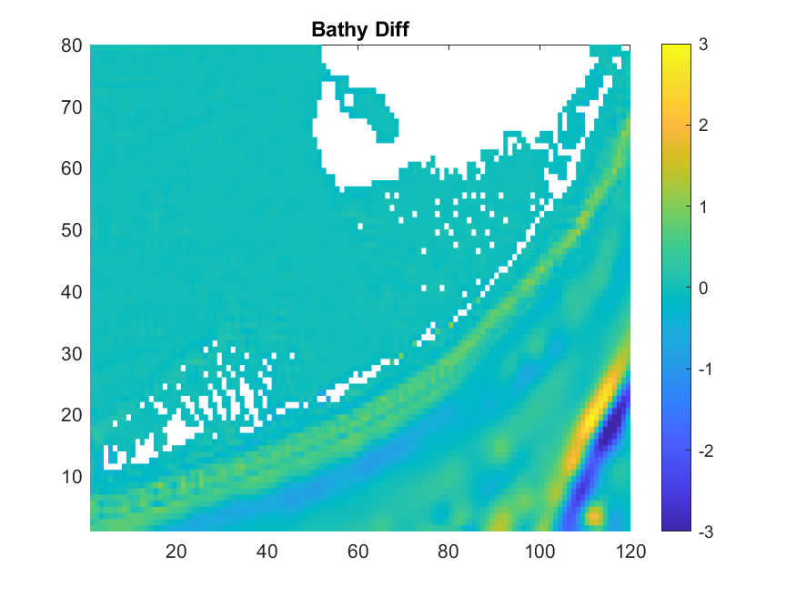

Thanks John. I think that is the problem, the volume is not conserved on the bot right boundary. I averaged h for the child grid file, and subtracted the parent h on the child domain. The plot shows the differences
I will fix the bathymetry and see if one-way nesting works.
