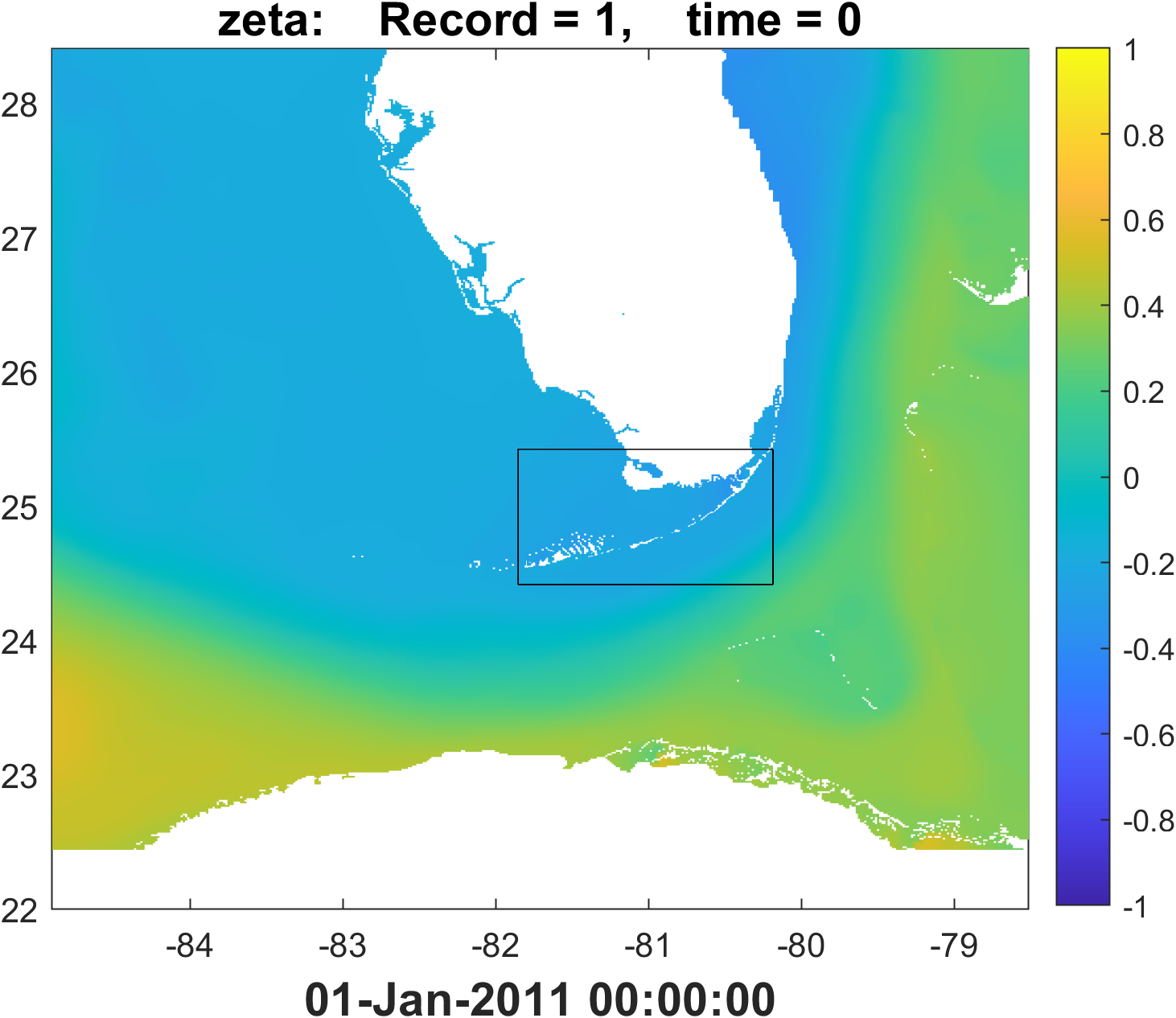

Initial condition for Zeta:

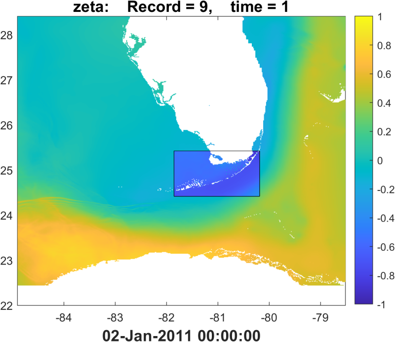

After 1 day:

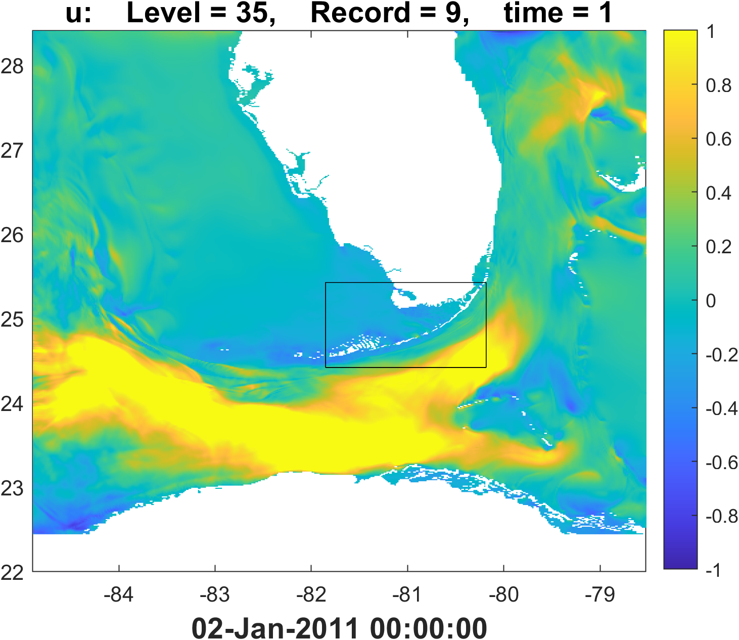

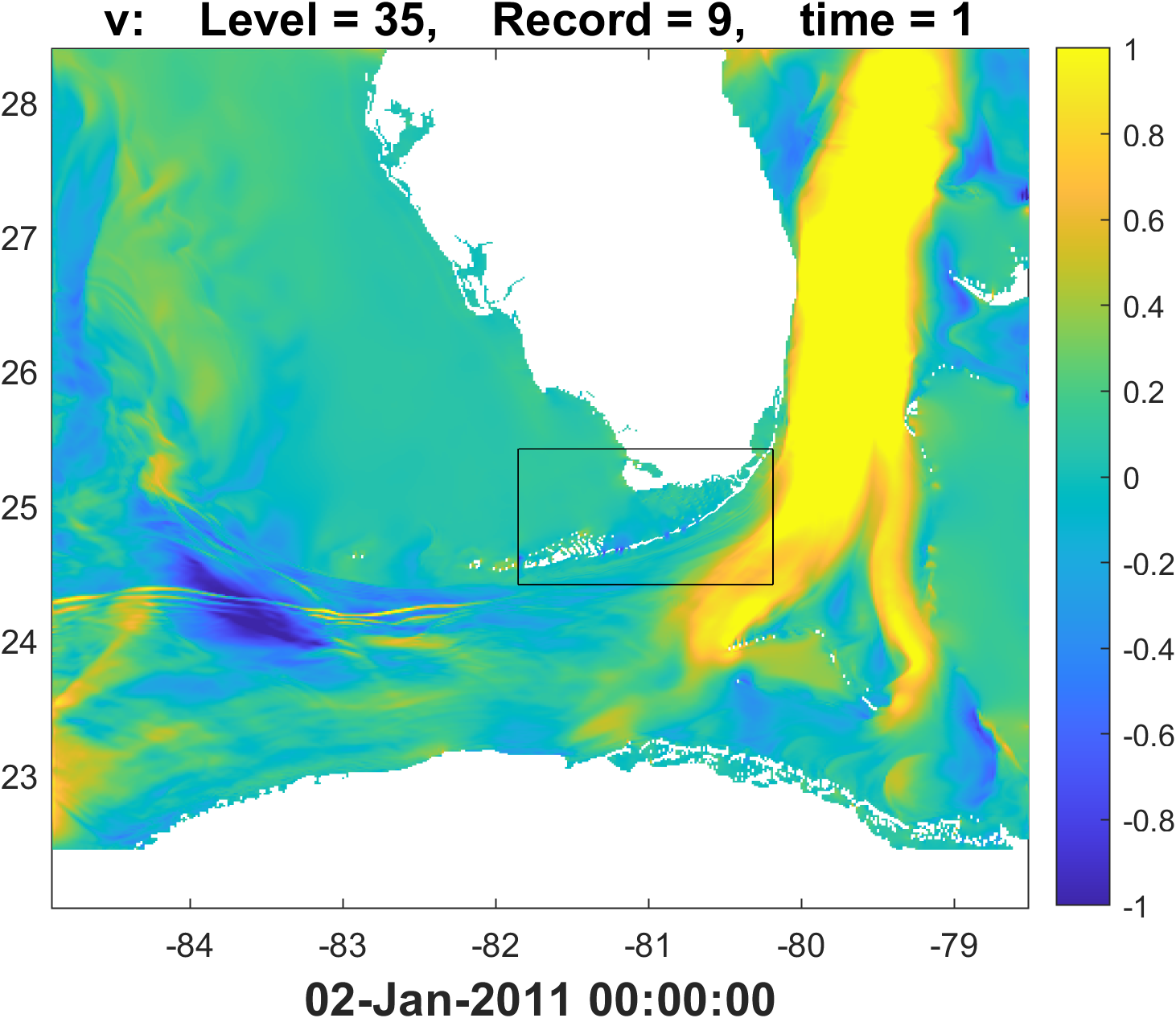

u and v behaved OKish:

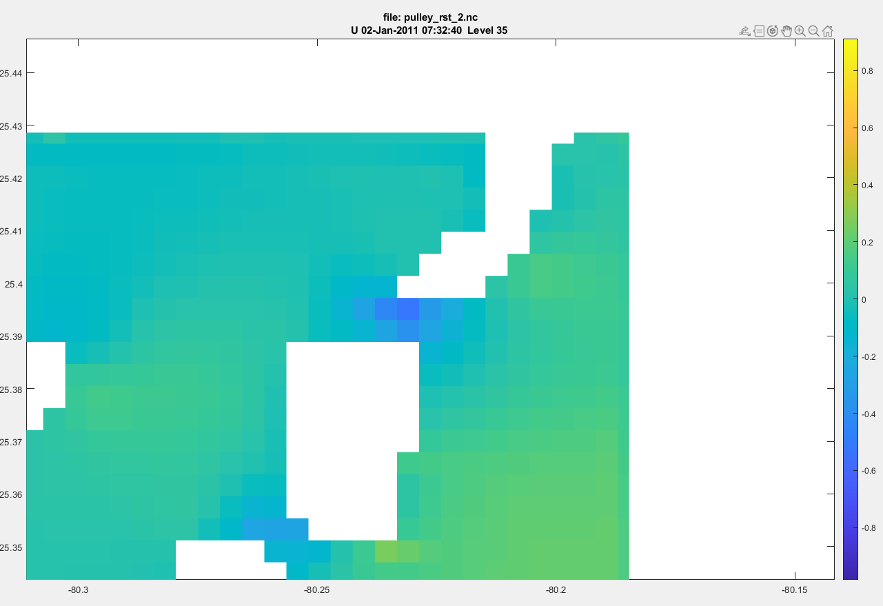

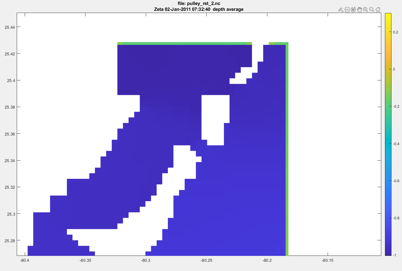

When I plot the graph for zeta using rst file for the refined domain, there is a clear jump at the boundary. The graph shows the top right corner of the child domain:
The discontinuity also happens for salt, temp, u and v but to a less extent.

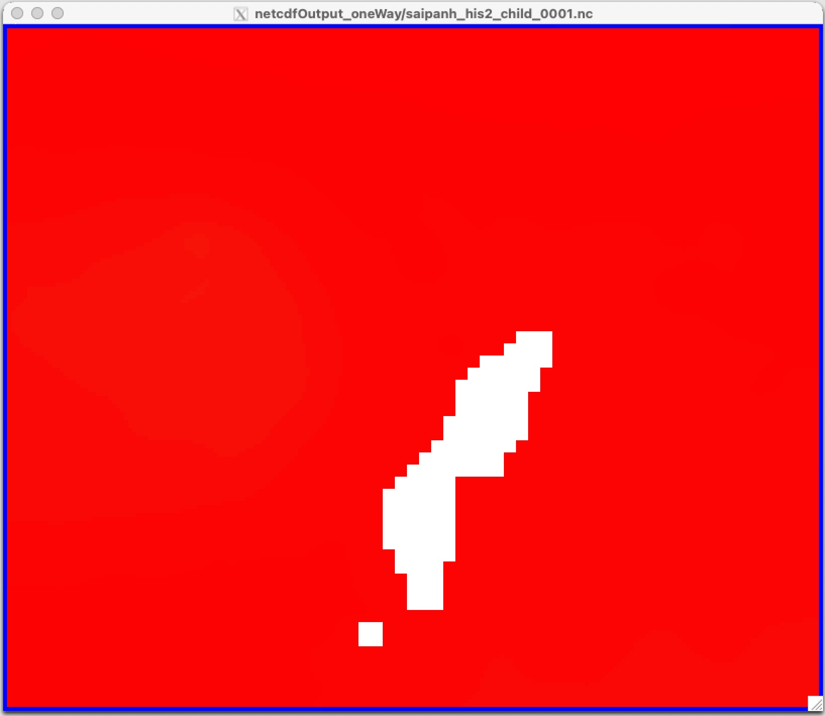

I am getting exactly the same zeta problem with ROMS v4.3. I have set up an experiment with no surface forcing and no tidal forcing for simplicity. The ROMS input consists of an IC file and a BC file for the edges. ROMS works exactly as expected when I run a two-way nesting experiment, which has this in the log file:

The problem shows up when I define the ONE_WAY flag on compile, which is the only thing that is changed. The zeta numbers in the interior of the child grid march off into the dingweeds but if you look at zeta late in the experiment you see that the very edge of the child grid sits exactly where it's supposed to sit. The enclosed graphic shows zeta on the child grid at the end of the experiment. The edges are all close to 1m, which matches the parent grid, but the interior has climbed up to around 4m everywhere after 5 model days which is completely unrealistic.
Again, two-way nesting works just fine so I doubt there is a problem with the ROMS input data. As for one-way nesting, it's as if ROMS sees the forcing on the edges of the child grid that comes from zeta on the parent grid but chooses to ignore it. I really don't see how ROMS can properly force the child grid as a two-way nesting experiment but completely fail as a simpler one-way nesting experiment. If there is a problem with my compile flags then it is too subtle for me to pick up.
