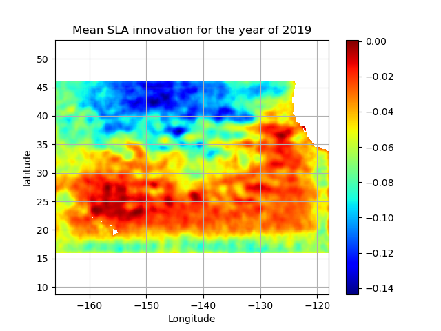

This is working well. After 8 years of integration the results are looking good and the model is stable. However, the long-term mean of SSH shows higher values near the open boundaries, and smaller values in the middle of the domain. This is causing a negative impact in the DATA Assimilation.
When I run ROMS with ENOI, the results show higher errors near the open boundaries (see the figure).
I suspect that I need to correct the HYCOM SSH, so it will have the same MSL as the satellite along-track SLA that I am assimilating, before I impose hycom SSH in the boundaries.

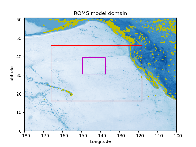

I am new in ROMS and Data assimilation, so I am sorry for I couldn't solve your problems. Besides, I'd like to ask you some question on your result. As shown in npo_roms_grids_new.png, what did 2 rectangle mean? Do they relate to Nested Grids? How could you realize nested grids in OI. If it comes to your privacy on work, I am very very sorry.

Yes, the boxes are the model domains, and yes, the smaller domain is nested on the the larger domain. The Data Assimilation is working only in the larger domain. If you have any questions please feel free to contact me directly in my email ivan@atlantech.com.br
