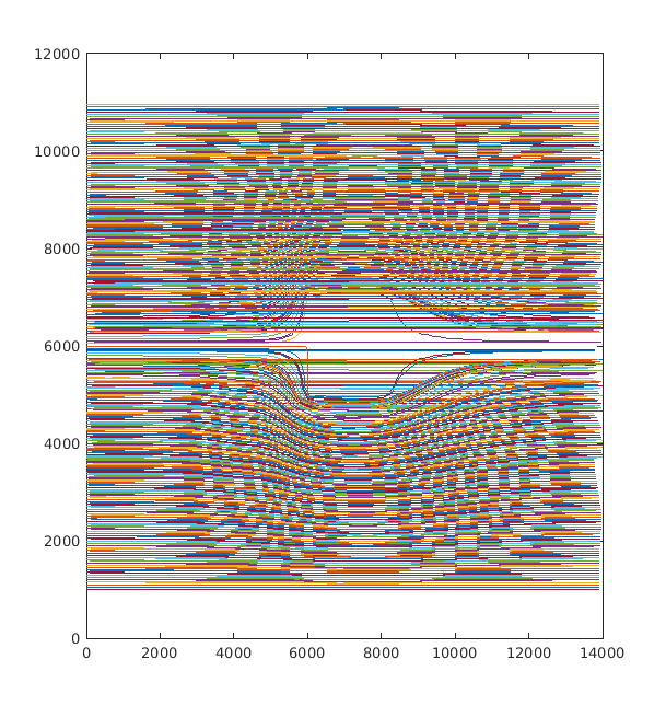

It is a little confusing - without FLOATS defined the run also produces roms_flt.nc output at the end. I wonder if this is something done for the 4.0 version ROMS?
Below is an attempt to plot the float trajectories...

ROMS will not generate the floats NetCDF file without activating the FLOATS option. You MUST have activated it. Check the ROMS standard output and look at the report of the activated options. There is a test for the 2D and 3D Lagrangian floats in the test repository. We even provide the plt_floats.m as a guideline on how to plot them. I haven't run that test in a long time, but you need to animate in time the location of the float trajectory. Your figure doesn't make sense.
I don't know what you mean about the seed. Randon number generation? If so, the random numbers are generated internally if you activate FLOAT_VWALK.

Where did you get your source code?
My up-to-date checkout from myroms.org has flt_test.h at revision 1099, and the #define FLOATS is definitely there.
